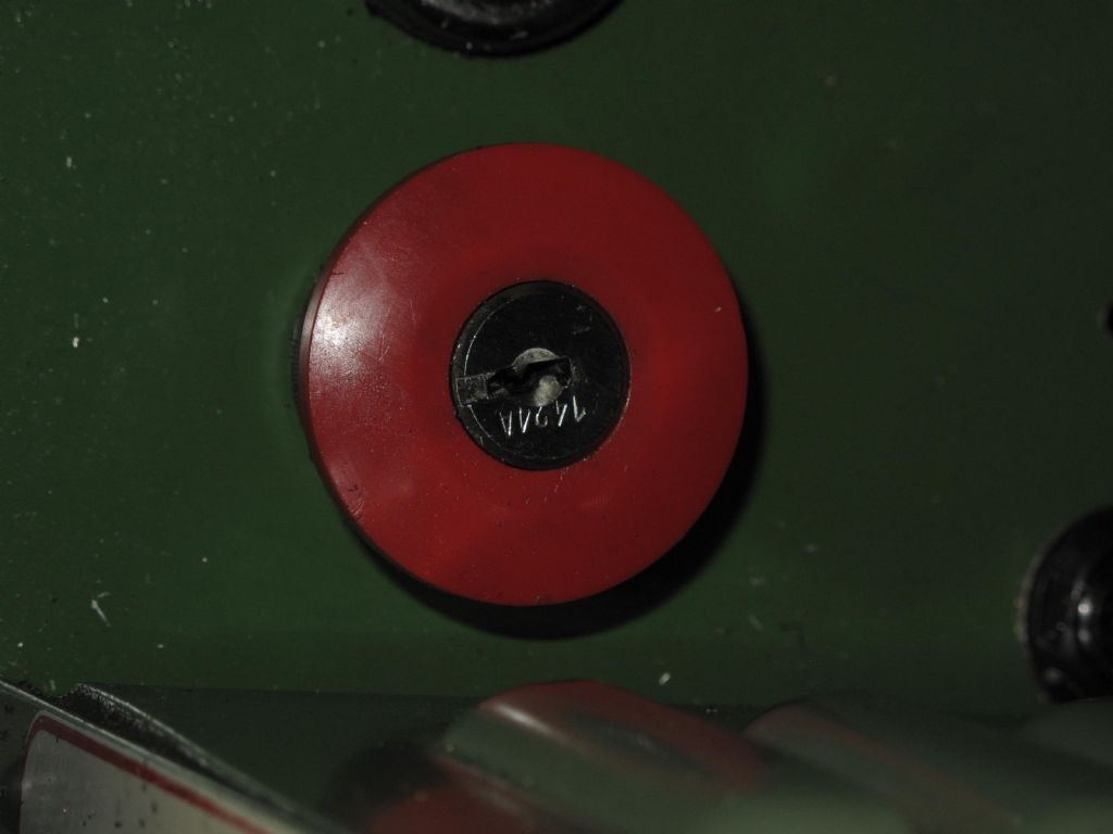

      I was using the lathe and accidently hit the emergency stop button.
      No problem you say just twist to reset, however this is an old school lockable mushroom and I have mislayed the key!!!!
      Are there any budding locksmiths or reformed characters who know how to pick this type of lock?

          The number engraved thereupon should enable any half-way decent ‘locksmith’ to supply a key:
          Something like this, I suspect: **LINK**
          http://www.pac-supply.com/Entrelec-1424A-replacement-keys-_p_2460.html

            Just to get you going you could link out the button or if it is a modular type then removing the switch block from the actuator should restore the circuit. Keys for estops are usually a standard number for each manufacturer but can Often be supplied with a customer specified key. As Michael says the number on the lock should get you a new key either from a locksmith or online. If you don’t need a key reset then consider replacing the actuator with a non locking version, latching with twist release or non latching are usually available.

                    they can be picked by applying a gentle constant undo turning force to the cylinder with the blade of a small screwdriver. The blade doesn't enter the lock, it engages just enough to maintain turning pressure on the cylinder. Then a needle is used to joggle the first pin until its gap (purple and tan in the picture) aligns with the cylinder and lets it turn enough nip the pin in the unlocked position. Then do the next pin in the same way.
                    Although simple the technique takes a certain amount of practice and patience. Not too difficult on a cheaply made lock with only 4 or 5 pins, much harder to pick a Yale door lock or an expensive padlock. As the lock on an emergency stop button will be cheap and basic, there's a good chance it can be picked.
                    Professional locksmiths have a tool for undoing tumbler locks. Works in the same way except the pins are vibrated mechanically, effectively deskilling the job. No idea how successful they are; my guess is they work well on cheap locks, and struggle with well-made ones. Worth trying before breaking the lock.
                    Can you approach the problem from the other side? Although the switch has a lock on it, it's unlikely the box has! May be possible to open the box from the back and take the switch off, in the worst case replacing it with a modern one.

                      I would go for the remove the complete stop button assembly and replace with a functioning one which could be used with no fear of not being able to restart as in this case. This is assuming you can get to it easily.

                        If the switch is a Klockner Mueller/Telemecanique it could be key serial number SF101, double sided commonly available at most locksmiths/key cutting shops.

                              Unless you want the lock out facility,I would be inclined to remove the complete switch, dismantle it and find a means of disabling the pin tumbler lock. Remove the linkage / actuating pin?
                              If you can get it apart, just remove the cylinder, or even the pins from the cylinder, so that it can be turned with a screwdriver.
                              If all else fails, remove this lock and replace with a more modern "twist to unlock" type

                                    Panic over I located a spare key, I might try some of the lock pick options just for fun in case I mislay the key again.
                                    The wiring to the switch is consealed by another panel in the lathe cupboard, so I think I will leave replacing it for now.
