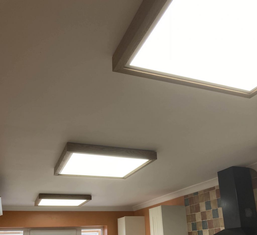

"So, as I stated, Fluorescent tubes and LED lights produce pretty much the same amount of light per wat."
Not sure where you get that from. Flourescents are around 50 to 100 lumens per watt and LEDs come in at 130 lumens per watt. Thats before you consider the directionality. Flourescent tubes are omnidirectional and LED's in general are 110 degree giving a gain of approximately 3.3. So when you take that into consideration the figure for LEDs rises to 429 lumens per watt so roughly 4 time the light output for the same power consumption.
Also not sure where you get your £600 for the panels from unless you are replacing every fitting? They are available for under £20 each. Here is my kitchen with 3 (in home made housings). Pleanty of light for my kitchen. I would put more in a workshop and be intelligent with the placing.
regards Martin
