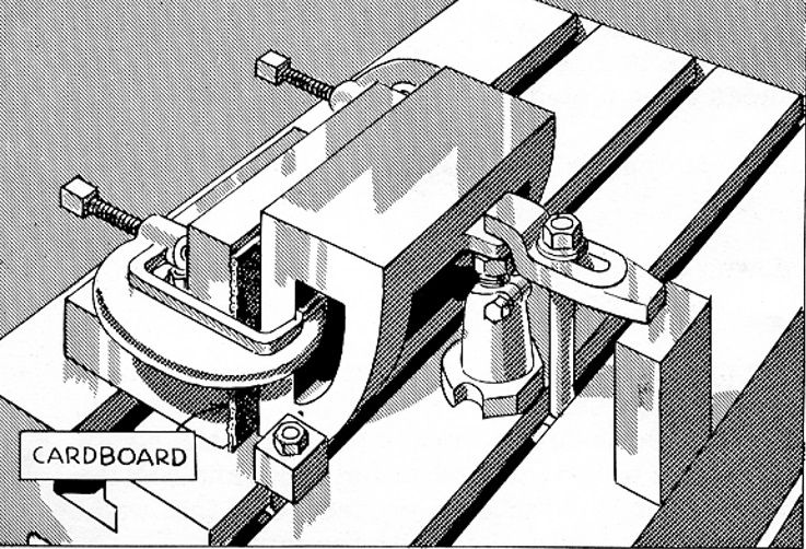

                    IanT
                      @iant
                      Posted by Andrew Tinsley on 03/08/2017 18:55:30:
                      I have read one or two old books about shaping, in order to get some background information. In two of these old books, it is recommended that you get the shaper level. This is in order to make setting up the work in the machine vice an easy task.
                      Yes, certainly true of lathes Neil – but (as Andrew states) the reason given for levelling shapers was nothing to do with machine distortion but the ability to set work up easily. The shaper is used to create plane surfaces and where large work pieces had to be attached to the table, the clamping and jacking work involved could be complex. The ability to use a level to adjust heavy/large work being clamped & supported would have been very useful.
                      Most of my work is just held in the shapers vice (referencing from the bottom of the vice) but not all set-ups are that simple and I'm not machining really large surfaces as would often have been the case in days of old….
