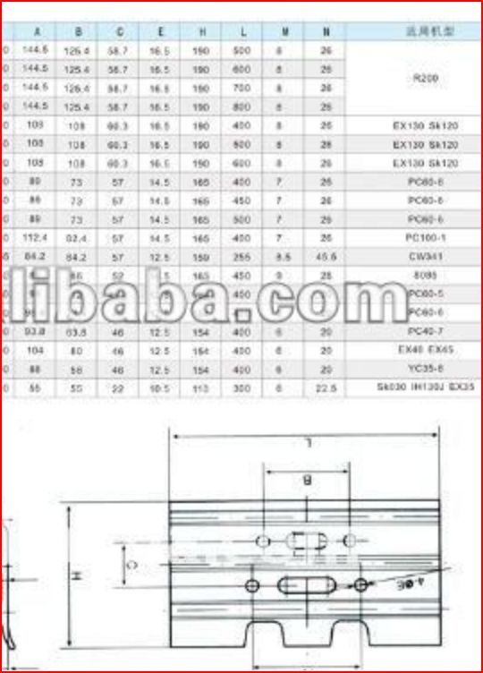

                David Jupp
                  @davidjupp51506
                  I had a quick look around – this document from a track pad manufacturer has some detail about profile and dimension which might be useful **LINK**
                  The profiles probably are not 'spot on', but are more for identification.
                  As others have mentioned, this would not be difficult to model in 3D – once you have got used to the software.
                  BTW – further to point raised earlier the Geomagic 30 day trial does do export of a wide range of 3D formats, and 2D – unlike some trial software export, printing, saving are all fully functional with. So you could have a go at modelling this using the trial, then save in formats that CAM might accept.

                    #133851
                      I did snip this yesterday has all teh dimensions, whats the full size of yours and I may have time later to draw it.
                      In the long run it will be better for you to draw the item as you can think through the machining process at the same time and not end up with a drawing of something that you can't make. It will also be easier if you want to make alterations.

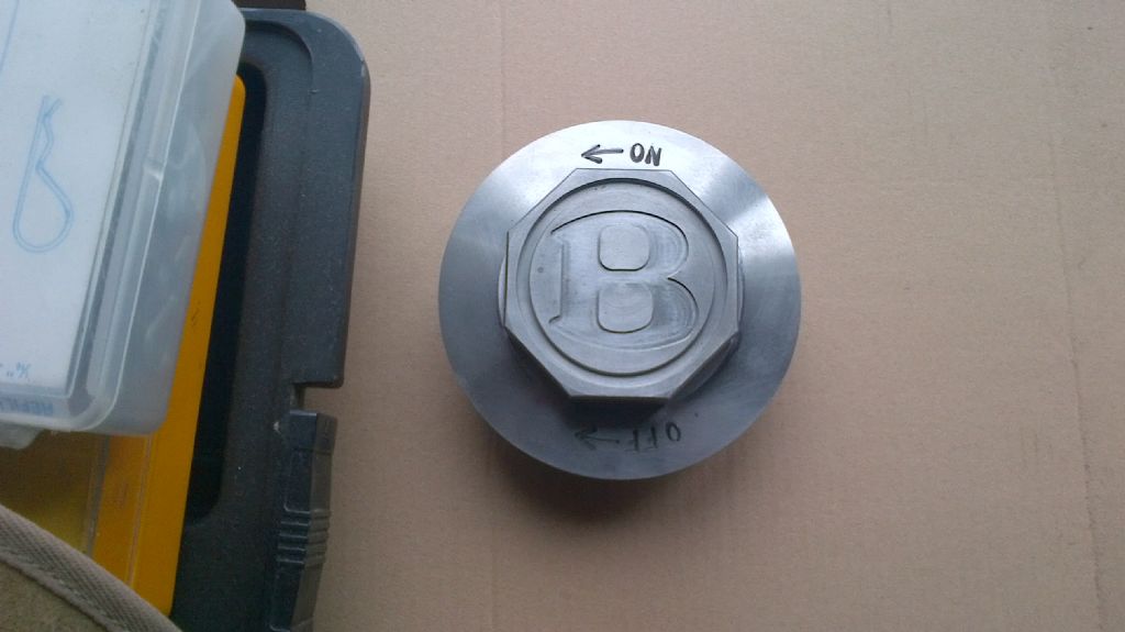

                              #133856
                              John Stevenson 1
                                @johnstevenson1
                                Something like this though and you can't just plug in numbers.
                                Not only is the domed surface 3D milled but the engraved text follows the curve so it's a constant depth.
