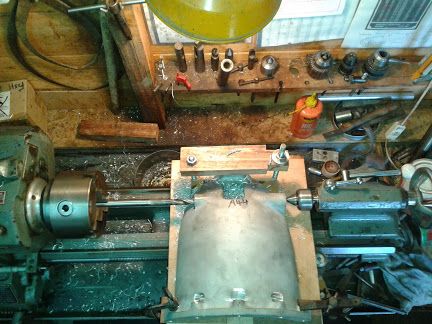

                          Here is one I did earlier. As you can see, the cross slide of the Boxford has been enlarged using a sheet of plywood bolted and temporarily glued to it to stop it moving about. in the photo, i was drilling a hole through the aluminium casting prior to line boring between centres./the job was far a full sized Bugatti type 32 clutch housing

                                I use a method seen in MEW issue 168 page 56 by Ted Barclay in
                                which an amalgamation of a between centres boring bar and boring
                                head produces a very accurate result .
                                You can just see the Dore boring head revolving the boring bar articulates
                                when the cut is applied as the toolbit is halfway between the boring head
                                and the tailstock the graduations on the boring head dial are halved.
                                The deflection of the boring bar should not be much of problem ,when
                                boring like this on the crosslide you should ensure that the fixing of the
                                work to the crosslide is rigid enough and the clearance between the
                                saddle and the lathe bed is minimal.As can be seen in the photo the
                                work piece here forms a bridge between between the two supporting
                                parts ,the crosslide is locked during cutting.The clock gauge is left in place
                                during cutting to detect any movement.
