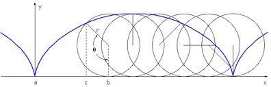

                                      Thanks for the kind comment. sorry about the length of this posting but you did ask wink 2.
                                      Cycloidal and involute are two types of geometric curve. A gear tooth in profile can have part of one or other of these shapes. Gears in mesh should have the same profile to prevent wear..
                                      Imagine a bicycle wheel, the tyre valve at the bottom. When you roll the wheel along until the valve is at the bottom again. The curve that the valve makes is a 'cycloid'. If you roll the wheel around a circle it is an epicycloid, roll it inside a circle and it is a hypocycloid. clock gears are usually epi- and hypocycloids using a bit of the curve as the profile:
                                      Cycloid
                                      Epicycloid
                                      Hypocycloid
                                      Cycloidal gears – note the use of a bit of a cycloidal curve for the profile

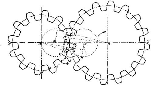

                                      To make an involute tie a pencil to the end of a thread on a fixed cotton reel then draw a line keeping the thread taut and as it unwinds you will draw an involute. Involute gears are the usual profile for power gears.
                                      Involute
                                      Involute gears using a bit of the curve for the profile of the tooth
                                      These gear profiles are used because the surfaces roll together rather than slide over each other so wear is minimized.
                                      Hope that helps a bit.
