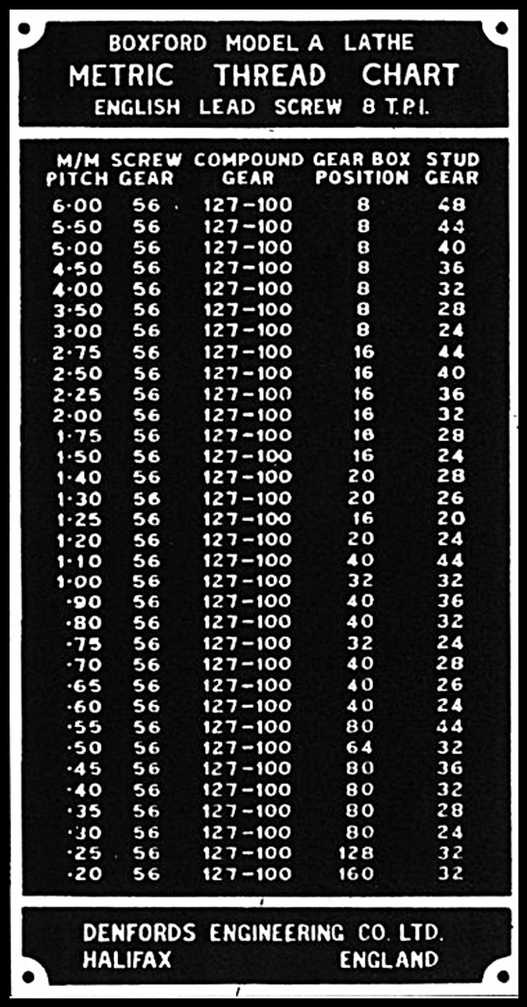

          Hi, Are you sure that isnt 100/127 , this is the compound changewheel that allows a good number of metric threads to be cut on an imperial lathe. They are quite expensive to buy for a boxford / southbend / logan lathe.

            Here is the cart for cutting metric threads with the 100/127 compound gear

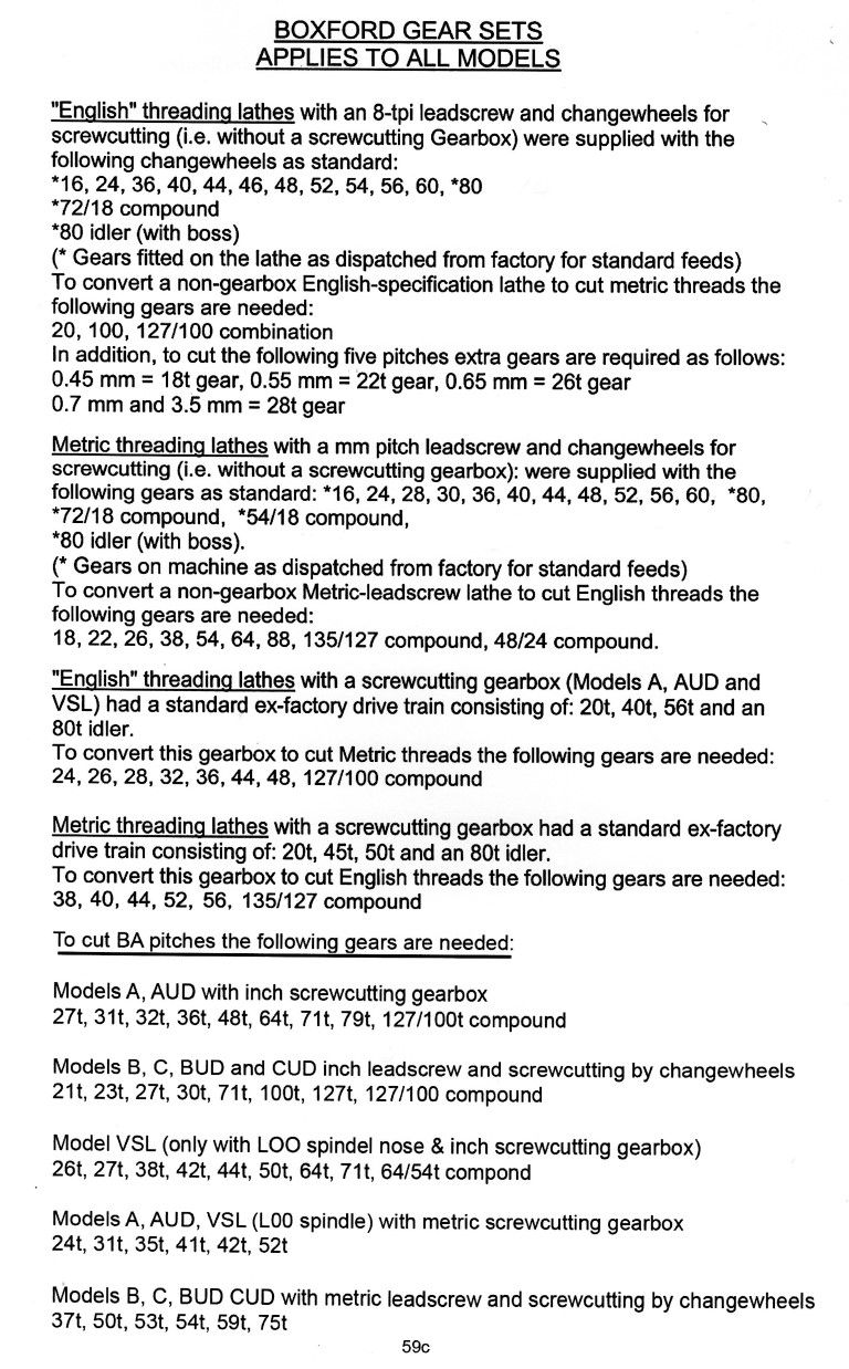

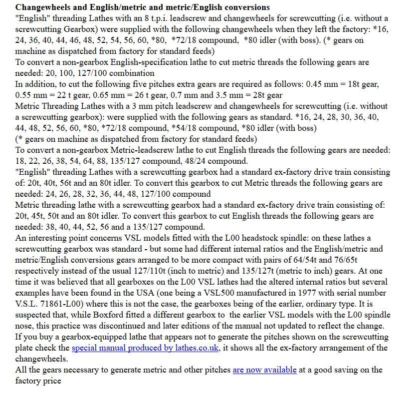

                All the info is here which is from the lathes.co.uk website.

                  @robbo
                  This page from a full copy of "Know Your Lathe" shows the various standard changewheel sets supplied with various machines.
                  Thought the whole thing might be a useful "takeaway" for readers.
                  Your model B will be the first set.

                      Posted by Saxalby on 18/01/2017 17:49:59:
                      That's interesting. I've heard comments in the past that the smallest gear that will mesh with the 100T is 40T so the 56 must mesh with that and the small ones with the 127. Actual 40T may be too small. So if the above chart works it should show the compound as 100 – 127.
                      Thanks. I've just checked one of the values. It does work. 56 stops on the leadscrew gear driiven by the 100 and the other drives the 127. So changing one gear can produce all metric pitches even the ones that are out of the ISO spec.
                      It doesn't work out so nicely with the 100/127 the other way round. blush Silly me who knows it's best to check anything picked up from the web. laugh

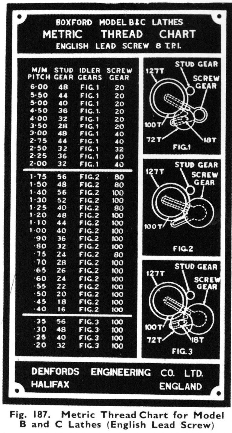

                        The charts given above are for a gearbox type ie model A. Does anyone have it for a model B? I checked my book and it doesn't but I also don't see a lest of the gears supplied as shown above so there must be other versions of the book.

                          Is this the one you mean?

                            Thanks Robbo. My book has a fig 187 for 3mm leadscrew. Book version is "tenth impression 1981"
