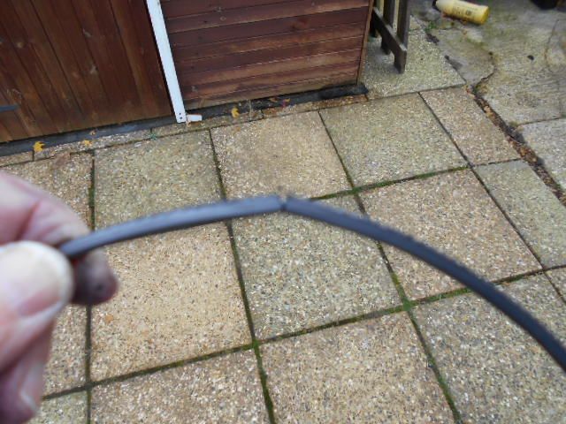

                                  #437925
                                  BOB BLACKSHAW 1
                                    @bobblackshaw1
                                    Old thread but still splitting the belt.
                                    I have put a three phase on the machine two years ago and in that time I have gone through three belts, so its not the sudden start off of the motor.
                                    When changing the belt I push off the belt on to the other pully and its quite tight so its not loose. I don't use the tensioner at all as all the pully positions are a good belt tension.
                                    The pulleys are all lined up, as I used a straight edge when setting up the three phase.
                                    The only problem I see is changing to another pully, its pushing the belt over the pully wheel which could be damaging the belt over a period of time. If I left the belt on one pully I'm
                                    sure it would last.
                                    The belt turns over on its self on the pully, and that's when it cracks up .
                                    Any suggestions please, as I've gone trough a number of belts since I had the lathe.
                                    Thanks Bob

                                      #437935
                                      BOB BLACKSHAW 1
                                        @bobblackshaw1
                                        dscn1145.jpgThanks Michael,
                                        Ive looked at the photos and its non of those, mine has a complete split.
                                        The photo is rubbish , cant get close for a good photo.
                                        #437938
                                        Dave Halford
                                          @davehalford22513
                                          Bob,
                                          Have you tried searching for vee belt rolling on google?
                                          Your pushing the belt off under tension might be damaging that tiny belt an A section would not allow changing pulley under proper tension..
                                          Pulleys might have been made to Chinese guide lines and may not have the correct angle for that belt, or the belt may be bottoming.

                                            #437947
                                            peak4
                                              @peak4
                                              Posted by BOB BLACKSHAW on 19/11/2019 10:01:01:
                                              The only problem I see is changing to another pully, its pushing the belt over the pully wheel which could be damaging the belt over a period of time. If I left the belt on one pully I'm sure it would last.
                                              Thanks Bob
                                              Bob, I might be missing the blindingly obvious, since I've never used one of these lathes; surely the whole purpose of the belt tensioner is to release the tension, in order to change speeds.
                                              Isn't it a spring loaded idler?
                                              See Page 20 of this pdf.
                                              Apologies if I'm sucking eggs up the wrong tree, or something like that.
                                              Bill
                                              #437994
                                              BOB BLACKSHAW 1
                                                @bobblackshaw1
                                                To answer Bill`s question, when I got the 9×20 lathe the belt was tight on 3 off the pullies so when changing over to another pully it was a thumb push to get the belt off. The tensioner in my opinion gave even more strain on the belt and I didn't use it until the belt came looser or changing to the other three pullies which didn't have the tension and the tensioner was needed. Now its on a inverter only three pullies are used and they are tight on all three so the tensioner is not used.
                                                If I remember a Myford lathe the tensioner was used to slacken the belt to change pullies, the 9×20 as I've said the belt is tight even when the tensioner is off.
                                                The Gates belts are suppose to be the best and are used with cam shaft drives on cars, so changing over on other pullies must be damaging the belt. Is this a design fault? are there any other 9×20 users having this problem.
                                                Bob.
                                                #437995
                                                Ron Laden
                                                  @ronladen17547
                                                  Bob why are you not using the belt tensioner as Bill says that's what it is there for. I have the Warco 918 and the belt I use is 5M but the 730 not the 710 so is a little longer. Belt changing to a different pulley size is a doddle, push the tension lever back, belt becomes slack change belt position release the tension lever and that's it quick, easy with no stress to the belt.
                                                  #438001
                                                  Dave Halford
                                                    @davehalford22513
                                                    Hi bob,
                                                    There should be about 1/2" of slack if you press on the longest length with your thumb.
                                                    Sounds like the belt could be over tensioned
                                                    #438005
                                                    BOB BLACKSHAW 1
                                                      @bobblackshaw1
                                                      Actually I have just been thinking this, Ive always used a 710 belt as that was the belt supplied with the machine, so I will try a 730.
                                                      Thanks Bob.
