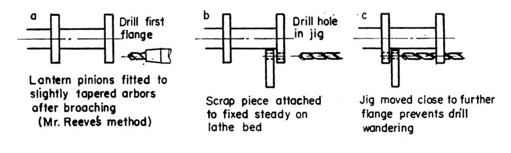

      I’m having difficulty drilling a lantern pinion. The 0.030” diameter drill does have a tendency to wander.
      Any thoughts on how to control it would be much appreciated.

              any chance given the style of lantern pinion you are trying to make to do all the drilling on two plates soldered together as a stack, then separate them and cut them to final round shape?
              I've used this method many times when trying to make plates or discs with identical hole locations. I usually drill an extra smaller dia hole to act as a reference for aligning the finished assy and get the holes assy'd in the same order they were drilled.
              For the drilling itself, I'm assuming you used a centredrill first, and are using good quality twist drills?

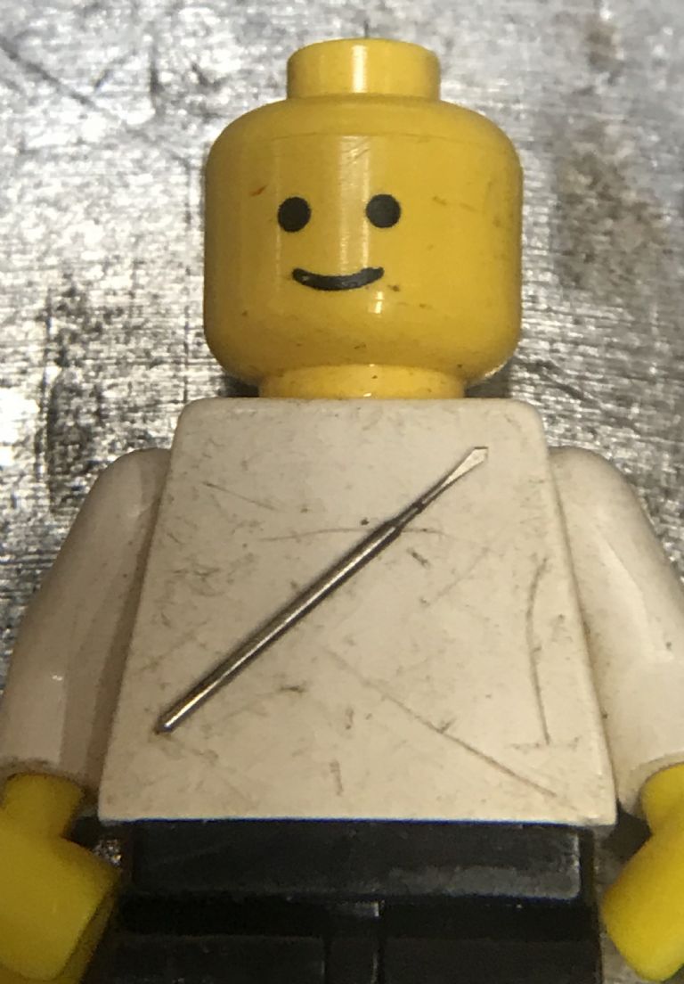

                          Dave S
                            @daves59043
                            Spade drill is the way to go for that sort of size.
                            If you can make them from carbide so much the better – it’s stiffer.
                            PCB drills are another option that works well
                            edit to add photo, Lego man for scale:
                            Edited By Dave S on 06/11/2021 18:13:29

                                                #570378
                                                Sam Stones
                                                  @samstones42903
                                                  David,
                                                  I used this method as nominated by Mr John Stevens in his skeleton-clock article. It was a breeze.

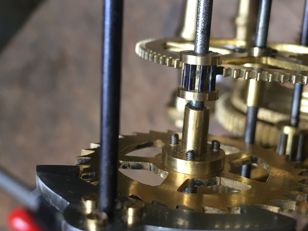

                                                    David Noble
                                                      @davidnoble71990
                                                      I've resurrected this post in order to say thank you for all the advice.Using quite a number of the suggestions that I received, I now have a working lantern pinion
                                                      Many Thanks, David
