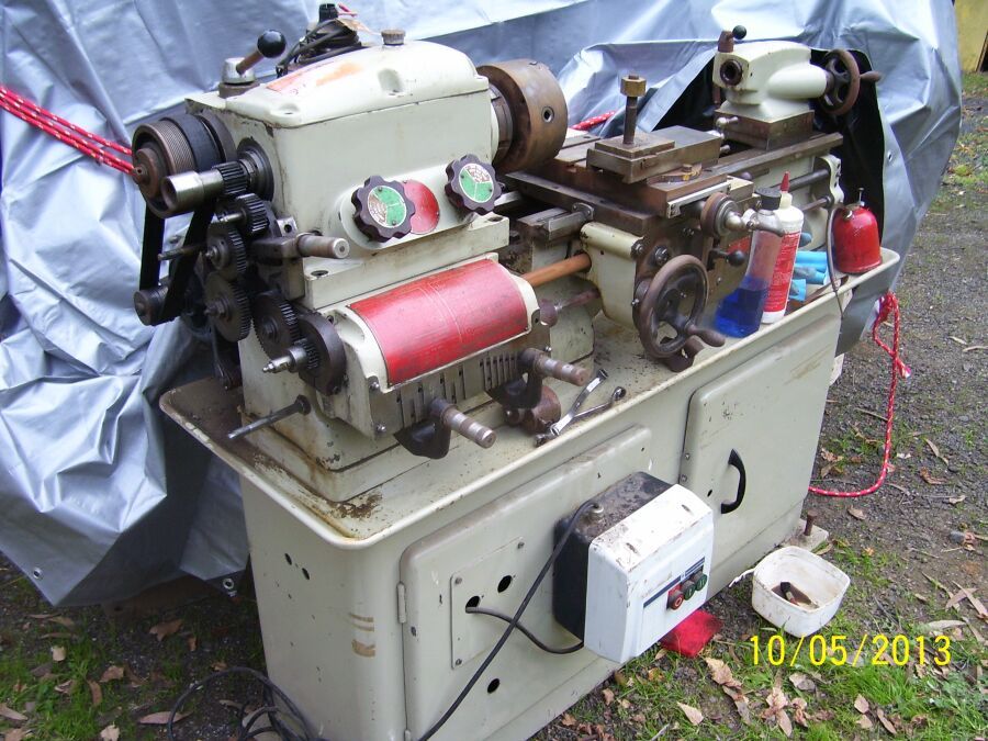

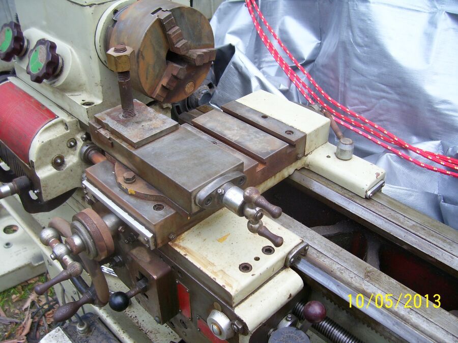

                                    Here she is ……………………………..been stored for many years, some rust here and there but nothing serious
                                    The drive belt from motor to headstock is strange , a flat ribbed affair .
                                    Edited By hth on 28/04/2016 09:25:12
                                    #236532
                                      Treat her well, and I think you should be very happy together.
                                      P.S. … The 'ribbed flat belt' may turn out to be a Poly-Vee which someone has used as a substitute … Have a look for any identification marks, and/or post a close-up photo, please.
                                      Edited By Michael Gilligan on 28/04/2016 10:36:52
                                      #236541
                                      Ajohnw
                                        @ajohnw51620
                                        It should be well worth the effort of cleaning it up. One of the few smaller lathes with a good sensible head stock bearing set up more less a la Schaublin, DSG, Lang etc.
                                        yes I want one but would guess that it would crush the kitchen cabinet my Boxford rests on.
                                        #236550
                                        hth
                                          @hth
                                          Posted by Michael Gilligan on 28/04/2016 10:17:20:
                                          Hi Michael
                                          The odd looking belt does have the basic appearance of a modern Poly belt, but it is made from a canvas rubberized material . I would say it is the original belt from the 1960's. The V groove spacing in the two Kerry pulley's is very narrow, unlike the poly pullies you see around today. Will take a pic tomorrow , its night time here right now – the time difference !  Cheers  Mike
                                          Edited By hth on 28/04/2016 12:19:22
