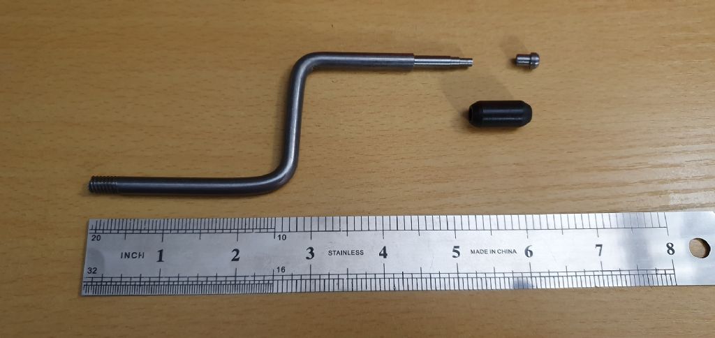

      These are the parts I made, together with the original parts they replaced. The machine ball was easiest, as I only had to tap it out, but until I make a rotary broach, the pivot pin will have to make do with a hex head.
      I couldn't work out how to spin rivet over the end of the trip lever to retain the delrin roller, so I made a separate cap and secured it with Loctite. I will probably remake this lever later as I gave it too much offset and it has to be installed at an angle to avoid hitting the belt guard when lifted.

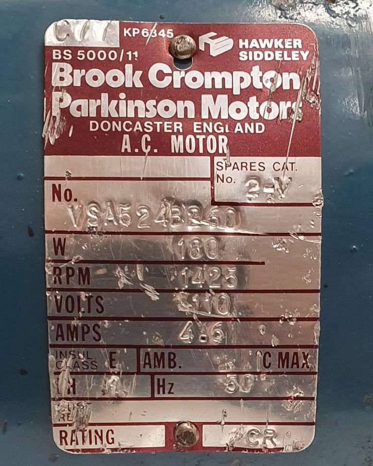

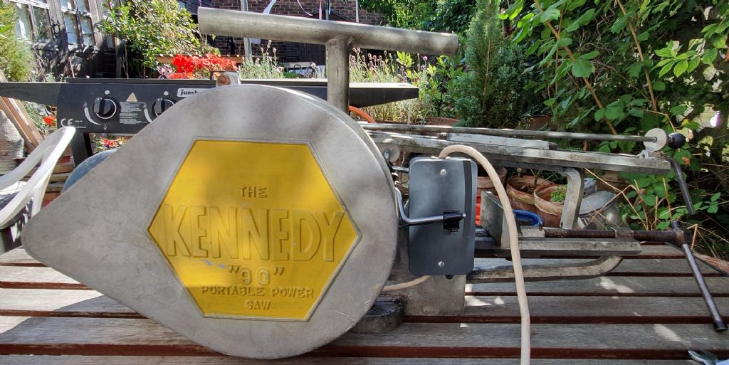

      Here are a few pictures of the complete machine with the parts fitted. The motor is a mid-1970s Brook Crompton Parkinson, not Hoover or Lemac, and I have only found one picture of another Hexacut with this make of motor, so I don't know if it is original.

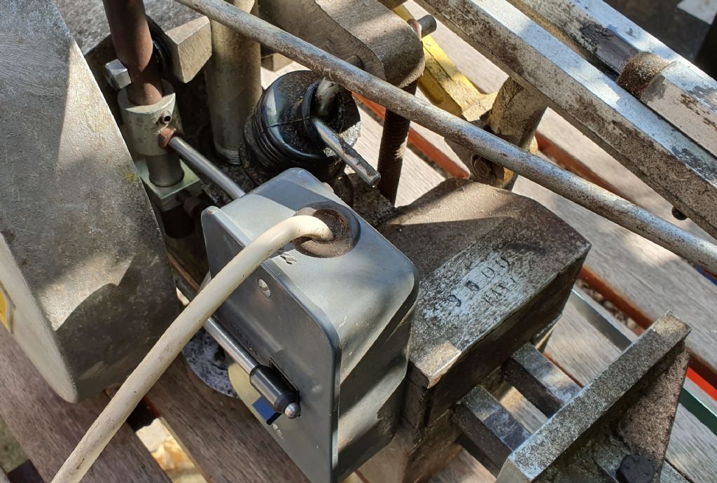

      One oddity of the design is that the MEM NVR switch (which makes it really hard to set the depth stop) is upside down in order to be operated by the trip lever.

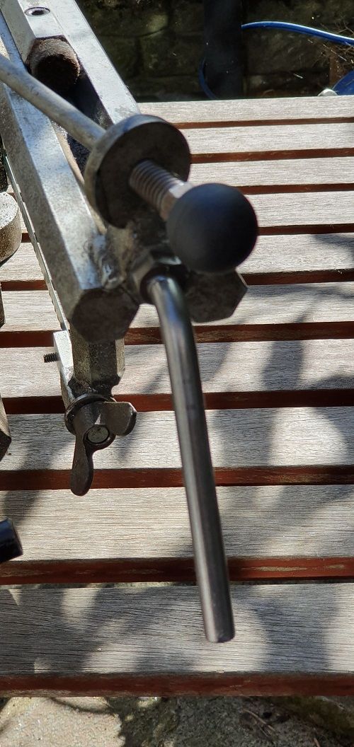

      I had to fit a Kennedy blade
