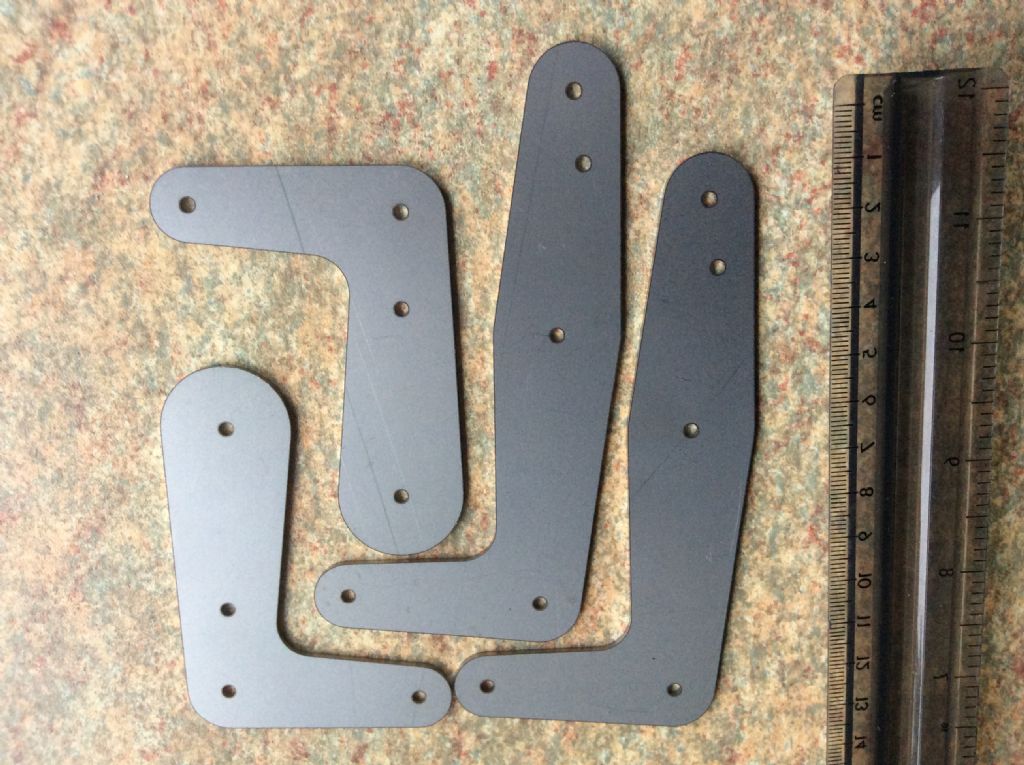

      e430f11d-6339-4317-9d25-f9a862b1c858.jpegI had my son laser cut my blanks and even then to make good clamps is a lot of work, you can see why they are so expensive to buy.546b90f5-6905-42dd-a05c-133eebb41652.jpeg

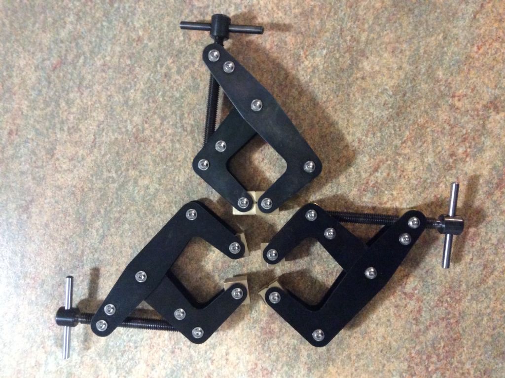

        Finished. I won’t be making any more unless I find I really need them and I can get the plates water jet cut!
        Mostly stainless with some brass and alloy. Using hex bar for the bosses proved to be a good call.
        #576629
          Very tidy, Vic yes

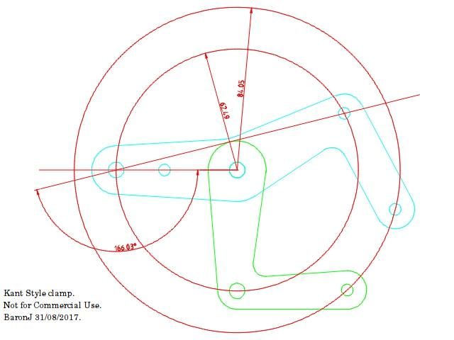

                John Baron kindly provided an excellent ‘template’ when he wrote:
                This picture contains all the data required to design what ever size Kant type clamp you may want to make.

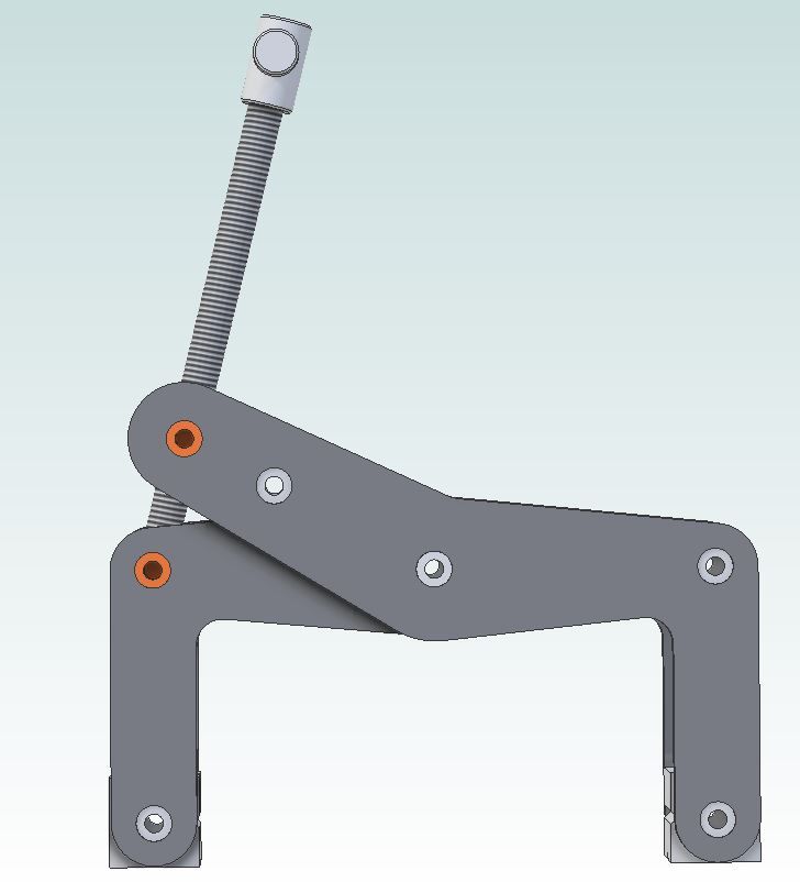

                          Quick model based on John's circles.
                          Edited By JasonB on 25/12/2021 11:11:22

                            Nice job Jason. I think I prefer Bernard’s design though as it looks likely to be more rigid. I only lost some of the angles on mine to make it easier to cut out.
                            If anyone can get the arms water or laser cut at a good price I’d be interested in a couple. Probably 2” or 3”.

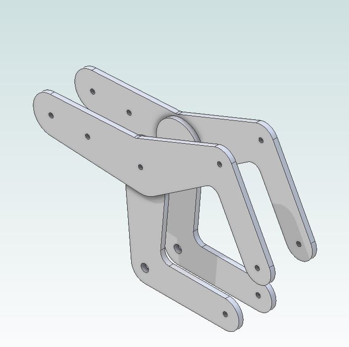

                                  Having had a bit of a play it seems that the angled larger plate allows the clamp to poen further than just a basic "L" shape would and the two legs can open until parallel like the drawing in Vics link that give sthe clamp sizes.
                                  Those reading the current CAD thread will have seen my mention of how useful it is to be able to animate parts once assembled, this is a good example as I was able to see that the screw thread needed to be made 10mm longer to allow the clamp to fully close and that the spacer nearest the nut needed to be moved outwards from teh pivot so the smaller arms would not hit it. Even the jaws faces stay parallel, screws left out for clarity. I just need to fine tune that quick release threadwink 2

                                                  Hi Guys,
                                                  The design details for the "Kant Style" clamp are here ! Using this information any size clamp can be produced simply by drawing two circles.
                                                  NOTE: that this this drawing is provided for personal use only. Not for any commercial use.
                                                  Copyright remains with me and MEM magazine.
