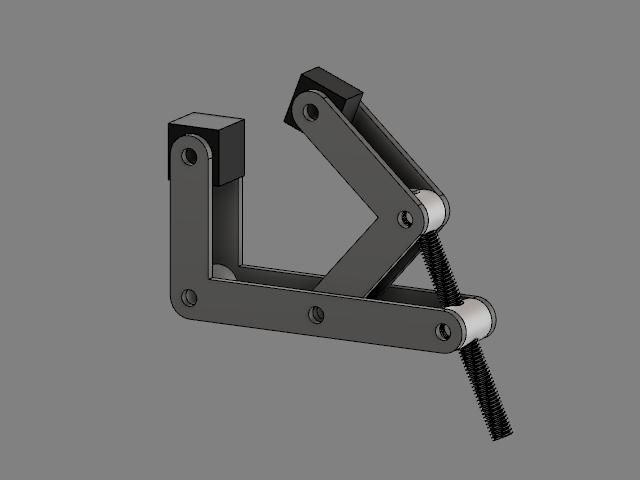

                              Here's my suggestion, to be cut from 3mm steel when I can afford the components for my chassis:
                              They're 50mm deep, M8 studding and they'll be held together with M5 screws. As you can never have enough clamps, I'll be ordering enough for at least 6.
                              The above pictures of twisted ones suggest I should add some more bolt through spacers.

                                It’s time for plan B. Not sure when I’ll be able to implement it but I’ve ordered some 2.5mm thick steel sheet. I have plenty of round stock for the turned components. I’m going for a roughly 2” clamp and the KT had a 1/4” screw so I’ll probably use M6 studding rather than turn down some larger rod and thread it. Any clever suggestions for securing the head for the cross bar? I’m thinking just to screw on a larger “boss” and cross drill it say 4mm?
                                I’ll be using the plan pictured above. When printed out on my laser at 95% it is virtually the same as a 2” KT which is perfect for my needs.
