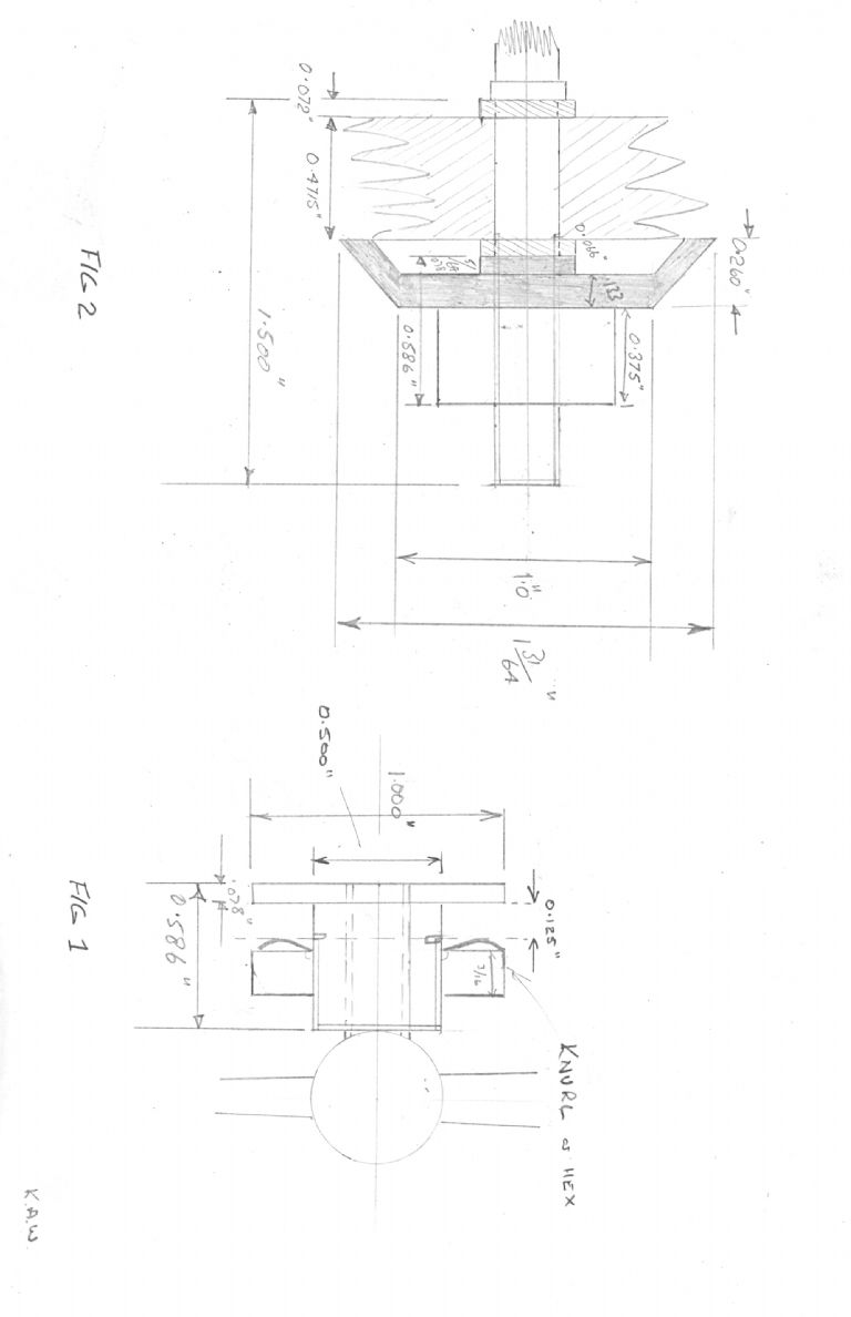

                      KWIL
                        @kwil
                        Shaun,
                        From my photo album (last entry) my design to modify the standard ML7 fixed dial to be able to reset them.
                        (60 year old design but works!)
                        K

                          Shaun Belcher
                            @shaunbelcher81617
                            Posted by KWIL on 15/11/2019 11:45:11:
                            Shaun,
                            To reduce/eliminate the oil fling, apart from reducing drip rate, place a suitable sized O ring on the mandrel end and touching the headstock, oil then only exits on the inside of the bearing.
                            K
                            OK, ill take a look at that when i disassemble it.
                            I think it was the drip rate that was most of the problem, but looks like some oil is still getting past.
                            Would a worn bearing be a cause of this problem?
                            Im still trying to work out how much if any wear there is on the bearings, will probably need a dial indicator to check this.
                            Thanks for that drawing, I never realised the stock dials were not resettable.
                            Im assuming someone may have made a similar mod to mine, but ill take a good look when i strip all this down.

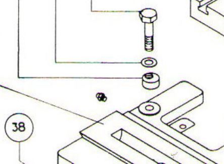

                                      One other question, is with the apron assembly, are you supposed to lock down the power feed lever to stop it moving when making cuts?
                                      I find the saddle will move across the bed if making an end cut with the top slide as I move the cutting tool into the stock. I found locking down the powerfeed lever would help, although i question whether or not it might need tightening up?
                                      #437774
                                      Pete Rimmer
                                        @peterimmer30576
                                        Posted by Shaun Belcher on 17/11/2019 23:49:58:
                                        I take it you are disengaging the tumbler and locking the half-nuts? That's very poor practice. Use the saddle lock if you need to keep it from creeping during facing cuts, though you should be able to face without the saddle moving.
                                        #437776
                                        Shaun Belcher
                                          @shaunbelcher81617
                                          Posted by Pete Rimmer on 18/11/2019 00:29:53:
                                          I did not know these had a saddle lock. I dont see any other levers on the saddle to lock it, I assumed that was the function of the power feed lever to lock it on the leadscrew.
                                          The tumbler would be disengaged with the selector lever would it not?
                                          I am not sure what you mean about locking the half nuts sorry, i just make sure leadscrew is disengaged and I engaged the powerfeed lever, which I assumed was how you locked it.
                                          The topslide also creeps a bit when cutting, this is probably a worse issue TBH. I was not able to face off a part square without holding the topslide handle firm either, hence why this is the main area of attention for me currently.
                                          The saddle seems to creep more if i was cutting directly on the face rather than facing off a part using the crossside.
                                          #437778
                                          Hopper
                                            @hopper
                                            You really need to get a copy of this: LINK
                                            and this: link
                                            to familiarise yourself with the basics on the machine.
                                            #437783
                                            ianj
                                              @ians
                                                                                      Saddle lock:
                                              Edited By ian j on 18/11/2019 08:16:30
                                              #437794
                                              Shaun Belcher
                                                @shaunbelcher81617
                                                Thanks, ill check those books out.
                                                I was assuming there would be a lever. Completley overlooked that bolt.
                                                It seems pretty tight when I put a spanner to it.
                                                Will leave some CRC soaking on it to see if it helps free it up.
                                                I see there is a mod available with a lever, I think thats a good idea rather than needing to use a spanner every time.
                                                #440746
                                                Derek Johnson
                                                  @derekjohnson58813
                                                  Shaun
                                                  Oil Leakage from ML7 bearings
                                                  About 40 years ago I think I saw an article/letter in Model Engineer that utilised a ring arrgt with internal groove pressed on to the ML7 spindle just behind the chuck that collected the oil while the lathe was running. The ring arrgt has clearance to the machined outside diameter of the bearing. When the lathe stopped the oil drained down to bottom of internal groove with the excess draining to the the lathe drip tray. I think this was based on a design for overhead flatbelt line shafting bearings about 1830 (but my memory may be failing!)
                                                  For my ML7 I installed this system over 30 years ago with every satisfaction – no oil on the lab coat!
                                                  My apologies for the lack of a drawing I have forgotten the details of the arrangement. If I take ring off to measure it will destroy the ring.
                                                  Is there any one who has a comprehensive collection of Model Engineer magazines who could find the original article or letter?
                                                  Hope this helps
                                                  Regards
                                                  Derek
