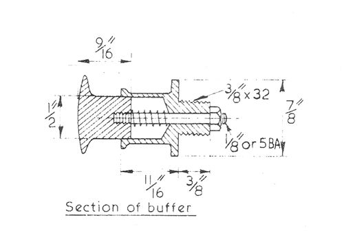

      I am currently building a lbsc juliet, I seem to the missing the buffer dimensions from my article photocopies. I dont suppose that someone has the page to hand that they can scan to the website. I can probably guess the size but I would like to keep the original plans as much as possible. Many thanks

            Is this any good Dave?
            I don't have a book but this is from the drawing sheet and is the only one I could see.
            Andy

                Have now located ME no 2414 28 Aug 1947 which contains the buffer dimensions, and they are the same as Andy's above, viz:
