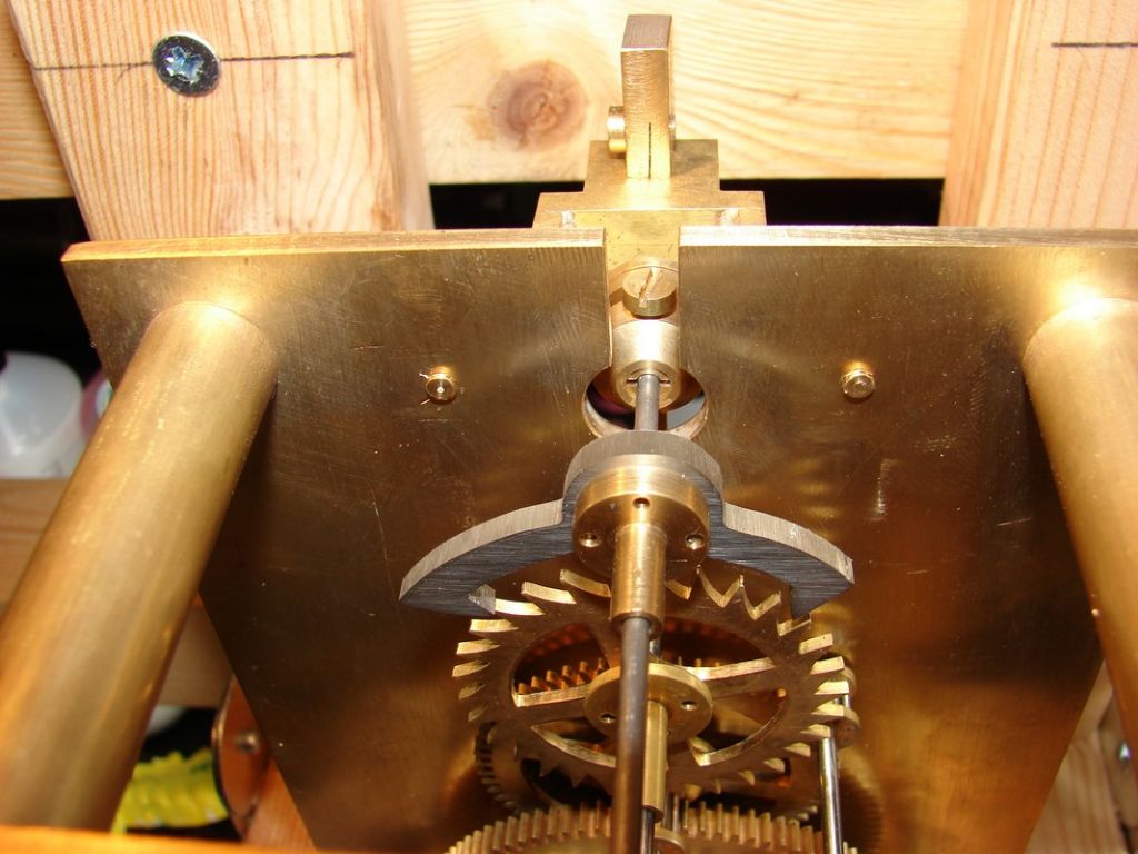

      Has anyone built the John Wilding weight driven 8 day wall clock?
      I started one 10-15years ago and struck a problem so I set it aside to think about it. I'm getting old and if I don't get stuck into it now, I may never complete it. I think I've resolved the problem I had initially, but I realise I'm not sure where all the bits go in relation to each other as there are no GA drawings in the book and the photos aren't much help either.
      I'm particularly interested in pictures looking down into the clock showing the escapement and pendulum supports.
      Regards,
      Alan C.

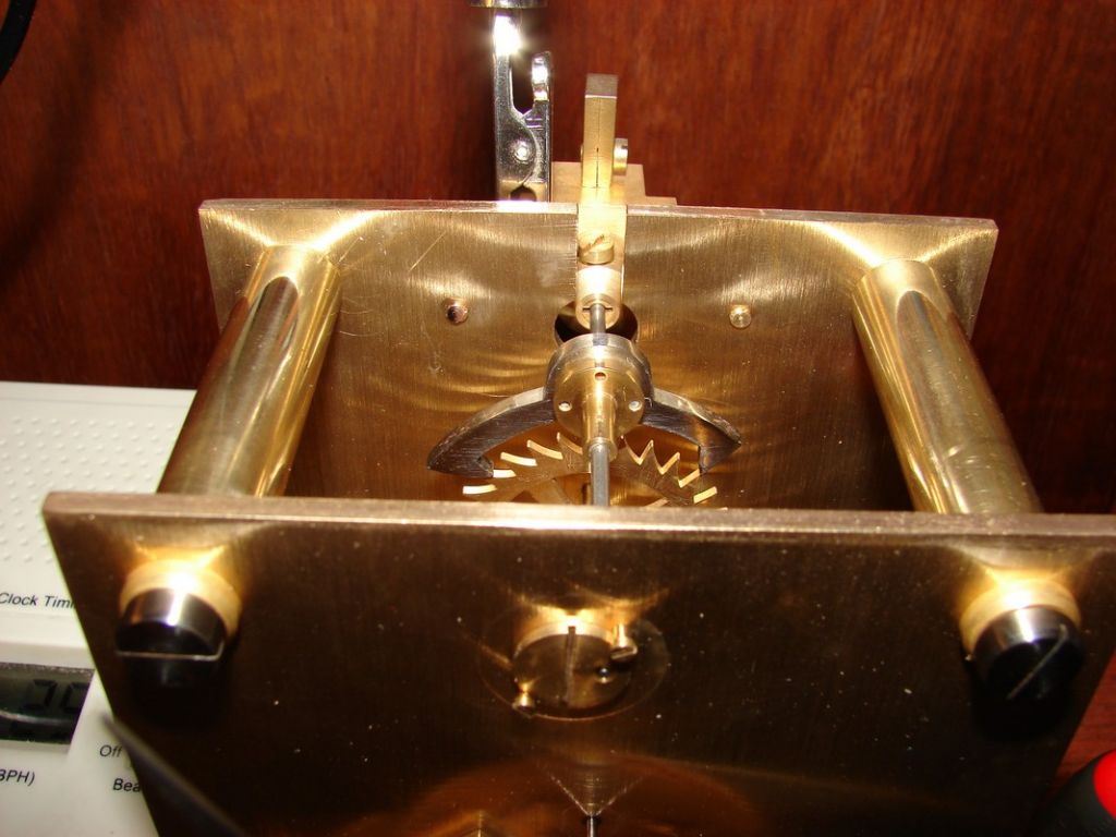

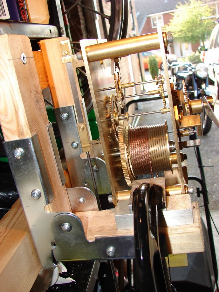

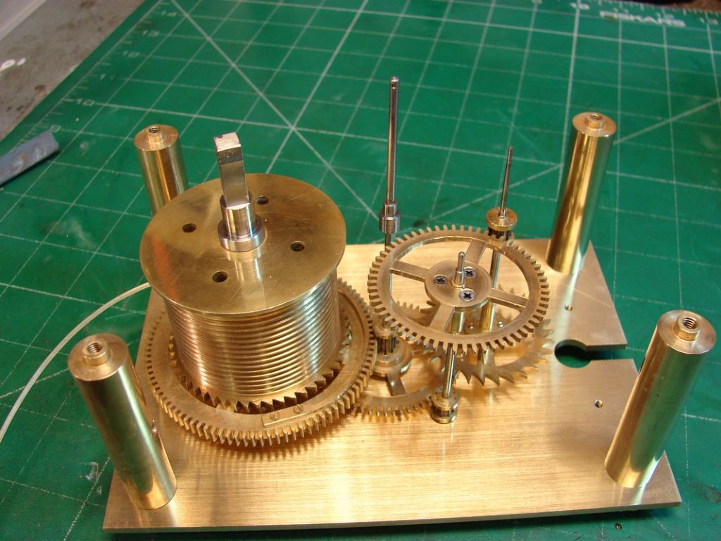

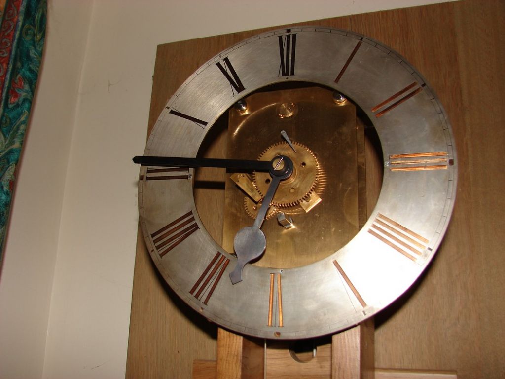

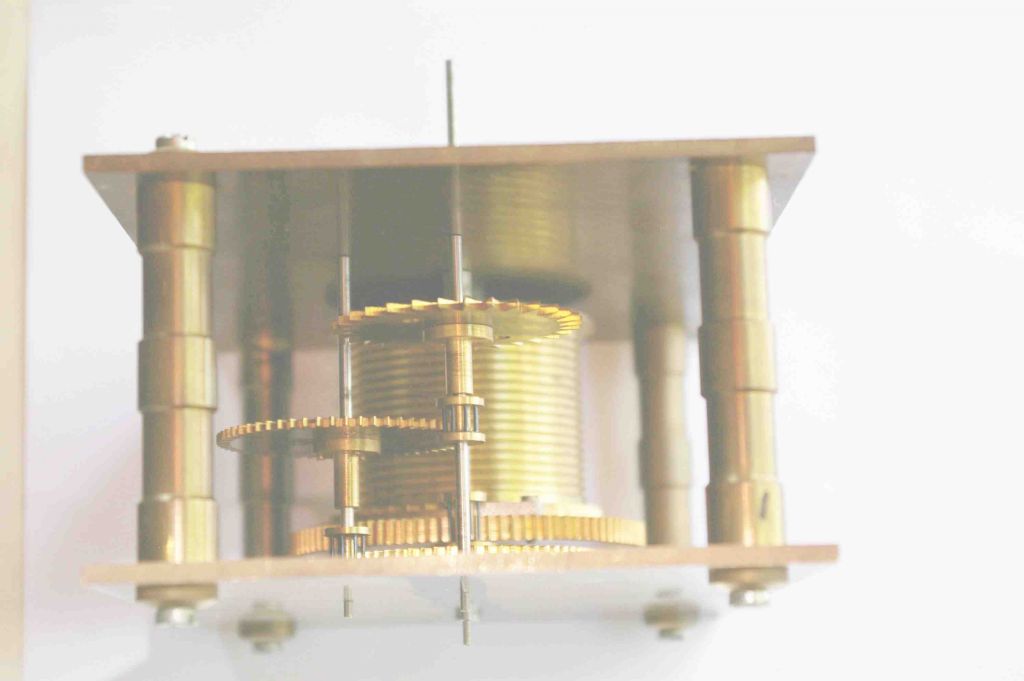

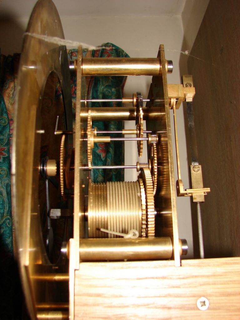

        Stephen Benson
          @stephenbenson75261
          It is a great first clock very robust design easy to make and keeps time to better than 20 seconds a week these are just photos I took when I was building it I can take more of the finished clock if need be.
          Mine would not run until I had opened out the pivot holes a bit which galled the engineer in me but if a clock does not rattle it will not run.
          It was my first clock and I made it many years ago so be kind it is still running perfectly

                  #274353
                  Alan Charleston
                    @alancharleston78882
                    Thanks Steven. That's just what I was after.
                    I'm not sure how far I'll get. I faffed about for a week getting ready to start drilling the pivot holes in the plates, and then made a mistake on the very first one! I drilled the centre wheel pivot hole 3/32" instead of 1/16". I think I'll leave it and add a collar to the shaft to hold it in place.
                    If I do manage to finish it I'll maybe put together a couple of general assembley drawings and post them for others in the future.
                    Hi Dick. Have you made the shell? If so, did you use silver solder to join the two halves?
                    Thanks for all your comments.

                      #274356
                      Stephen Benson
                        @stephenbenson75261
                        Posted by Alan Charleston on 30/12/2016 05:54:25:
                        Hi again Steven,
                        I've just noticed on your 3rd photo that the collar on the right of the centre arbor doesn't rotate in the side plate. I've reamed the hole on the front plate 0.150" for this arbor. Have I got the hole on the front plate wrong as well?
                        Regards,
                        Alan C.
                        Hi Alan
                        No your are right it looks like the book is confusing as that is a mistake I remember making, the collar should be steel and the curved spring sits against it to allow you to turn the hands without turning the wheels to correct the time. I will take some more photo's of the finished clock today.
                        Edited By Stephen Benson on 30/12/2016 06:25:33
                        #274358

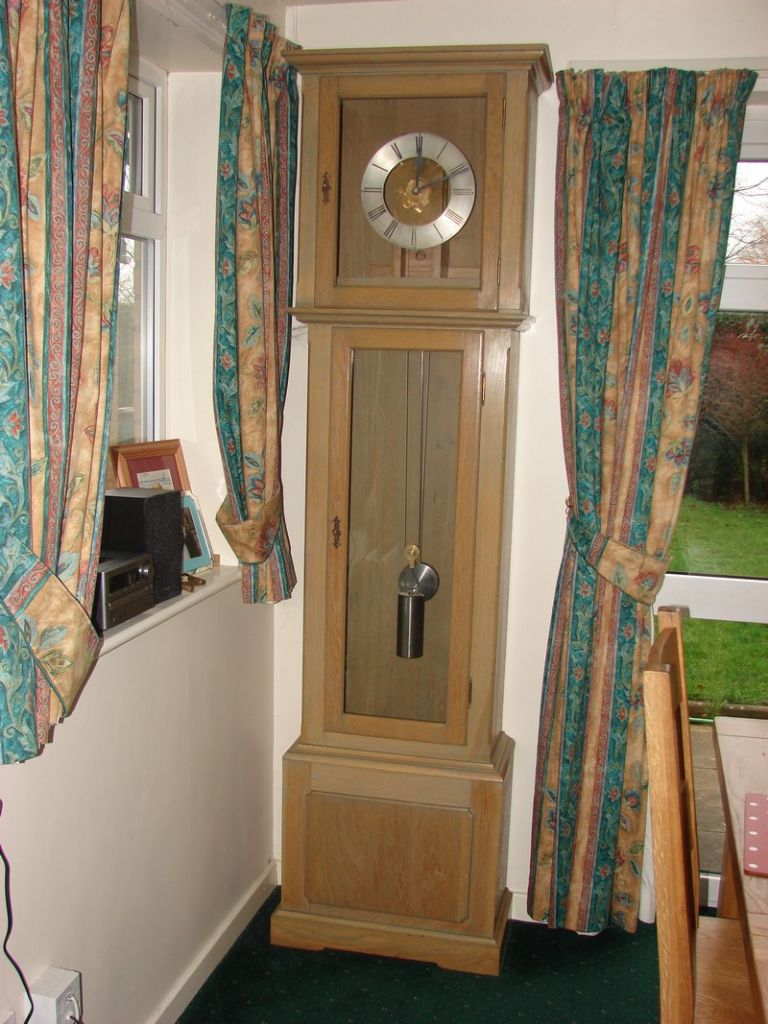

                        Stephen Benson
                          @stephenbenson75261
                          Right here is the finished clock after it has run continually for 8 or more years note the steel pendulum could not be bothered pouring lead. I had loads of other projects so never really finished it as I always intended to upgrade it to the later perpetual calendar version probably with bearings.
                          taken today complete with cobwebs
                          Edited By Stephen Benson on 30/12/2016 07:22:02
                          Edited By Stephen Benson on 30/12/2016 07:23:22
                          #274364
                          Jim C
                            @jimc
                            Hi Stephen. You must be very happy with the finished clock it looks great. I only hope I can finish mine to that standard. The photos will prove invaluable when I get back to the build. Hope you're open to one or two more questions as they arise. Cheers Jim.

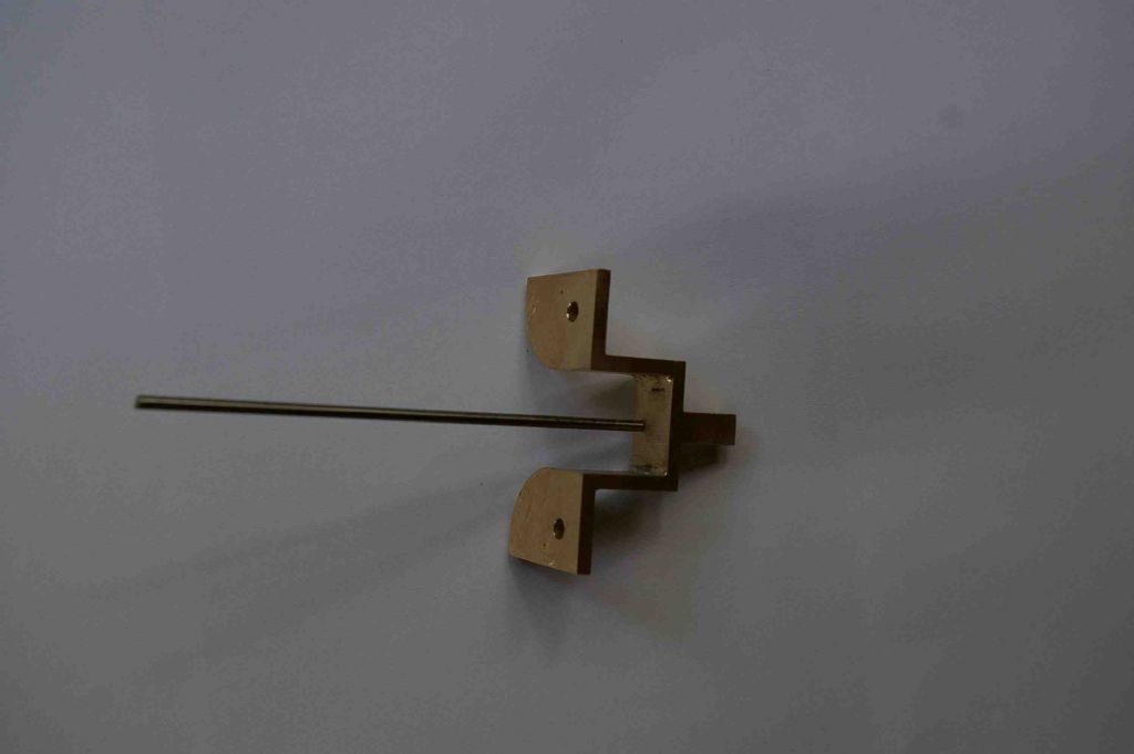

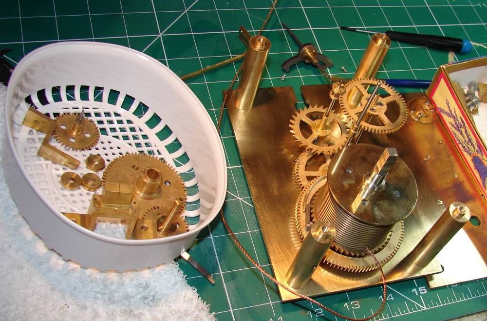

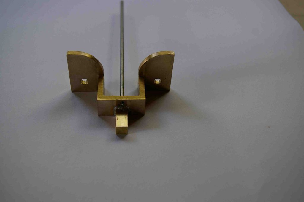

                                        Alan Charleston
                                          backcock2.jpgHi all,
                                          Thanks for the help. I got stuck in and have made the back cock.
                                          The plate connecting the two pieces of angle was silver soldered and the pendulum post was soft soldered into position. I'm pretty sure it will be strong enough.
                                          I haven't slit the post for the pendulum yet as I don't have the .006" spring steel or a 0.2mm slitting saw.
                                          I can source some .006" spring steel shim plate locally. Will this be OK for the suspension spring?
                                          I will order some 0.2mm slitting saws from CTC Tools. At $2-50 each I'll get a few of them I think. The thinnest saw I've used to date is 1/16" so any suggestions about things to watch out for will be welcome.
                                          Here is a picture showing where I am at the moment. The wheels and pinions haven't been loctited to the arbors yet. I want to have the pallets in position so I can see the whole train before I set them in their final positions.
                                          Thanks again for your help.
                                          Regards,
                                          Alan C.

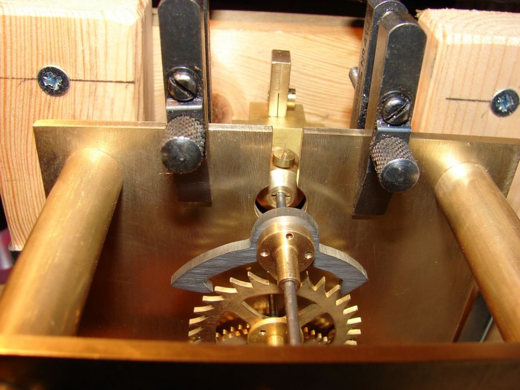

                                                #283734
                                                Alan Charleston
                                                  Hi,

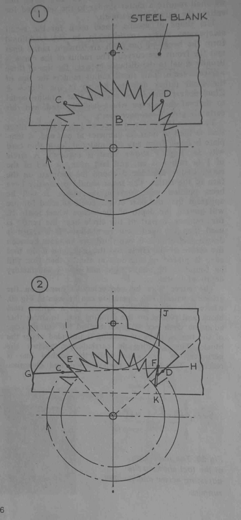

                                                  I wonder if someone can help me with the pallets for this blasted clock. The method for marking them out using a depthing tool shown in Wilding's book is too complicated for me so I have been trying to simulate his method using a drawing program to generate a paper pattern I can glue onto the carbon steel blank. The problem I have struck is trying to understand the situation shown in drawing 2. As I understand it, the pallets are supposed to cover 71/2 teeth on the escape wheel. As far as I can see from drawing 2, the pallets cover 8 teeth and appear to lock the escape wheel so it can't move. Any help will be gratefully received.
                                                  #283744
                                                  Bob Stevenson
                                                    @bobstevenson13909
                                                    The pallets DO space across 7 1/2 teeth but this is just the usual poor quality of JW writings………. Cut out the escape wheel and loosely nail/pin it vertically, then make a set of pallets from a piece of tin plate and nail that up too,..then have a play of the action and you will soon get the idea. Once you have a nicely working tin plate model you can use that as the template to cut out/file up the real thing.
                                                    #283753
                                                    RJW
                                                      @rjw
                                                      Alan, the drawing in photo 2 is to show how to generate the shape of the pallets, which are actually shown in mid position (pendulum mid swing (vibration) and the escape wheel is actually locked at that point, although there would in reality be a small degree of clearance between the wheel teeth and pallets at this point,
                                                      The pendulum (and hence the pallets) as it swings away from that central position will move one pallet face off a tooth and the other deeper into mesh, this will cause a small reversal of the escape wheel at that point and why it's also called a 'recoil' escapement as well as 'Anchor', the pallets 'rock' with the swing of the pendulum,
                                                      As the pendulum swings t'other way, it will move that deeper engaged pallet face out of and away from the locked tooth with the other pallet face moving towards the other tooth, at some point, the tooth that was engaged will be released and the tooth where the pallet is moving towards it will be caught by the pallet, the same happens when the pendulum swings back, but on the other tooth,
                                                      A bit of a clumsy description but hope it helps some,
                                                      You will need a depthing tool of some arrangement to set up the pallets to the escape wheel, because you need to get the pallet faces locking and unlocking the escape wheel as close to the teeth as possible without it actually locking up, otherwise the drop of each tooth before hit strikes the pallet face (and creates the 'tick' or 'tock'  when the escape wheel is released may be too large and will waste power (as well as ticking Very loudly),
                                                      The animation in the link below may help you understand its action:
                                                      **LINK**
                                                      There are several animations listed and linked on the site if you go to the homepage,
                                                      John.
                                                      Edited to get rid of a smiley?
