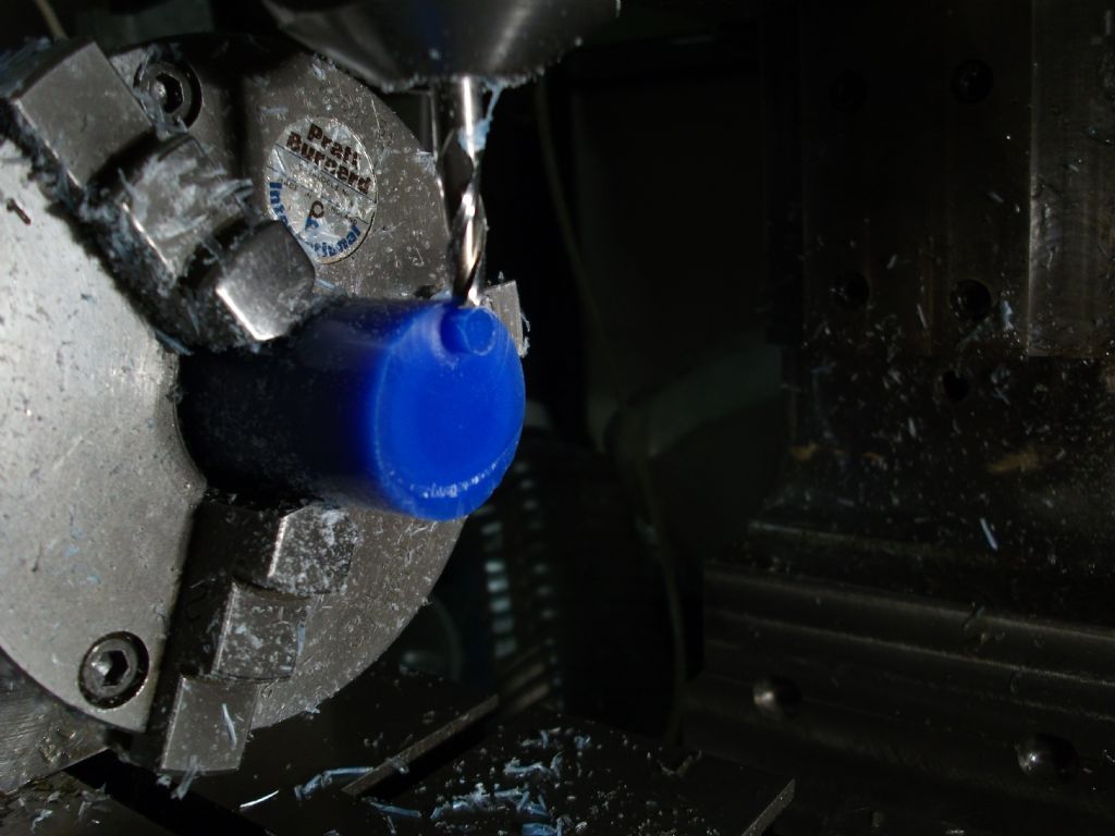

                    Hi Vasantha
                    Having done some of these type of plotting type job i know how tedious
                    it can become.All is not lost as you were doing it this way i will assume
                    that you may not know this as follows.I use an early cnc system "Compucut"
                    a Dos based unipolar system and an old drawing system Draft choice for
                    windows .The Compucut system has a file "circdata" in which
                    the basic units are inserted and produces a plot file ,this file is then
                    converted into a relative file .The file takes the form of PR nnn,nnn;
                    which Compucut uses " HGPL" . Using find and replace in wordpad this is
                    converted into the format 3R nnn,nnn,nnn; like you the the x axis is
                    all 000s and the y axis and z axis is using the data.
                    Most likely the drawing system you use will have a polygon function,drawing
                    this and saving the data it can be exported and the file produced is the same
                    as the circdata that i use ,perhaps the easy tryout is to draw an 8 sided form
                    and see what is produced. The compucut circdata has an odd quirk in that
                    the data starts at 0 deg in the 3 oclock position moving anti clockwise so to
                    use it for this crankpin the 1st quadrant is cut and then pasted at the
                    end of the file to start at TDC At 0.5 deg resolution the Compucut version
                    gives 720 lines for one rotation.the test piece in the photo is at 4deg and
                    has 180 lines only cut in wax just to tryout ,as in your post the axis of the cutter
                    tracks the centreline of the pin ,the pin diameter is determined by the distance
                    of the cutter relative to the axis of the pin.
