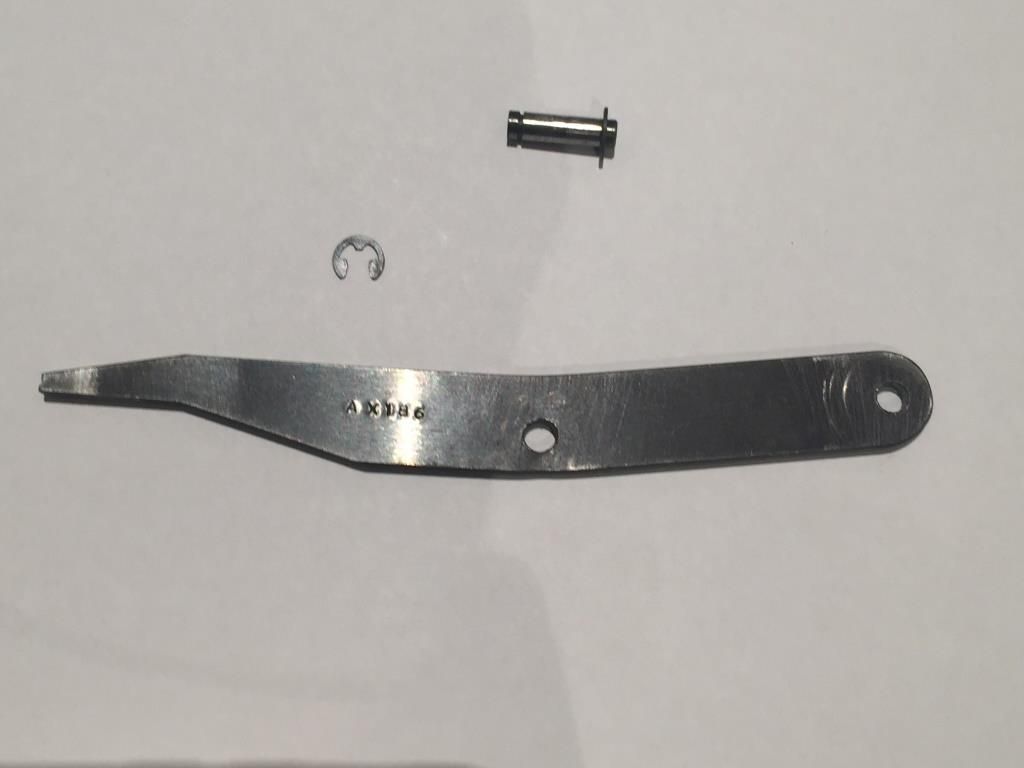

      Not sure if this thread is still 'live' but I'm rebuilding a Downham Mini-Jig Borer!
      My problem is a missing support strap (not sure what it's called but I've marked it in photo 2 with a red blob).
      What I could do with is a scale drawing (or tracing from the part) so that I could make up a new one from a bit of scrap plate.
      I've also posted this question on another thread (hope that's not breaking the rules!) to reach as many people as possible.
      Thanks
      Zeek

            #545379
            Gwilym Box
              @gwilymbox37276
              Hi Zeek,
              This is my support strap. I'll get it measured up for you and post the details.

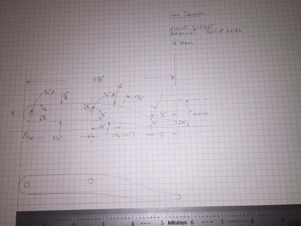

              #545547
              Gwilym Box
                @gwilymbox37276
                These are the measurments from my bracket. The machine is imperial and the tolerances are reasonably wide for this bracket. Let me know if I missed something.
                #545662
                Zeek
                  @zeek
                  Gwilym – Brilliant!
                  That's just what I needed. As you say, luckily (unlike the rest of the machine) it's not a precision part thank goodness.
                  I'm also relieved that it's only 1/8" steel – didn't fancy cutting that profile from 1/4"!
                  Thanks again, Zeek.
