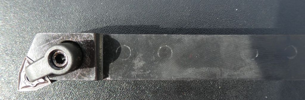

        I bought this Chinese made indexable holder (16mm shank) and some inserts a little while ago. It’s a design I have never used before but I have been very pleased with its performance. However, the insert has become blunt and needs turning and this where I am having a problem. I cannot shift it. The clamp part I have no problem with, it’s the location pin that goes through the hole in the insert that will not move. I do remember that when I fitted the insert I had to loosen the pin to get the insert to go over it and then tightened it ready for use.

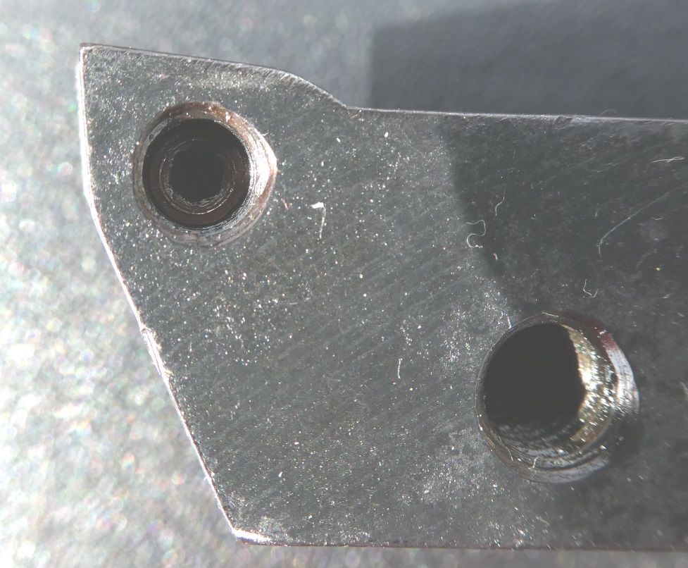

        Looking at the top of the tool, the pin has a hex socket for the allen key. Looking at the bottom of the tool – and the pin hole – there is a hex socket there as well. I don’t remember whether the pin assembly is in two parts or just one bit. So the question is – to remove the insert which bit of the pin should I loosen first? Top or bottom? Also are both ends RH threads? Thanks in advance.

          As far as I understand it the hex socket in the underside of the pin is basically put there so it can be installed and removed. The pin will be a snug fit in the insert but the inserts usually slip off, maybe with a little tap.
          If you can rotate the pin without damaging its hex recess then you could unscrew in which case it will act as a tip ejector.

            I think  this design moves the pin to draw the insert back into the recess, using the bottom half of the screw and completes the clamping with the overhead finger. After a long period in one position it may be reluctant to move back and a light tap with a soft drift may well release it

              I have some similar holders although not made in China, the larger screw that tightens the lever that clamps down on the insert may have a hex drive top and bottom allowing you to use two hex keys at a time on the same screw you may find your screw has the same configuration. This allows double the force to be applied without risking cracking the hex socket.
              The screw is actually a differential screw with two different threads, if you remove it completely you may find it does not engage the clamp correctly the clamp will be too high or low. try it a couple of times until you get the correct sequence to set the clamp in the right position.
              The single central pin screw also should have a cam action that when you tighten it draws the insert laterally towards the holder. Try using two keys on it too, It should move.

                Update: Thanks all for the advice so far but still no go. I've tried my chefs blow torch on it but it makes no difference. Just to clarify – the problem is with the insert location pin/screw – it won't budge. The larger overhead clamp and its screw work fine. – Rik

                  Surely top screw is only to clamp the insert down, so can be removed completely. Looking at toolholder from underneath, by rotating socket screw anti-clock, this should allow eccentric pin on other end of this to rotate anti-clock and unclamp the insert which it's pulling back towards the clamping hole?

                    Thats a holder for negative inserts, and the top screw as stated earlier only serves to hold the insert onto the pin. Its the pin that when tightened draws the insert firmly into the pocket. Most [all? ] have it so the pin is attached at right angles to a bearing part that will "tilt " when the screw is tightened. If the insert is still held firm try have you tried turning the screw in the opposite direction? I have a few of that type [Arno and Sandvik ] and they all work in the same way.

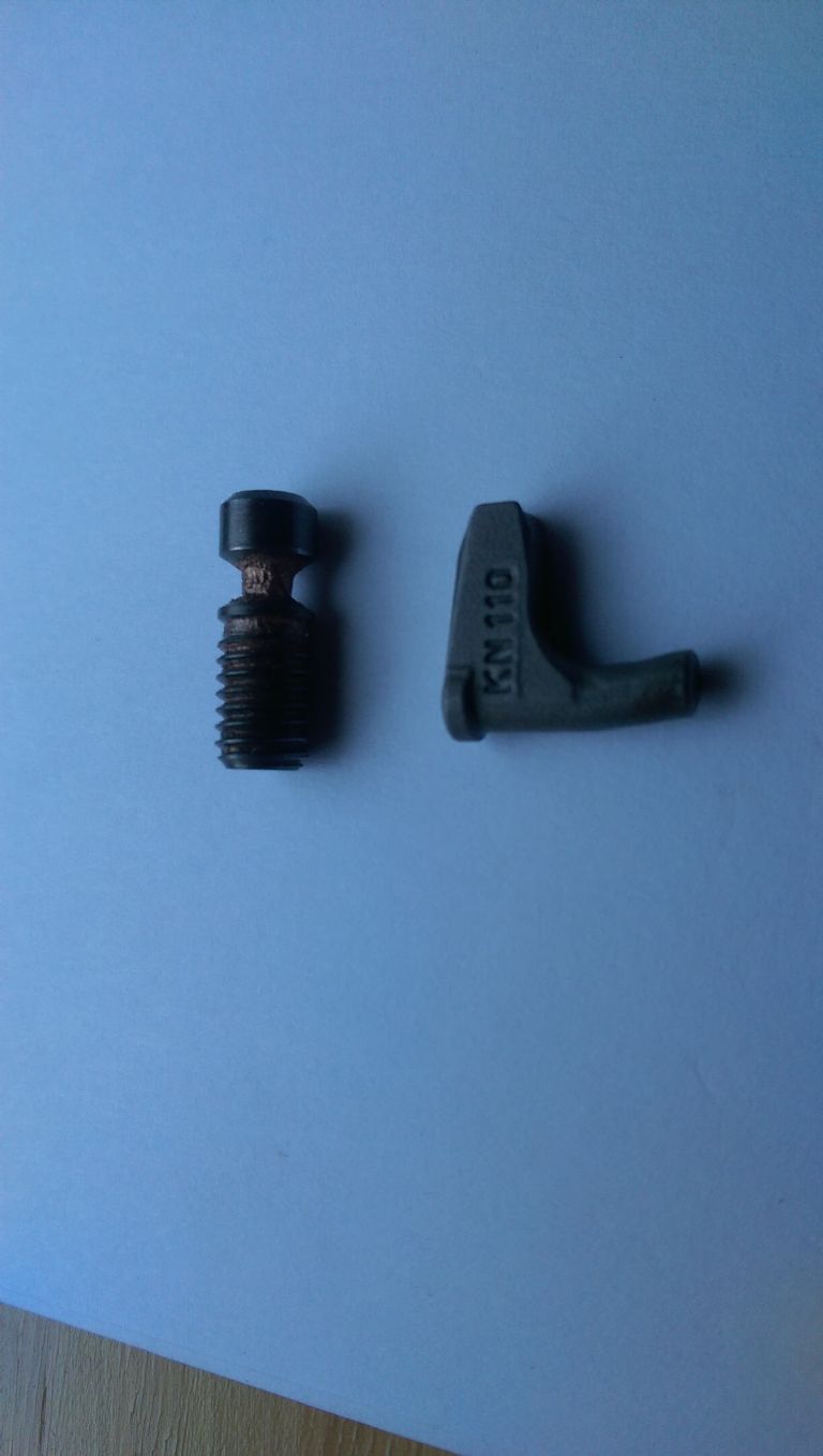

                                                  Here is a locking pin from a Walter 25×25 most work this principle. There is a carbide insert seat not shown in the pic as thats not relevant to your query. Not sure if your chinese toolholder works on this principle or not,. most industry standard ones do. The brown stuff you may be able to see on the screw is high temp grease. I always give the innards a wee coat everytime I change an insert.

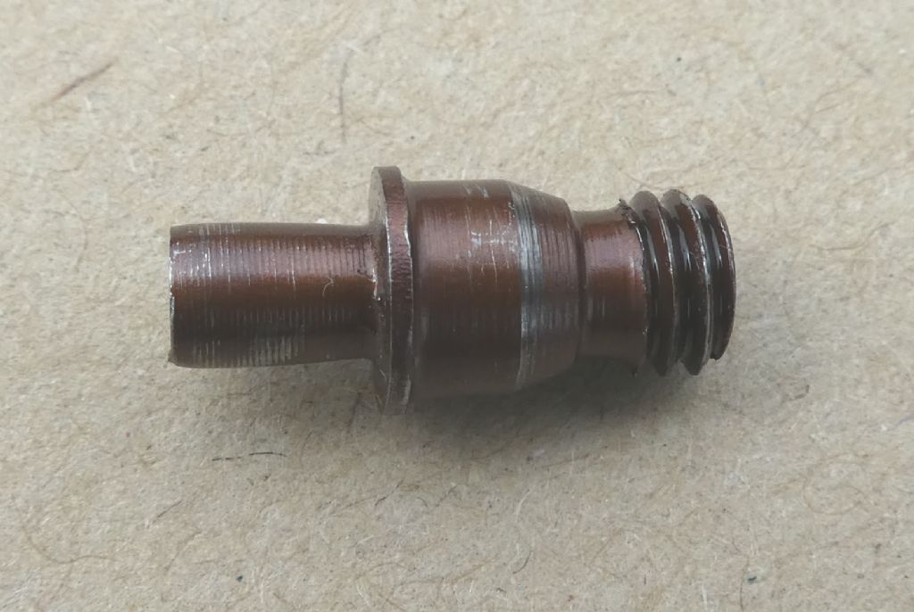

                                                    Thanks for all your input which I found mostly helpful. I still could not remove the pin so I used a sharp edged drift and tapped either side of the insert and eased it of the pin. Once the insert was of I managed to unscrew the pin with an allen key quite easily. I shall have to remember in future that when I replace an insert the pin only needs “nipping” rather than tightening.
                                                    Now I can see what makes the pin work. It has a taper on the small location diameter which can be just seen in the photo. This taper pulls the insert back into the pocket when the threaded pin is tightened – Rik
