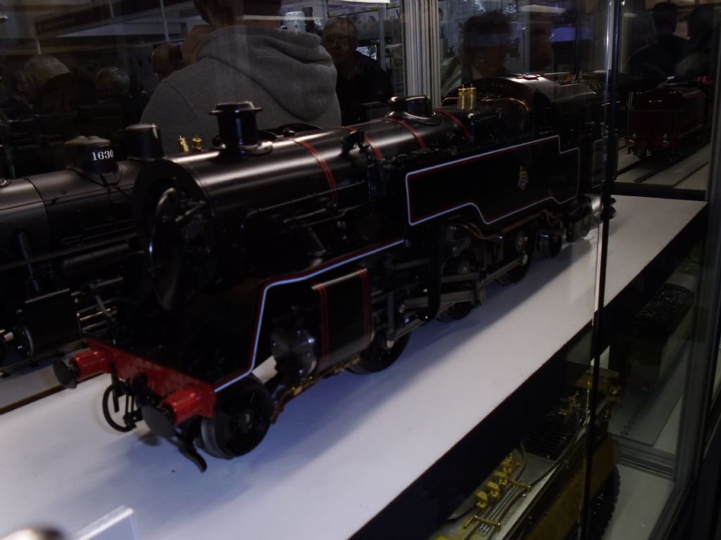

                                                    I have the Kozo books and whilst I will never build any of his engines, I do find them inspirational. His illustrations are remarkable and I also use some of his ideas/methods too. When you think he learned English in order to write his original articles – he is a very extraordinary man.

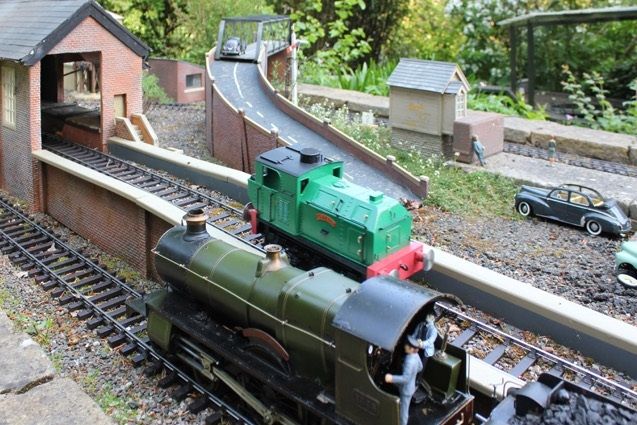

                                                    Yes, Gauge '3' is different from ' 2.5" Gauge ' – we don't passenger haul (cruelty to small steam engines?) and spend a good deal of time building scale rolling stock as well as locos. Whereas the National 2.5" Association runs its Rallys at ME Societies, we have Garden Get-Togethers and Exhibition layouts to run on.
                                                    You will see designs by LBSC, Martin Evans & Don Young running but the trend these days is towards more true scale engines – especially with the arrival of Chinese built G3 locomotives like this Class 4MT (seen at the West Midlands Show – sorry it's a bit dark – but had to turn flash off because of the glass case..)…
                                                    Class 4MT
                                                    Of course, there are also many scale G3 battery electric locos around too – I've helped to design one myself…a small 100HP Sentinel — and the CAD took me much longer than it seems to take you! I drew the original engine full size (from prototype GA drawings) and then scaled it down at 1:22.6.
                                                    Arthur at Farnham 2
                                                    He's (his name is Arthur!) about the same size as a 16mm loco and being an 0-4-0 is usable on very tight curves. One day I might just get around to designing a small G3 live steam engine, using much the same approach as most 16mm locos but obviously to a standard gauge prototype…
