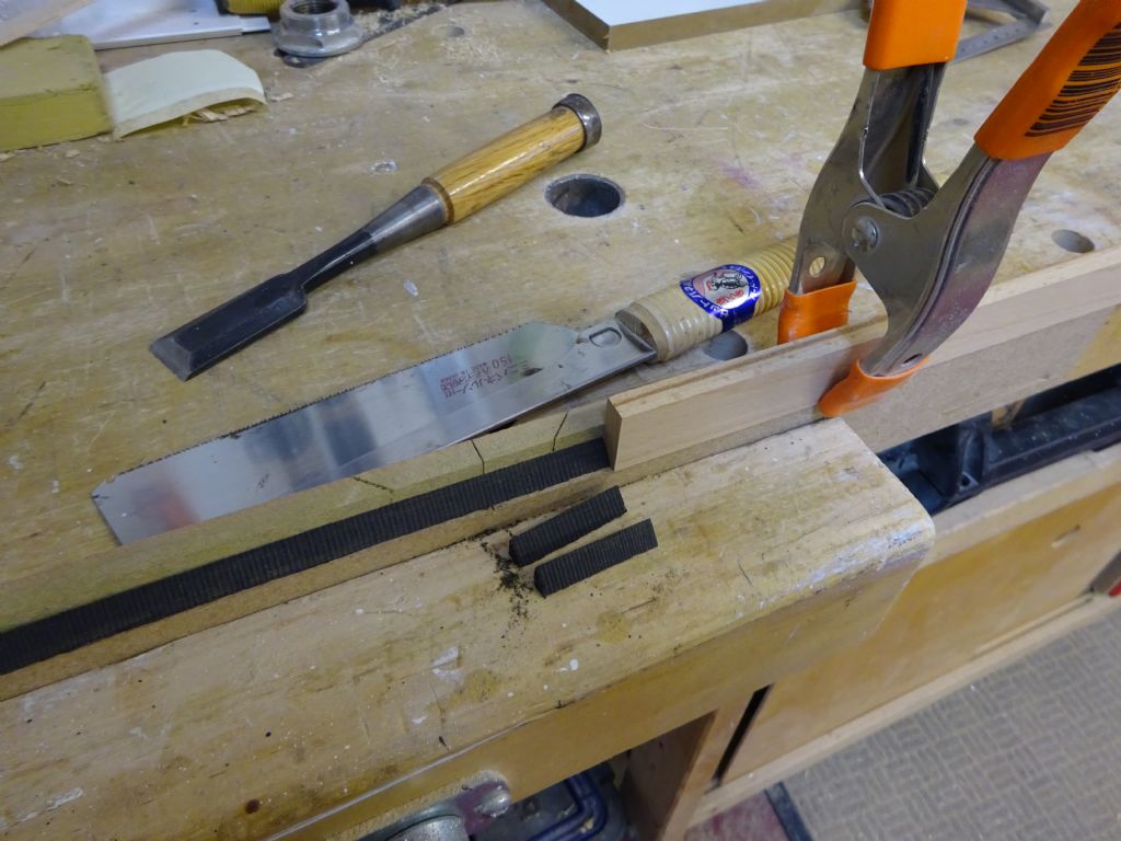

        I cut a lot of small pieces of thin wood (square dowel etc) to the same lengths.
        Its a bit tedious marking each to length putting it in a vice, sawing to the pencil mark, sanding the excess etc.
        I picture a tool that i can set to a length (like a vernier caliper) drop a piece of wood in, tighten and cut off the excess sticking out, against a hard edge with a razor saw, then repeat.
        Does such a thing exist or is there a relatively easy solution to put together for someone with only hobby level tools?
        I can see how i would make a gig for one specific length that i could put in a vice, but while I might want several matching pieces, the length would change job to job, and that sounds like making as much work as it solves.

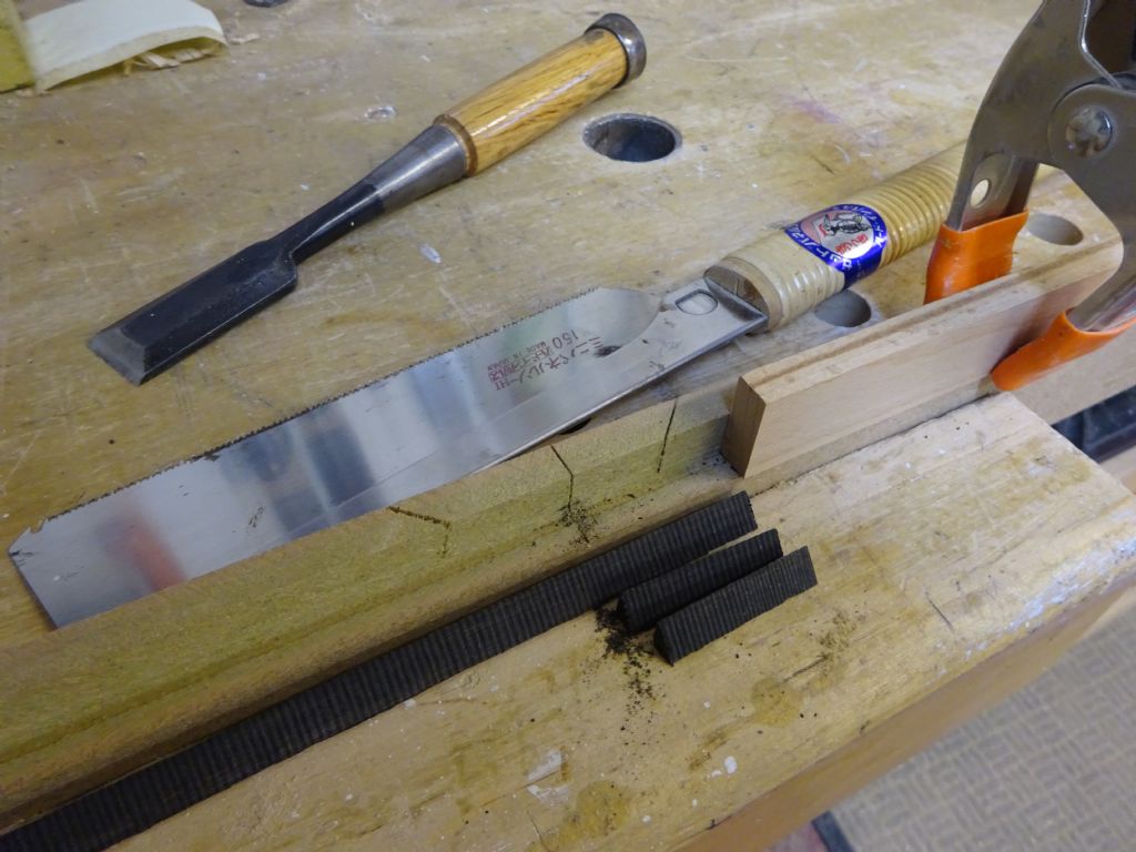

                                              Well this is what I came up with, from some wood off-cuts, a cheap metal ruler and a small G-clamp.
                                              Basically this gives me the quick and easy measure and cut measure and cut that I couldnt quite find from bought solutions.
                                              The part to the right is a support, as i often cut from a long length of dowel and find the long end can snap off under its own weight at the end of the cut, splintering along the back of the cut piece, this should minimise that.
                                              I have a small mitre box for angle cuts, but I seem to rarely need that. This is it in a small bench vice.
