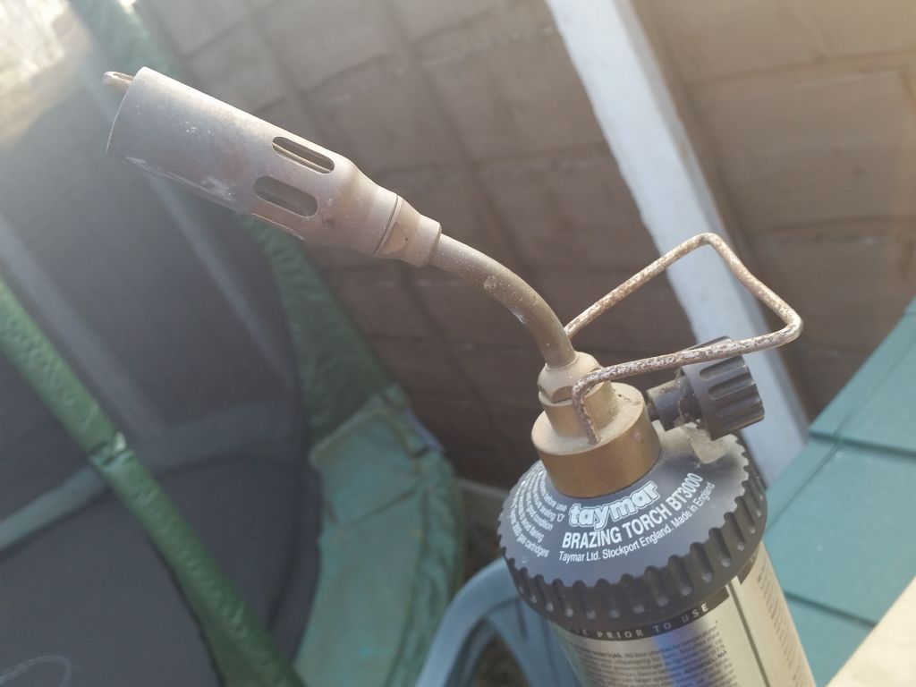

      I was unsure whether to post this here or in the ‘Tools’ section, but it’s a tyro question so here we go…
      I have a Taymar screw on blowtorch, the sort that uses tall slender canisters of gas. Now I’ve already used it for annealing some 1mm copper and tried to silver solder with it, but it wasn’t hot enough to get the solder to run. It just made clumps instead.
      However, the gas I used was pure butane and I’ve now switched to a canister of butane/propane mix. This is MUCH hotter as was proven when I annealed some more copper for my replacement boiler (I tried for so long with the first it went squiffy). With the new gas it had the copper glowing in no time at all, literally seconds.
      But… will it be hot enough?

              #185959
              Steven Greenhough
                @stevengreenhough56335

                  #185967
                    Well it claims to be a brazing torch, so it should be able to braze something. In my experience even the smallest torch can braze/silver solder something, but it might be very small. I would guess that that isn't much bigger than a DIY blowtorch and will probably manage smaller jobs, but not a boiler!
                    Does it have a rating on it?

                      Steven Greenhough
                        Posted by Neil Wyatt on 09/04/2015 21:42:38:
                        I can't answer that right now Neil, as I've locked up the shed. And it's dark. If it means anything, I guess the burner diameter is in the 20-something-mm range.
                        It might be worth pointing out that the boiler in question is only 65mm long and made of 35X1mm tube, with a single 15mm tube for a flue. Cracker is a 'toy' loco at the small end of gauge O / 32mm.
                        I suppose I could try re-fluxing and re-heating my previous boiler, and see if the torch performs before having-at my new parts.

                            #186432
                            Steven Greenhough
                              Well it managed it. There are some photos in my album but I posted a couple in the “What have you done today” thread so I won’t repeat here.

                              KWIL
                                @kwil
                                The clue is in the "clumps" of silver solder. Heat the metal to be joined and NOT the solder stick, if the metal is hot enough, the solder will run by simply applying the stick to the heated metal away from the flame, once the flux has melted and glazed.

                                Keith Hale
                                  @keithhale68713
                                  KWIL is correct. But check on the grade of silver solder. Low silver content alloys (as favoured by most DIY stores because they are cheaper) have higher melting points and are more difficult to use.
                                  Alternatively, when heating, place the components on lightweight refractory bricks or insulation blanket to improve your heating efficiency.

                                  Steven Greenhough
                                    Silver solder and accompanying flux was bought from an eBay seller who lsted it as Silverflo 55 and Easyflo flux. I also bought refactory bricks from the bay.
                                    I think the problem was essentially down to initially using butane. The butane/propane mix was visibly and audibly ‘fiercer’ before I’d even put the flame near the metal.
                                    That said, the time from when the flux went clear to when the solder would run still felt a little bit too long, so I’m resigned to investing in some other burner if i ever build anything with much more mass. I will look at the screw on propane/MAPP types probably.
