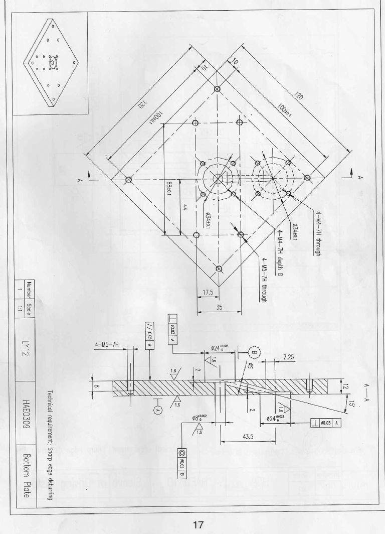

    Cornish Jack
      @cornishjack
      G’day all.
      The above drawings are for a Sieg hot air engine which I’m in the process of mangling. There are very few written instructions and they are in ‘Chinglish’. I am having difficulty getting my head around the machining of the plate in the second piccy – I think it is inverted … the sloping transfer passage I would have expected to upwards from the hot end to the right to the cold end. Could someone with drawing reading skills please check and confirm, please?
      TIA
      Rgds
      Bill

        Les Jones 1
          @lesjones1
          Hi Bill,
          I think you are assuming that the plate edge view at the bottom of the page is the
          the correct way up. If you look at the blind holes that the pillars screw into you can see that face must be at the bottom. I think this is to do with first angle / third angle projection.
          (I can never remember which is which.)
          Les.

            The main problem is that both the 24mm recesses are shown on the opposite side by the use of hidden detail but the section shows them correctly with one each side.
            EDIT just blew it up larger the central hole is nor shown with dotted lines so the drawing is correct but shows the underside.
            Going by the general assembly drawing it looks like the passage should go upwards from the central recess to the off set one on the top surface. So as you look at the section the bottom of the plate is on the left.
            The small Isometric view is of the underside going by the blind holes in teh corners
            J
            Edited By JasonB on 30/11/2011 16:53:17

            Terryd
              @terryd72465
              Hi Bill,
              The second drawing you refer to appears to be in third angle projection rather than the now preferred first angle. The central counterbore with the through hole is in fact the underside of the plate, which I assume to be the hot end (I know very little about Hot air engines) and the transfer port indeed slopes upwards to the second counterbore which is on the top according to the exploded assembly diagram at the top of yor message.
              So if the drawing was in the proper orientation, i.e. landscape, the top of the plate on the sectioned view (to the right) is in fact the right hand side. I hope that makes sense having re read it it seems confusing. PM me if you have a problem with interpreting it and I will try to help.
              Regards
              Terry

              Cornish Jack
                @cornishjack
                Wow!!!
                Thank you Les, Jason and Terry – just popped off for a cuppa and come back to my question sorted. For a simpleton like me, the plate diagram is upside-down … yes?
                Rgds
                Bill

                Les Jones 1
                  @lesjones1
                  Hi Bill,
                  I’ve just noticed that the drawing has been rotated clockwise by 90 deg. If it was viewed with the left hand edge as the bottom it would not be quite as confusing.
                  Les.

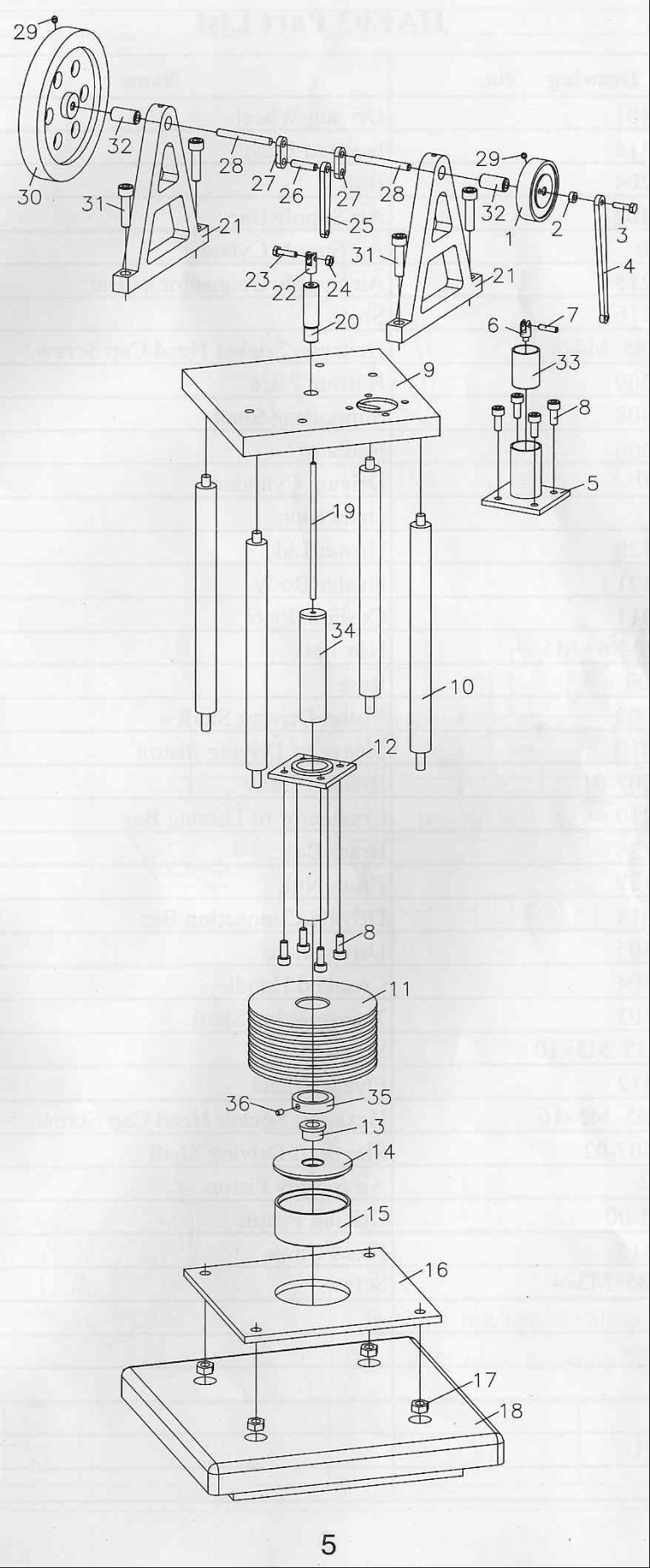

                    Clive Hartland
                      @clivehartland94829
                      The exploded view shows the plate in its correct orientation with the offset hole in the upper face. ergo, the drawing is in fact upside down and the cross section shows the hidden detail with the sloping hole downwards towards the central hole.
                      The Isometric drawing shows the under face view.
                      This is not 1st angle nor 3rd angle but just a detail drawing with a cross section.
                      This is nearly always included as a seperate sheet or a boxed drawing on the main drawing.
                      clive

                      Terryd
                        @terryd72465
                        Sorry Clive but it is third angle. It has to be one or the other, it certainly isn’t 2nd or 4th. Just because there ar only 2 views does not change that fact.
                        Regards

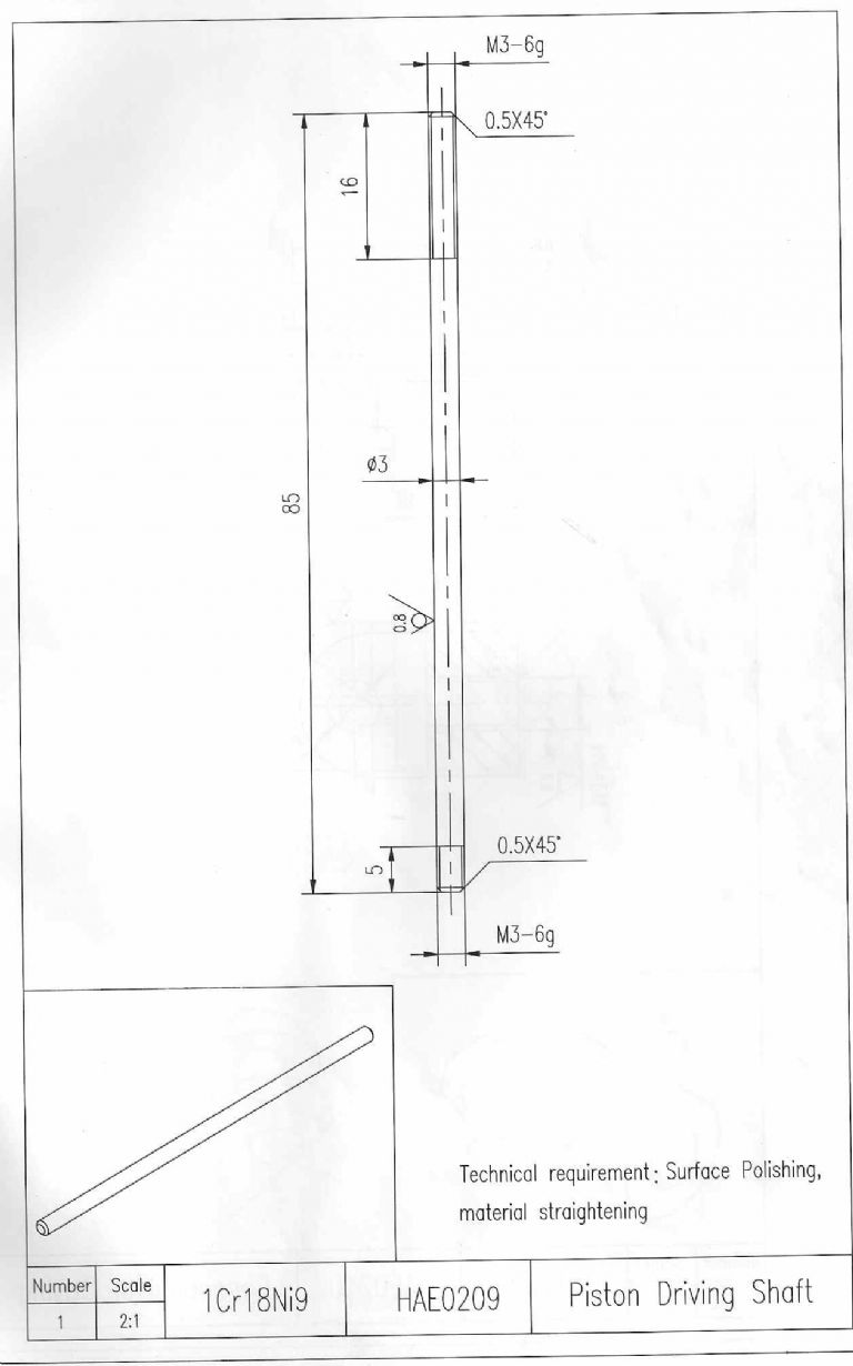

                        Cornish Jack
                          @cornishjack
                          Anyone remember Harry Hemsley? I am starting to feel like him when he used to produce his catch-phrase. “What did Horace say, Winnie?” I can cope with upside-down but nil comprende 2nd angle, 3rd angle etc!!
                          However, to strike while there are lots of knowledgeable folk about. …the new piccy is yet another that I ‘see’ as being upside-down. It is item 19 in the exploded view and connects the hot piston to the little end yoke. As I read it, it is threaded 3mm for 5mm at one end and 16mm at the other. However, the illustrated orientation puts the 16mm length at the ‘top’ (where the little end yoke is) and the 5mm at the bottom to connect to the piston. In point of fact, I don’t have metric taps/dies so made an ‘executive decision’ to modify it to 6 BA. All well and good but I am using the 16mm length at the piston end. One supposes that such a relatively long thread is there for adjustment purposes but I have no idea what that adjustment should be and the booklet says nowt!
                          All suggestions gratefully received.
                          TIA
                          Rgds
                          Bill

                            S.D.L.
                              @s-d-l
                              Posted by Cornish Jack on 30/11/2011 21:53:32:
                              TIA
                              Rgds
                              Bill
                              Detail drawings such as the shaft are often not drawn in the same orientation as the assembly drawings. They are often rotated to fit the paper orientation portrait / landscape etc or so that a certain face is easier to detail or see.
                              I would guess long thread down with a nut used as a lock-nut.
                              Steve Larner

                              Ian S C
                                @iansc
                                ! would agree with long thread into the displacer, but I would tend to leave the locknut off, get the length, if too much surplus cut it off, then reassemble with loctite (just screw lock), I like to get rid of as much weight as I can. My latest motor has a 2.5 mm displacer shaft, with a 6 BA thread on the displacer end, and a clamp type fitting on the gudgeon fork end. Ian S C

                                Cornish Jack
                                  @cornishjack
                                  Thank you Terry, Steve and Ian.
                                  Ian – “get the length” – thereby lies the problem. How does one gauge the correct length? I’m assuming that the most basic mode would be to ensure that the displacer (that’s the word!!) mustn’t contact either end of the cylinder, but how much clearance? Is there some sort of formula for calculating this to enhance performance or is it strictly ‘suck it and see’? Is it just a matter of cylinder length minus crank throw divided by 2? So many questions, so little knowledge (that’s me, of course!!)
                                  Rgds
                                  Bill
                                  #78997
                                  Ian S C
                                    @iansc
                                    Bill, I don’t bother with maths, I measure the length of the cylinder, and the length of the displacer plus stroke, the extra length of the cylinder divide by two, find a washer, bit of cardboard, or something,drop it down the hole and assemble the displacer assembly, put the forks on the rod and hook up the con rod, You should be able to turn the motor over with it just touching the spacer at the bottom. Take the cylinder off, and take the spacer out NOW, it won’t hurt if the bottom end has a few thou bigger gap than the cold end, thats where the expansion takes place.
                                    The motor I just finished is similar to the SIEG, and GRIZZLY horizontal beam motor, it has a bore of 3/8″, and a stroke of 1/2″, The displacer cylinder is made from the steel case of a AA size NiCad battery, no plans so all mistakes are mine–wot mistakes! I really need a non contact tacho, my geared on is OK on the bigger motors, but it takes too much power with the little ones, my guess is about 2500rpm, maybe nearer 3000, its just been a bit of a design difficulty making a small enough burner. Ian S C
