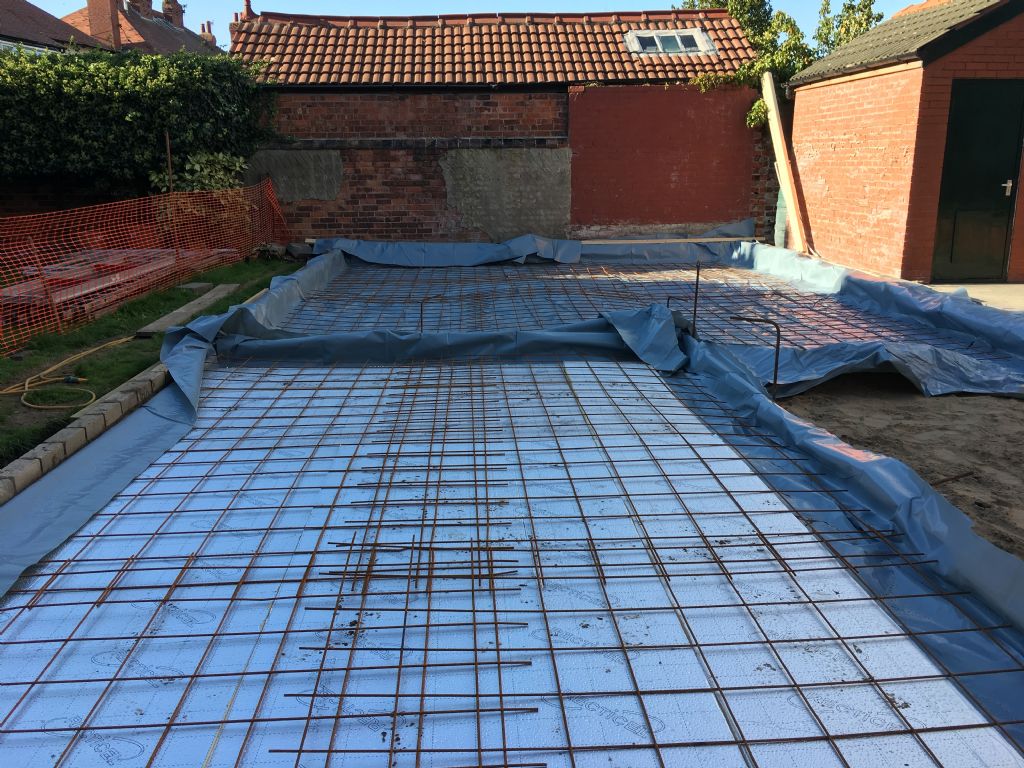

                                        Here's a view of the "Recticel" insulation fitted under the slab we had laid a month or so ago. It's basically polyurethane foam with aluminium foil on the surfaces and goes between the slab and the hardcore. This is to meet building regs insulation requirements for living areas – the area front left will be a dining / sun room. The Visqueen DPM goes under the concrete slab.
                                        The steel mesh is to strengthen the rest of the slab where machine tools will reside but it seemed rude not to use up what was left in case we have a heavy dining table – or perhaps a very large turkey.

                                                  Floor slab with mesh on previous page, if the mesh is laid flat on the insulation how is it going to reinforce the concrete? I would have thought that the mesh should be propped up clear of the base surface so that the mesh is central to the thickness of the slab, I saw a mesh reinforcement being laid a few years ago for a shop base and the mesh was propped up with moulded plastic raisers,,For my septic tank base we poured 3 ins of concrete,laid the one sheet of reinforcing then added another three inches. On my bungalow extension the floor was beam and block,with a layer of polythene then 100 mm insulation,another layer of polythene, then 75 mm screed reinforced with light mesh, my workshop has 50mm of chipboard on the floor,an inner and outer skin of 16 mm tongue and groove timber ,with building grade polythene under the outer skin with fibreglass in the 50mm cavity, ceiling is 12mm plasterboard,100mm of fibreglass ,then 12mm ply clad with corrugated iron,plus double glaze windows ,that keeps me warm and I used it daily for 20 years to earn a crust.If doing it again I would use Celotex all round,buy the best insulation,some of the cheaper stuff is not so fire retardant .

                                                    re mesh. There are youtubes showing a sloppy mix put on then a hook pushed in to yank the mesh up a bit at least around the edges.

                                                      Probably some with fibres or s/s needles incorporated in the mix to do away with a single reinforcement mesh in garage bases, etc. Mine went in over 20 years ago and is still in one piece.
                                                      But so is the first slab, laid in 1978. No reinforcement and prolly only a 25 Newton mix.
