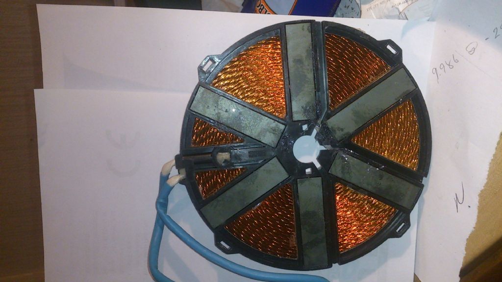

                                        #175766
                                        Robin Graham
                                          @robingraham42208
                                          Well, after delay due to 'flu, finally got round to picking up the hobs. For anyone else who hasn't seen how the elements are constructed but might be interested:
                                          I'd naively assumed that the element would be a simple 'pancake' coil, when I would have been able to calculate the inductance at least roughly, but the six ferrites(?) scupper that, so further progress will have to await the emergence of function generator/scope from packing cases .
                                          Robin.
