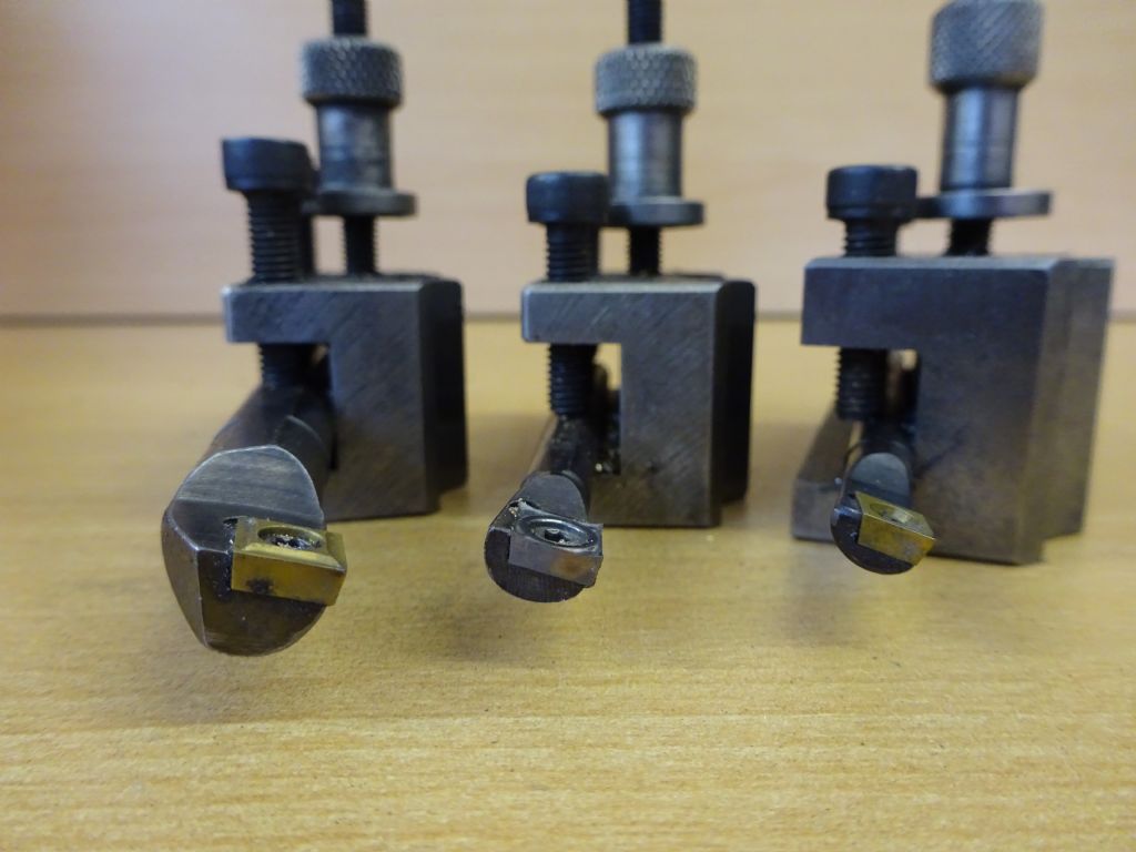

            3 Flats is unusual for  alathe boring bar, can you post a picture as it may be meant for  aboring head. If you do want to rotate it then make or buy something like this that is bored to fit the round of your bar

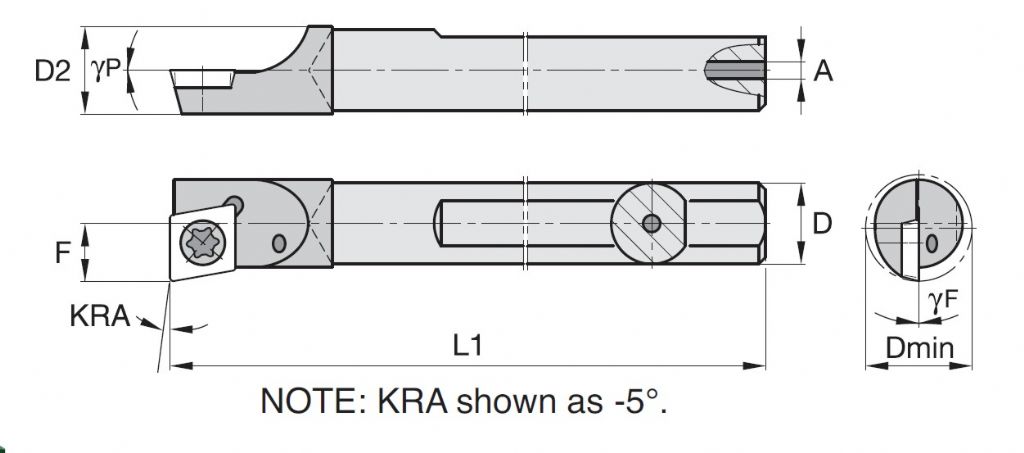

                  Hello Robert,
                  The insert should be at centre height
                  Check the specifications for your boring bar, but yes the minimum diameter is generally limited by the front clearance of the insert rather than the diameter of the bar, see the small image at bottom right below.
