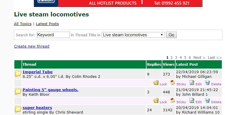

                          Posted by Jeff Dayman on 22/04/2019 04:38:19:
                          JB and Paul – no idea what clue you mean. All I see under title is "All topics / Latest posts"
                          Jeff,
                          Scroll up to the title of this thread
                          … immediately below that is the subtitle.
                          Imperial Tube
                          6.25" o.d. x 6.00" i.d.
                          All Topics | Latest Posts

                            #405971
                              It also shows up in the topic listings under the thread title.

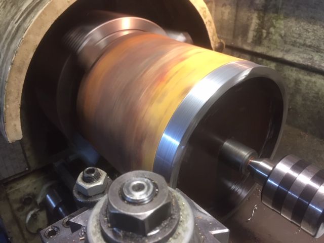

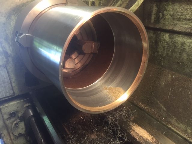

                                  8" 4 jaw holding 3/8 thick tube. Smokebox for Doncaster A3, 6-1/2" O.D. I think. Cross slide just cleared underneath by very little. Boring from the first end was OK, but it really started to ring and chatter when boring from the second end.bore.jpg
