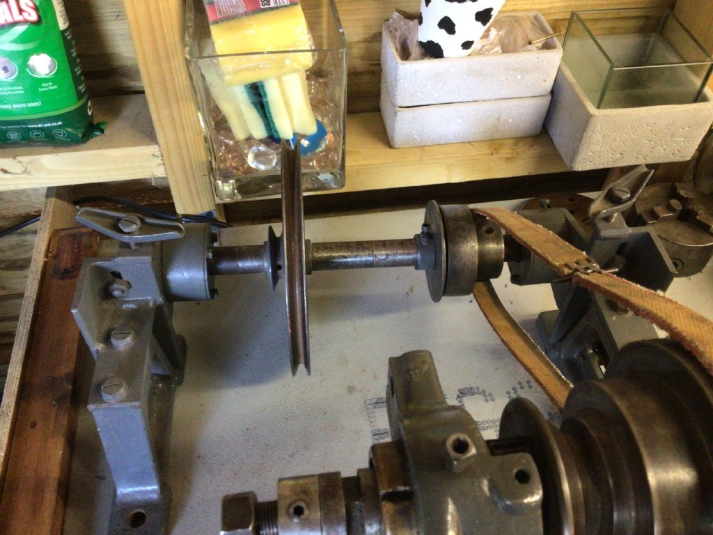

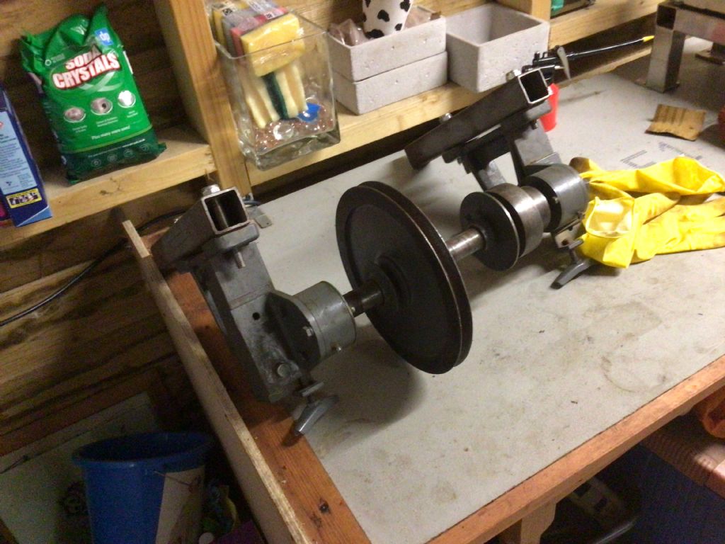

        Hi, thanks for all the reply’s.,
        when you say Back gear, do you mean the part with the very large pulley that the motor drives via a V belt and a couple of pulleys that drive the head stock…….I think what’s happened is at some point in its history a very substantial bench has been made for this ( I have it) and the lathe bolts to the bench and then there are all sorts of steel frames that bolt to the back of the bench to carry the motor and back gear..
        photos to follow… I’ll try and get them the right way up.

            Strictly speaking it isn't a wood lathe headstock just a standard one that has had bits sawn off. – the front part of the backgear guard and the rear arms for the layshaft. Headstocks do appear from time to time on ebay.. You can still get a lot done without backgear and some modern lathes don't have it nor the old Drummond roundbed.

                Strictly back gear is built into the headstock and uses gears not belts and pulleys. You can use a seperate shaft and pulleys to achieve a similar result.
                #614592
                Nigel Graham 2
                  @nigelgraham2
                  Haydn –
                  "Back-gear" is a low-ratio gearing on the headstock itself, used when extra low spindle speed is necessary, especially in screw-cutting.
                  Only, your lathe has lost it, unless it is all in the assorted bits that came with it.
                  The holes in lugs on the back of the headstock show where it may have been fitted -but the spindle seems to have nowhere for its back-gear wheels.
                  It would show as a large gear on the chuck end of the spindle, and a smaller one at the other end, but both inside the headstock. They would have been matched by two gears on a shaft mounted on rearwards extensions (bolted on, on this machine) of the headstock; with an arrangement for engaging / disengaging them, and for disconnecting the larger spindle-gear from the spindle to allow it to work.
                  That separate assembly with the pulleys is the Counter-shaft, acting as the primary speed-reduction from the motor, and carrying the speed-change pulleys. With the back-gear lost you could replace it by additional belt-gearing. It would be feasible to make a new back-gear, but not easy, and a lot of work – then you'd need make up a set of change-wheels either with additions fully-compatible with the existing ones, or all-new.
                  Unless you intend cutting many, long, large threads, it is perfectly possible and indeed not unusual, often even advantageous, to do so by slacking the drive-belts and rotating the spindle by hand-crank. Remember to remove the handle before using the motor again! Myfords do sell a mandrel-handle for their lathes but it won't necessarily fit this one. Various designs for making them are in the model-engineering literature, and can be adapted to the specific machine. The basis is an expanding collet a bit like a masonry-bolt.
                  It is sad to see an old lathe damaged by some previous owner, as appears here. It is very hard to imagine why he removed (and lost?) the back-gear, and cut off that lug on the front of the headstock. If it was to allow fitting a new belt-guard, the motive is good but the method poor!
                  I think the forked lug still at the other end was for a reversing-pinion used when cutting left-hand threads.

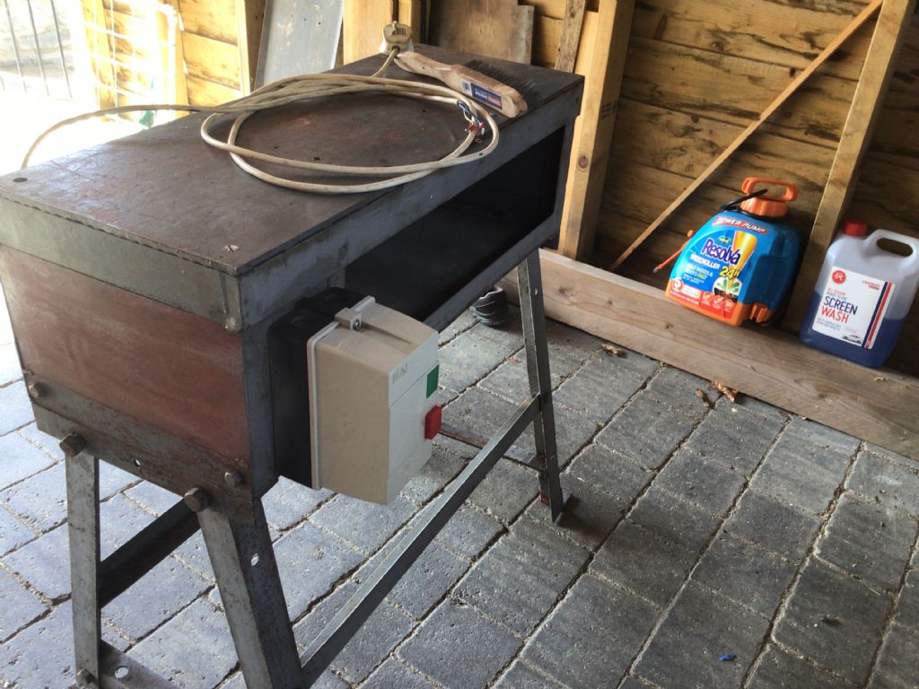

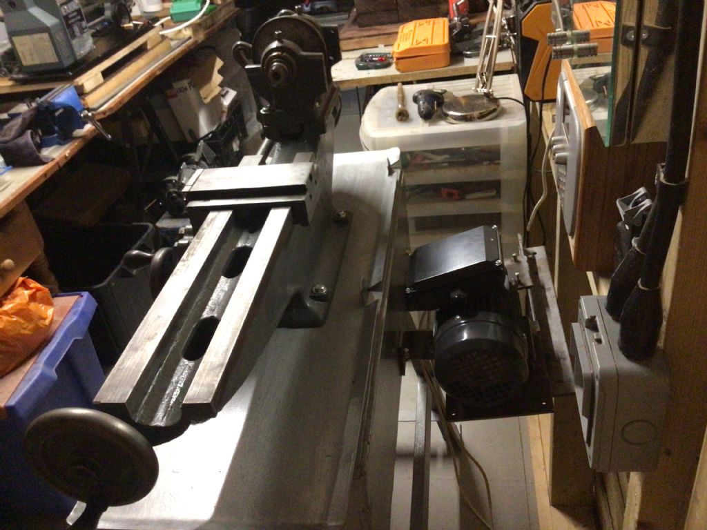

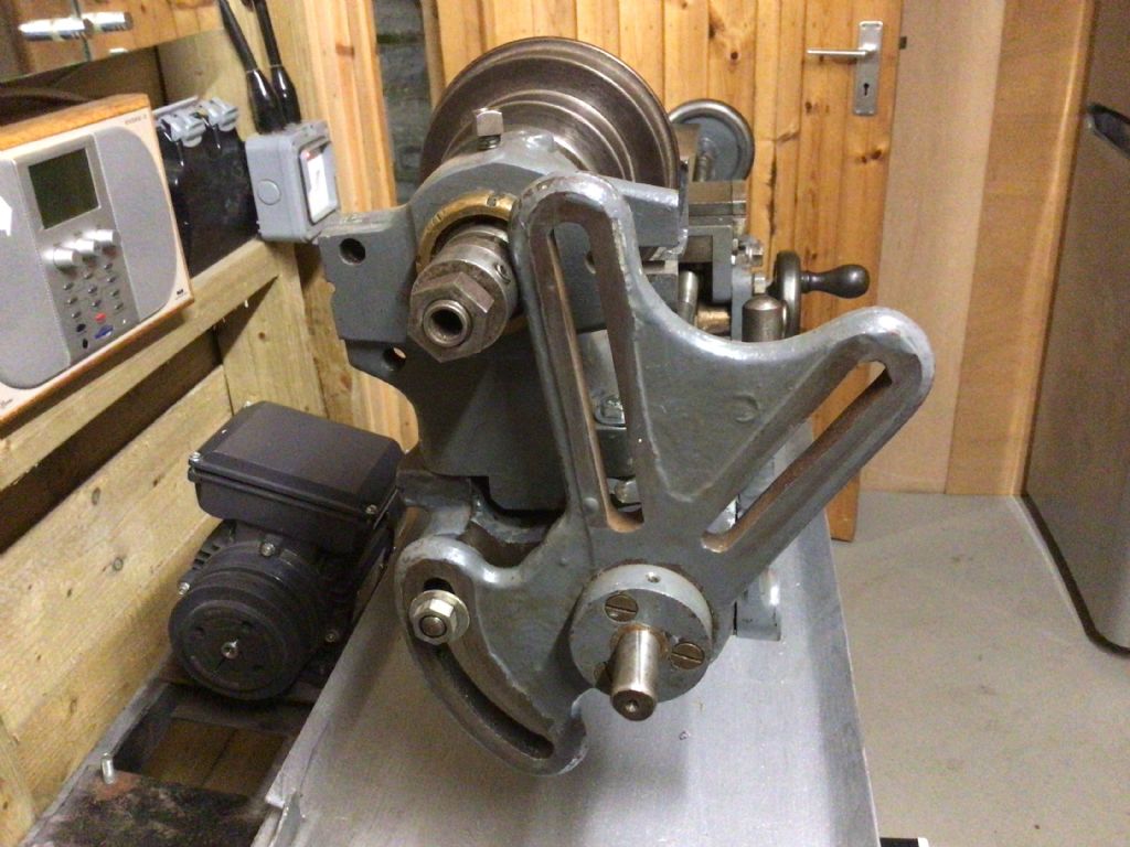

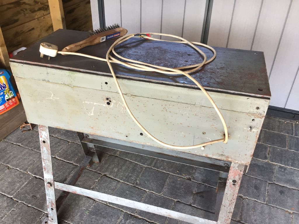

                                            28bbdc92-4da3-44ea-8172-444b0c53374d.jpeg0d2f33e4-f605-4572-8439-2225b09c59cc.jpegWorked out how the motor mounts onto the base unit. Now I have to work out how the (I think it’s called ) counter shaft is mounted….I should then get the lathe turning……the last photo shows the ( banjo ) where all the gears need to go to get the lead screw turning….I’m going to have to get a cog on the end of the spindle .a cog on the end of the lead screw and then try and connect them with other cogs….I don’t have any ‘axels ‘ to mount the intermediate cogs on so any photos or drawings would be a big help. thanks in advance
                                            #614800
                                            Haydn Callow
                                              @haydncallow19480
                                              Sorry , photos in wrong order…..

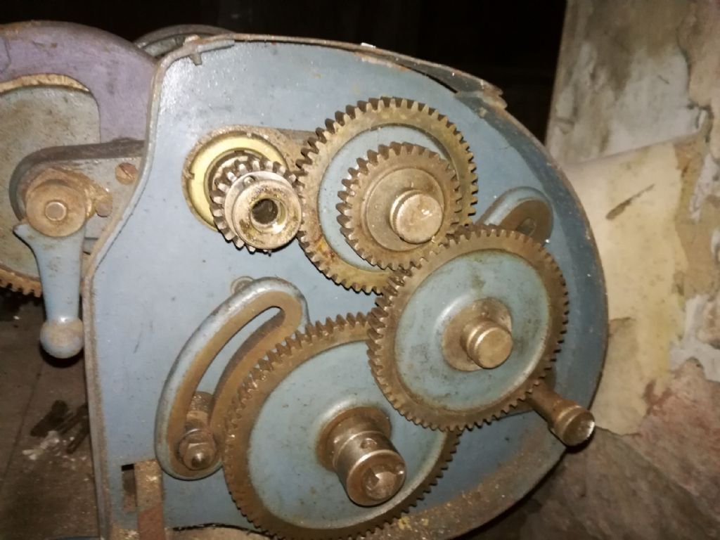

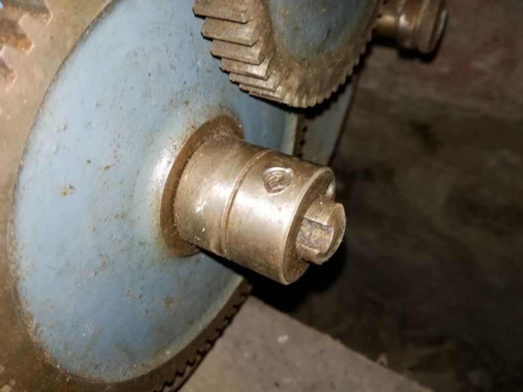

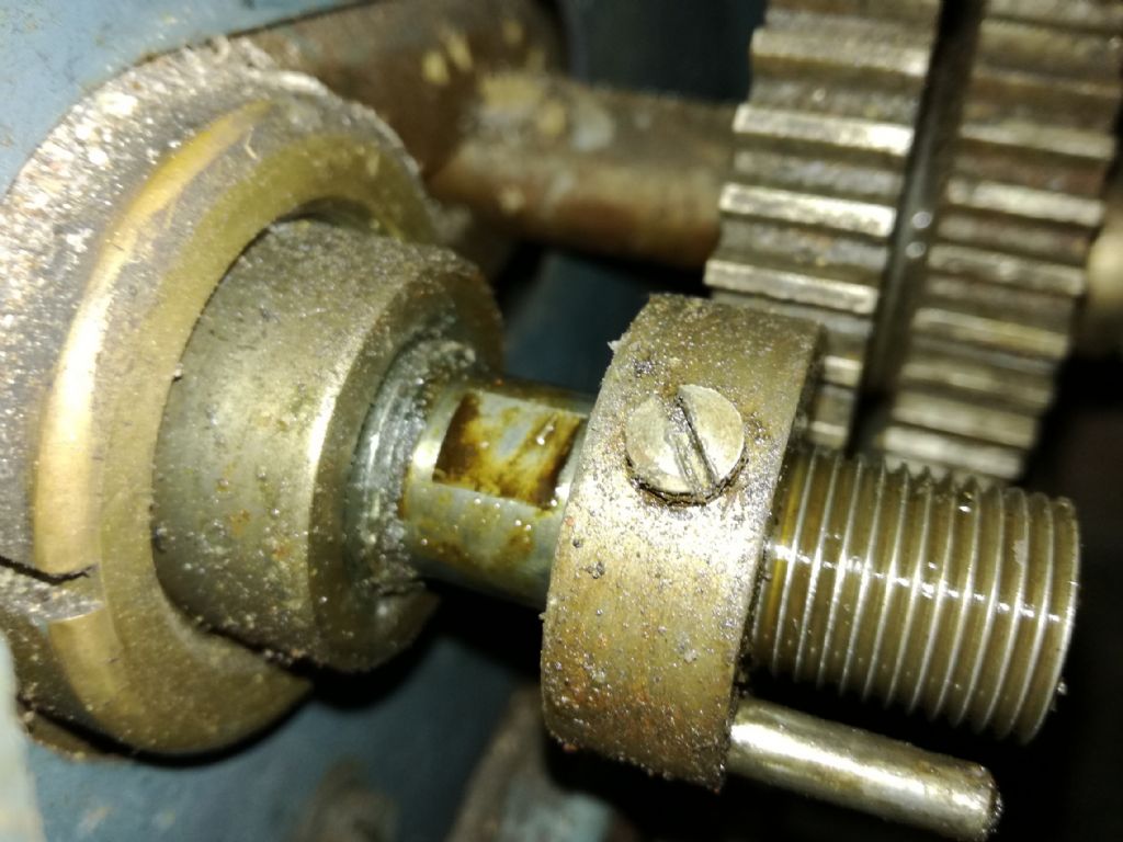

                                                Hi Haydn, three photos below, first is the Gear train, second is the Leadscrew end and the third is the Spindle end. None of the change wheels have a keyway cut into them and are all driven by two pins in all of the change wheel gears and the ones mounted onto the banjo, just have a straight pin to fit the bore of the wheels, just a tad longer the thickness of two of the wheels. The pins have a threaded portion, long enough to pass through the banjo with a nut and washer. The front of the pins are drilled to take a sprung split pin type of thing, fixed into the caps that can be seen in the gear train photo. There is a collar with two drive holes, same as the wheels on both the spindle and the leadscrew and these are held in place by a grub screw, the one on the spindle has a small flat and the one on the leadscrew is a keyway.
                                                Sorry, I forgot to take a photo of the sprung split pin and cap, but can do one on Monday if needed.
                                                Regards Nick.

                                                    looking at your very detailed photo of your gears/banjo…..my banjo looks a different shape to yours so what you have mau not be possible.

                                                      Hi Haydn, I think you'll find the banjos are the same, mine is just swung round clockwise compared to yours, anyway in the photo below I have shown the change wheel teeth numbers and the OD dimensions of the change wheels that are set-up on my lathe, I don't know why they are this way as it's just how they were when I bought the machine some years ago.

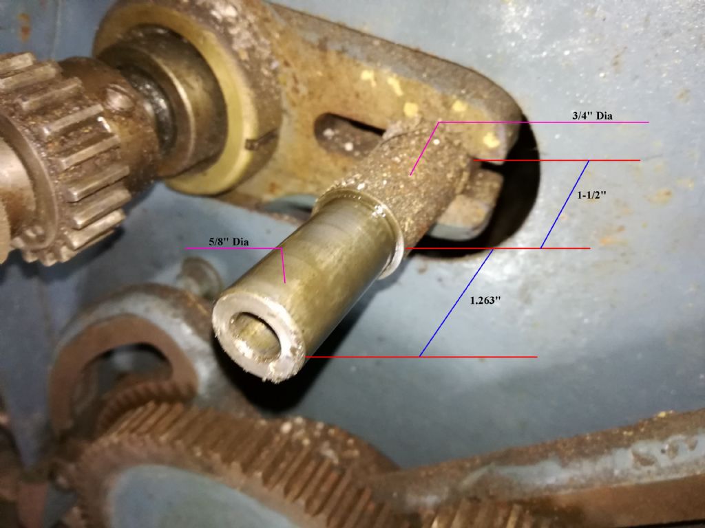

                                                      The next photo shows the extended change wheel pin that is mounted onto the fork on the headstock, which is carrying the 50 and 30 tooth wheels in the above photo and has the dimensions, with the exception of the screwed portion through the fork with a nut and washer on the other side, and also shows the hole which the sprung pin goes into.

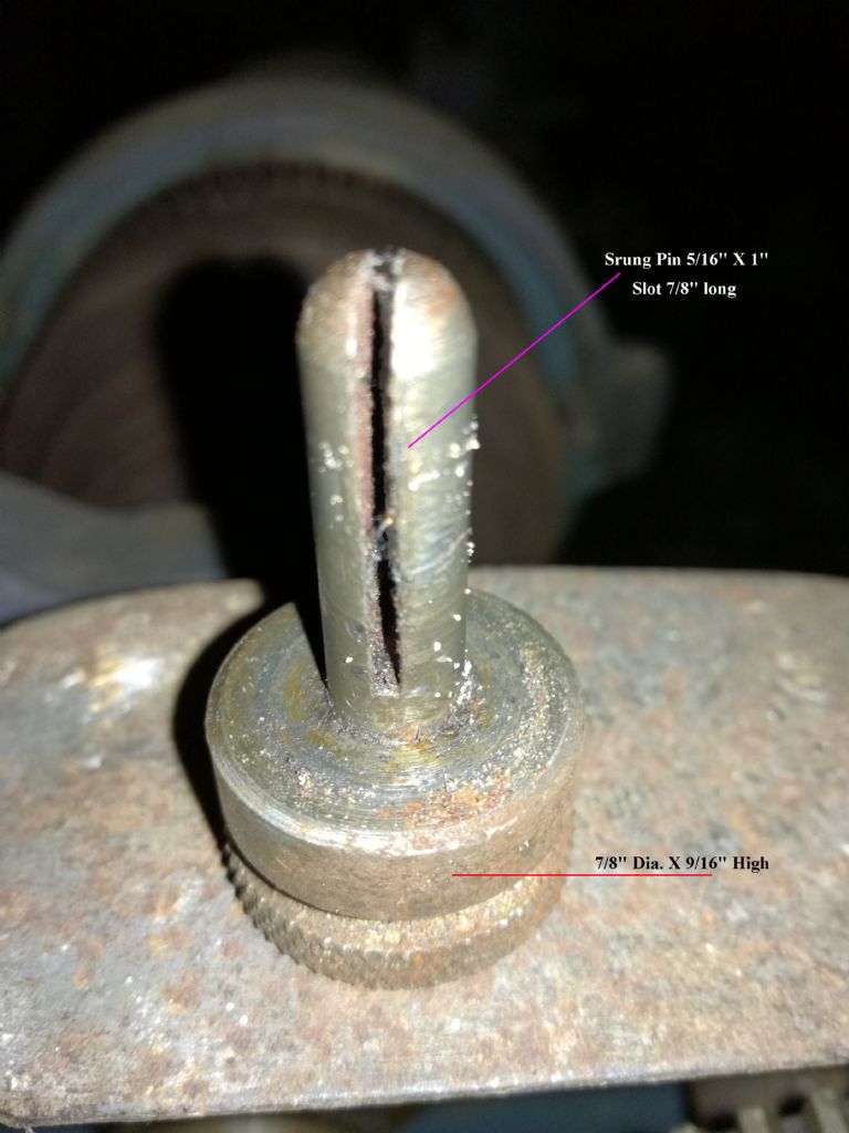

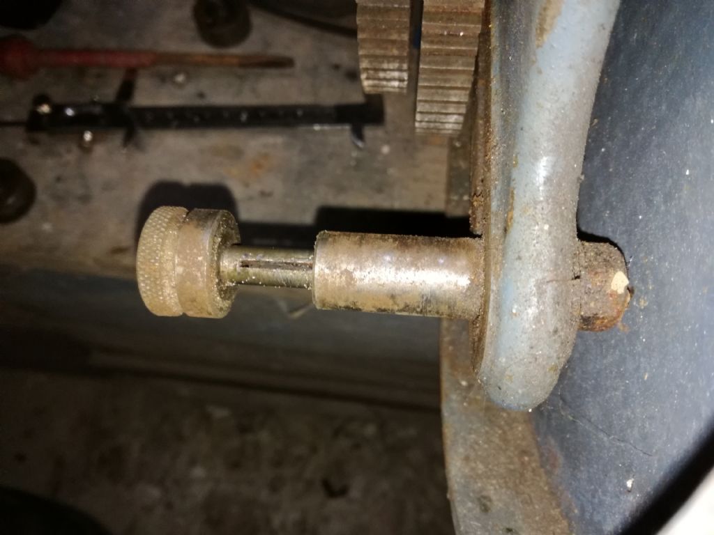

                                                      This is the sprung pin that holds the change wheels onto their pins, these appear to be turned from a sold bar and just slotted.
                                                      This is just an unused change wheel pin with the sprung pin just entered into the hole in the change wheel pin, which can be seen at the bottom-right in the top photo.
