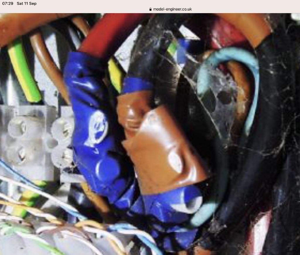

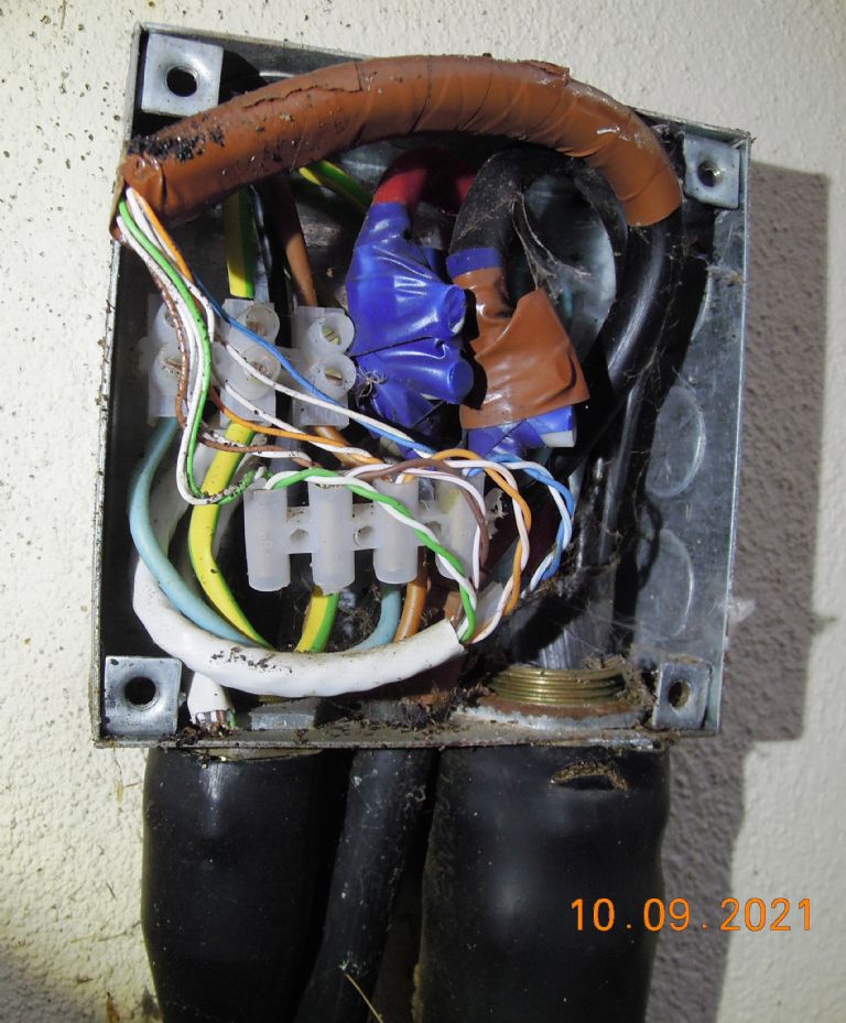

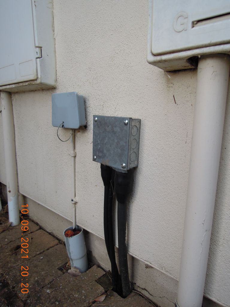

      Gents, connected with my thoughts and questions as to how to power my J & S 540, it suddenly occurred to me this evening that since my house was originally an industrial building, it may already have a 3 phase supply. A quick check of the meter cupboard suggested not.
      But then I saw a separate galvanised box on the wall with 3 big cables going into it. Could these be the other phases, just terminated I wondered …..

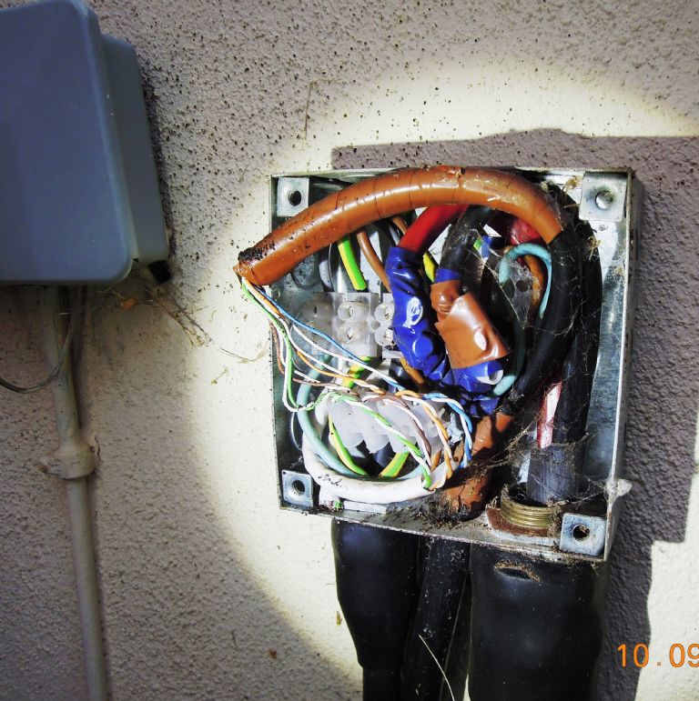

      I took the cover off and found this,,,,
      The first thing to occur to me was that the cover has no seal – hardly suitable for an outside junction box. But what were all the wires ? I didnt want to pull them all out as it looked pretty fragile. What I could see though was that the cable entering on the righhand side is comprised of thick cored red-sheathed wide and a thick black sheathed wire only. These go into the two screwed connectors wrapped up in blue and brown tape. After that I could not make out where they go but they 'may' go off to the left hand cable. This 'might' be a connection to my garage consumer unit but without untangling the mess I cant be sure.
      Filling the rest of the space in the box is what looks like telephone wiring which appears to come from the central black cable, Some of this 'telephone wiring appears to disappear into the wall behind. The strange thing is there is already a telephone junction box just to the left of this one. I mystified.
      To me this looks wrong on a number of many levels – unsealed, mixed wire sizes, crammed in like sardines… even the cover lip has been bent to help it accommodate the thick cable sheathing on the right side.
      I think I need to get this investigated and tidied up. Your thoughts ?

          Gerry, don't take the cover off the GAS meter box – you wouldn't sleep at night if the same DIYer has meddled inside that one !!
          Its interesting the comparison between the size of the mains incoming cable to the house that is so much smaller than the pigtails from the company fuses to the meter.
          The last photo of the mix of telephone and mains cable – Oh dear! I hope you don't use a wired telephone in the workshop. Also that the telephone wiring in the house which feeds that box has been or should be disconnected.

            That’s the stuff of nightmares, Gerry …
            Even the ghost in the blue tape looks frightened.

              The grey cable lower left is a CAT5 data cable with the four twisted pairs separated out from it. The rest is just frightening I hope it's not live. Urgent visit from electrician probably required.

                      At a guess it a network and power feed to a shed or garage. Whatever it is it is WRONG.
                      1/ Box should be sealed.
                      2/ Data and power should be separate.
                      3/ Choc blocks are not OK for data or for poer in an unsealed box.
                      4/ wrapping choc block in tape just traps any water that may get in making it worse than without tape.
                      You need to get that looked at by someonewho is competent and has cable tracing equipment.

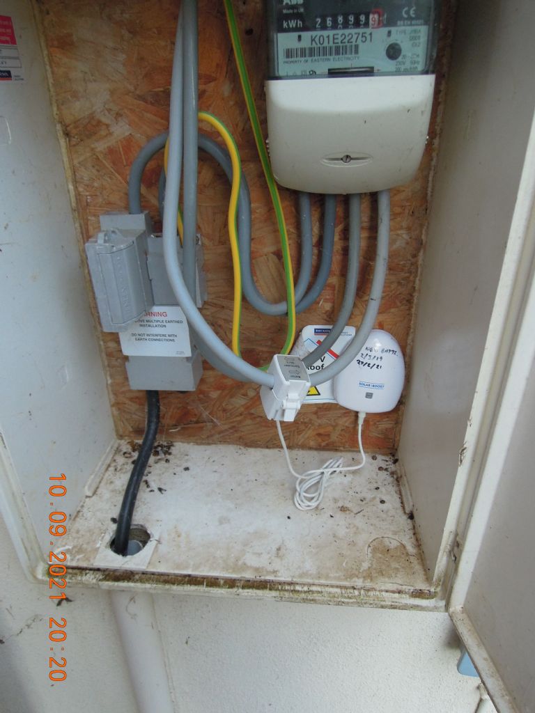

                          Your meter box is a standard single phase incoming cable and meter box. The supply is the PME (protective multiple earth) configuration. The adaptable box horror show does really need sorting out and determining if it is in current use. You may find one end of the cables at your consumer unit and the other in your outbuilding. If the twisted pair cables are part of a telephone or network system then they really should be separated from the mains cables if that is what they are. Try to resist the temptation to replace the lid and forget about it.

                              Also the meter and cutout are unsealed, suggesting someone has been tampering with them. I would contact your supply company before they think you have removed them.
                              Both should be sealed with the supply authorities seal to prevent tampering.

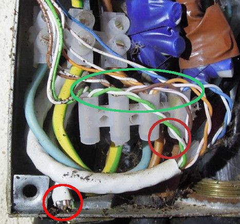

                                      The exterior box seems to be an extreme bodge! Maybe the picture is misleading but it appears:
                                      1. The green ellipse shows the data cable pairs are shorted together at the choc block , converting an 8-core into a 4-core cable.
                                      2. One side of the data cable appears to be cut off inside the box – see red circle in photo
                                      3. The choc block appears to show the three of the 4-ways are connected to Earth, and Neutral. The live wire inside the Brown Circle seems to have come out of the choc bloc, and may be dangling.
                                      I guess the wiring is all mains and a naughty bodger has substituted data cable for 4-core mains cable, and then forced everything into a too small interior box rather than buying a slightly larger waterproof junction box. If so pretty yuk.
                                      Another guess: the power goes to an adjacent shed or garage, and the 4-core is for switching a light from either end of the path, a variation on this:
                                      Might be able to confirm this by looking for similar wiring in a nearby sheds.

                                            gerry madden
                                              @gerrymadden53711
                                              Thanks again all respondents for your comments and good advice. This is such a useful group of experienced people always ready to help !
                                              I 'think' I might have solved the mystery. This birds nest of a junction box is likely be a feed to the garage plus a feed to an electric gate system on the far side of a plot adjacent to my house. The latter have never been used since we moved in 8 years ago and for that reason I had completely forgotten about them! They weren't used partly because I have no need for such impediments in my life and partly because they didn't seem to function well when the builder tried to demonstrate them to us. I think we see why now The data cable/ telephone wires probably go to a control box which is on the wall inside the house. Not only have I not used this, I haven't even seen it for years due to the growth of a large plant in front of it !
                                              One wrinkle in my theory is that when I trip the RCD for the 'outbuilding' on the consumer unit, the garage electrics are non-functional but the gates control box inside the house and the camera on the gates 100 yards away are both still functional !!! Clearly further investigations are needed to establish the the ins and outs of the junction box outside and to find a way to isolate the gate part of it.
                                              John H, my iboost has been excellent with no trouble since it was installed just under 7 years ago. I actually had the control box installed next to my consumer unit in my in-house workshop so that I could easily keep an eye on proceedings. So far its dumped about 17MWh into the hot tank since installed. I was actually expecting to have got through a few heating elements by now but this has survived too. I suppose that shouldn't be a surprise as most of the time its operating at low power levels.
                                              Thanks again all for your thought provoking stuff.
