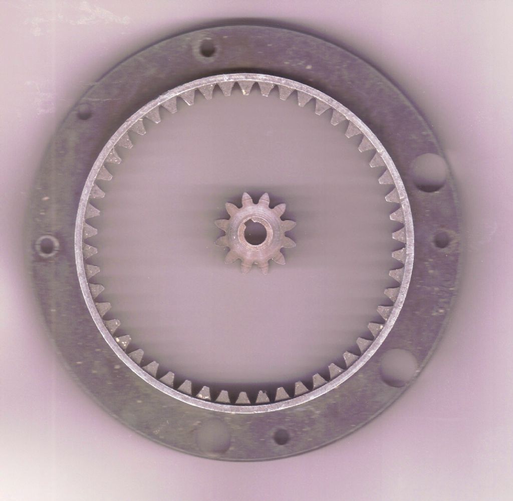

      Having just purchased a nice internal ring gear I was thinking of building a version of Elmers hypocycloidal engine. Would I be right in thinking that the internal cog has to be exactly half the size of the external ring gear. Only the small cog that I got with the ring gear is only about a 1/4 of the large gear.

          Small one should be half the number of teeth of the larger gear.

            I have just tried to cut the internal gear for the ring I have and failed miserably. To be honest I do not have the skill or the equipment for this task. The ring I have is about 3 inches diameter with 50 teeth, so I need a 25 tooth 1 1/2 inches diameter gear. Is there anybody out there that could cut me one for a fee , or my project does not get of the ground.

              If you know the spec of the gear eg DP or MOD so should be able to get one from the likes of HPC for about £20

                  When you say about 3 inches and 50 teeth, is that internal diameter? For a module gear (i.e. metric) 3 in = ~75 mm; divide by 50 would give module 1.5 which sound reasonable and standard. But 3 inches/50 teeth is 16.67 DP, I'm not sure that is so standard (JS would know better).

                    No idea what you mean by DP or MOD, there are no markings on the ring. If someone was going to make me a cog I intended to send them the ring to work from. Perhaps it would be better to buy both as a set, if I new where to get them.

                        Put it on a flatbed scanner, and post the image here; together with a measurement of the diameter [for scale].
                        I'm sure that, between us, we can work out what DP or Module it is.

                            Measurements : Between the teeth (peak to peak across the circle) 77mm. Between the teeth (valley to valley across the circle) 83mm. Outside diameter 114mm.
                            #236728
                              With internal gears the calculations are essentially as if you were measuring a normal gear that would 'drop into' the external gear.
                              83 / (50+2) =~ 1.6 MOD
                              83mm = 3.268"
                              (50+2) / 3.268 =~ 16 DP
                              16 DP is the more likely.
