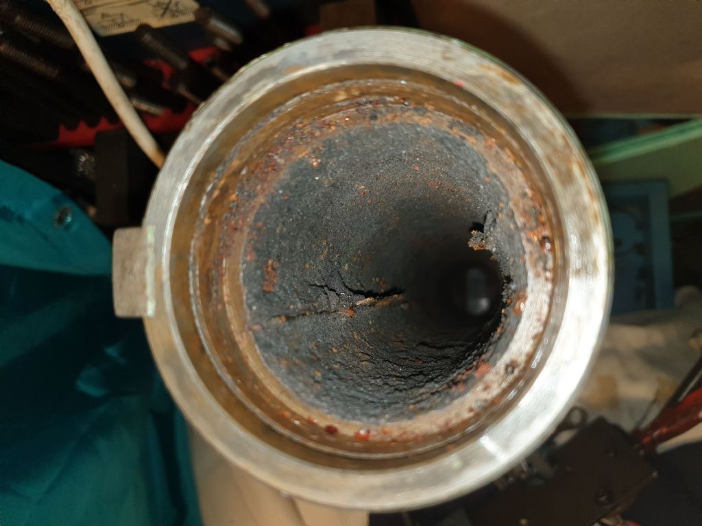

      Not being able to use my mill at the moment I took the feedscrew off to start adjusting the fit on the column and found this. 20190706_153002.jpg
      So it looks like Gray hit the nail on the head and the column is cast. It does seem reasonably substantial, the machined part is 6.5mm thick and the rough cast area about 10mm.

        If all you want to do is change the resonant frequency could you fill the column with fine dry sand and give it a few months to compact down and then top it up again ? Maybe some sort of manual compaction as you fill the column might speed up the process ?

          If you have a problem with a resonance occurring in the running range, it needs to be tuned out, ie changed.
          It can be tuned to a frequency below that of the running range, or above it.
          To tune the resonant frequency upwards, the stiffness needs to be increased. Bracing, or thickening the column may go some way towards this. Although thickening may well increase the mass and have the opposite effect.
          To lower it, the stiffness needs to be decreased, or the mass increased.
          If you have a STRONG bench, pour molten lead into the column of your machine?
          High frequencies can be absorbed , as in straight through silencers for motor cars. Low frequencies have to be lowered by increasing mass, or softening the suspension, such as low Shore hardness rubber mounts.
          If you have ever seen a system when the exciting frequency approaches, passes through, and then retreats from the resonant frequency, you realise that the dynamic magnifier graph has a very sharp spike. 50 rpm either way and all will be quiet, but at the resonant frequency the amplitude of vibration increases at an almost incredible rate.

            Hi Dave,
            Although the cast iron is reasonably thick, it needs to be given the duty it is being asked to do. While it is a good bearing material for machine tools and lovely in compression. In tension and torsion it is not so good, hence the thickness.
            Another problem with cast iron is the nature of the material can change through the casting. Far better results would have been had if the part had been a spun cast tube.
            This is one of the reasons I suggested a stud down the centre under tension. It would give additional strength to a cast iron tube by holding it in compression and thus balance out any bending moments due to machining and drilling. Plus any bending moment due to the weight of the overhanging milling head. It would also improve the torsional resistance.
            By stud I am not thinking a piece of Screwfix 12 mm, what I had in mind was 25 mm diameter EN24T. It cannot be larger than this as it will not pass up the mandrel of my lathe. Some fine threads on the end would allow a reasonable torque to be applied, (yet to be worked out).
            Adding this stud should also tune out some of the natural frequency mentioned above. One other thought that crossed my mind while thinking about this mod on the steel tube of the Emco, was to fill the void with oil under pressure. The pressure of the oil could be altered to increase the tension on the stud or lowered to reduce it. I would not advocate trying this on a cast iron tube.

              Yes I think keeping the iron in compression is the best idea. Any internal pressure from either expanding filler (setting /thermal) or ramming is likely to burst the tube.
              There is one possible problem of doing this on the ZX-16. From the drawings the tube mount to base is not the same as the FB2. On the ZX-16 it clamps to the top of the base casting, with the end of the tube directly in contact with the base. So to add the stud would mean drilling through the base casting and using a plate to spread the load
              The vibration I have seen is not due to resonance. I have run the mill at a low speed with a large 2 flute and have seen the head get shunted sideways about 2mm
