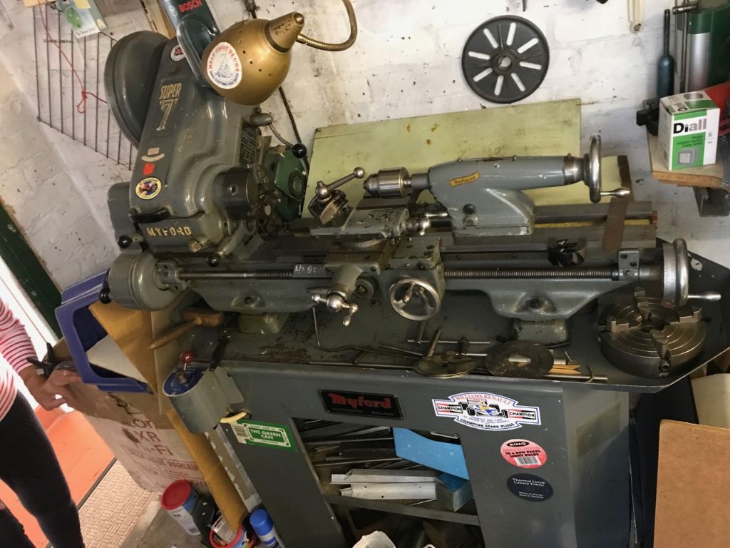

      Hi,
      My late father had a super 7 lathe with cross feeder and stand as can be seen in the photo. Nobody else in the family would really use it. I am trying to figure out a) how to sell it and b) how to transport it to the eventual buyer. We are in London but including the stand it is quite a bulky item…

          Hi David sorry to hear about your father but the lathe looks a nice piece of machinery. You can post it on this web site or others under classified but a few more pictures would help, close up of the bed and if you were to lay out the spare chucks and other tools it would help. As to moving the lathe it is easy to unbolt the main lathe from the base just four bolts and disconnect the wire to the motor, take a picture of wire connections before. There are movers who will come and move it for you at a cost ie Landylift or others or just post it as collect and move at buyers expense.

            I moved almost exactly the same kit with just an ordinary hatchback and roof bars. The cabinet went on the roof bars (not that heavy once separated from the lathe. ). I borrowed a small engine crane (500kg) to lift the lathe into the car, this then folded up and slid in alongside so I could unload once home. I recon 2 strong people could lift the lathe if you take off the tailstock & motor, I'd leave the saddle on but removal is an option to lighten further. Personally I'd let the buyer have the hassle and sell as pick up only.

              Selling it is easier than you think – it's the most popular lathe out there for model engineers so there will be lots of potential buyers. Use homeworkshop.org.uk which is free to sell on and you don't get time wasters. Or use the classified section on this forum. Or both.
              If you want to get the highest amount for it use eBay but more likely to get time wasters. If you don't have an eBay account maybe use a friends account. Whatever way you go take some nice photos and describe it well. If you say to a buyer you know nothing about it they will try to knock the price down.
              The solution to moving it is simple, just let the buyer organise it and come and collect it – that is pretty standard. You don't need a professional mover for a Myford really. 2 fit men can lift one a short distance or use a sack barrow and they fit in an estate / 4×4. If you don't want to get involved with moving it leave it to the buyer.
              Price would be between £800 and £2000 depending on condition and tooling / accessories – it looks nice in the photo. So it's worth making an effort with it.

                That looks like a nice lathe there. The only thing to point out is that it doesn't have a power cross feed as you have implied.
                It won't make that much difference to the price but it is worth knowing when preparing the advert.

                          However back to the Myford which I am sure was Dad's pride and joy, as far as value its difficult to be precise but it was probably made around the 1960's you can find the number on the lathe bed usually near the headstock and look up the date on the Myford web site.
                          The machine has a longitudinal travers but not a cross traverse, price is governed by age, condition and whats with the machine. For yours IMO age is good, condition is difficult to ascertain from the photo but it does look good and clean, one downside is it hasn't got a gearbox – not essential by any means but very desirable but so is the machine.

                            Posted by Steamer1915 on 12/06/2019 08:36:57:
                            Maybe, as a non-modeller/machinist, he only meant ‘cross’ as being from left to right?

                              Quite so – I was merely clarifying for other non-modeller/machinists…
