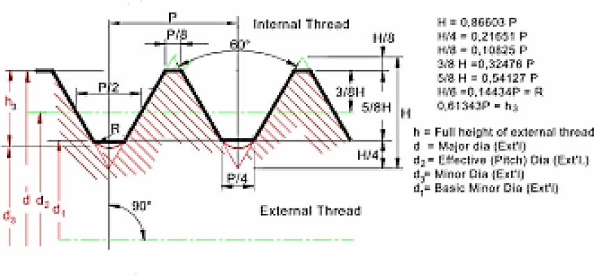

                              It's interesting to look at the usual rule for tapping drills on metric just subtract the pitch.
                              If that is used m2 would be drilled 1.6mm. Above says the core diameter is 1.567mm. So a 1.6 drill give a bit over a thou clearance. Sounds great before both the drill and the tap are measured.. Drills usually under size, taps over plus brass effects – the drill tends to cut a hole much closer to it's size, The other aspect is those sharp corners usually shown in images like this. The actual tools are very unlikely to have them. Clearing any rads makes a big difference to the effort needed to tap a hole. It's extremely noticeable on BS threads.
                              frownI reckon all of the taps and dies I used during training must have been H6 and ground thread maybe even 5.

                                I tested the non serial taps on a piece of 1.5mm thick brass. I had to drill a 1.9mm hole and just the tip of one tap passed through, the second one less so and the third one not at all. I actually did identify them correctly by eye before conducting this test ! I then marked them by putting the taps in the lathe chuck and gently making circles on them with a parting tool ; just enough to mark them with one, two and three circles similar to the serial taps.
                                I drilled some 1.7 and 1.8mm blind holes in some brass then tapped them using both the serial taps and the new taps. 1.7mm is okay but 1.8mm seemed a bit loose. I will use the 1.7mm drill bit as my standard tap drill for now.
