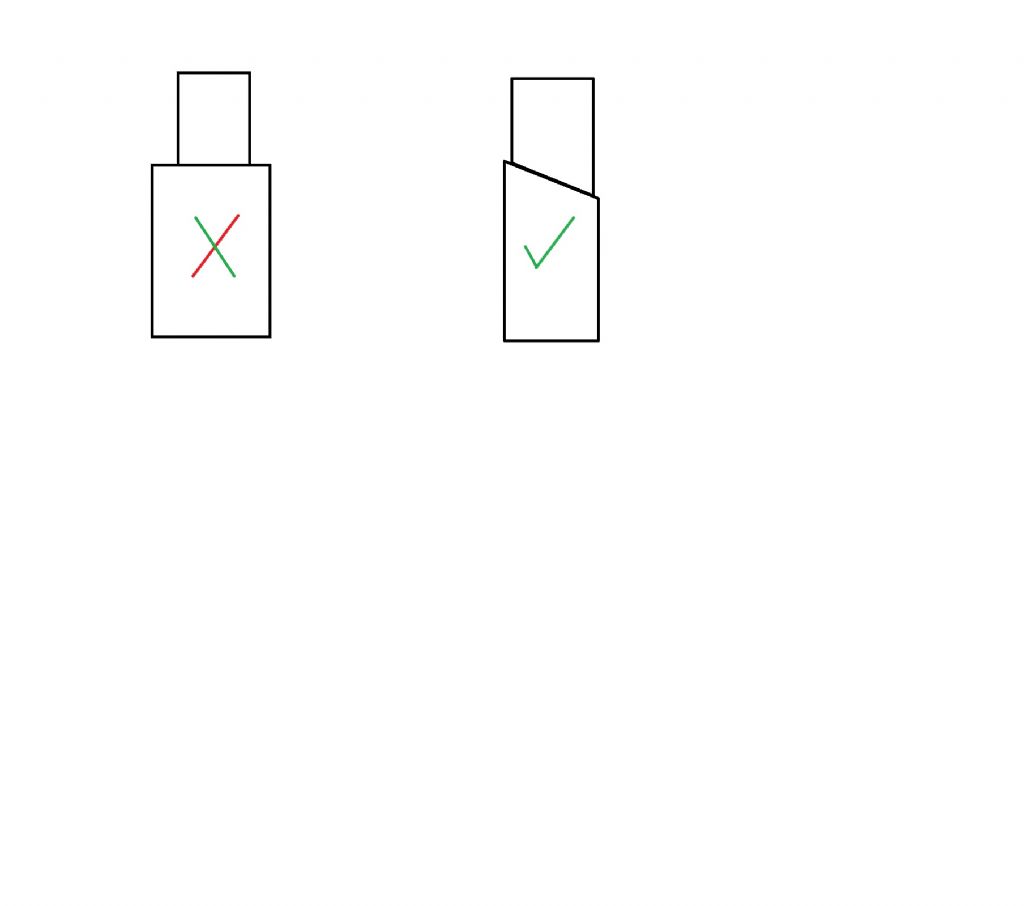

        Hi,
        Quite busy at the moment but I have decided to have a go at making a mini project for an Airfix kit to make a base out of nylon for an aircraft.(An F86 Sabre swept wing, incase you're wondering)
        It will consist of a large round base and a shaft to make it look as though it were suspended in flight rather than parked on a runway so to speak. The shaft will have a small step that will connect to a drilled hole in the plane.
        However, I don't want the step to be square, so that the plane is parallel to the horizon, would look rather boring. So I want the step to be lop sided so that the plane looks as though it's banking off to one side, to give it a sense of movement.
        This seems like a slightly peculiar operating challenge to cut accurately so i'm wondering if anyone has done it before.
        Michael W
        #286255
        MW
          @mw27036
          Just as an example to help you understand;
          #286256
            Turn end square and drill a hole the dia of your spigot.
            Cut end of stand to desired angle
            Loctite bit of rod into the hole
            You now have a spigot with an angled shoulder.
            Edited By JasonB on 27/02/2017 12:36:32

              So what does the angled shoulder achieve?
              Tony
              #286264
                Meets the fuslarge at a matching angle so you don't get a nasty looking gap on one side

                  Thanks, yeah the more I thought about it I realized that it's practically outside the spectrum of a single turning operation. So i'll do as you say and fabricate the two bits together.
                  I don't think i'll be able to Loctite it (I heard it doesn't like sticking to plastics!) but the thread doesn't need to be fixed so long as it's secured.
                  Also for Tony, The panels of the plane itself are not thick enough to accommodate an angled hole, so it'll have to be down to the stand to set the angle.
                  I would also like to be able to dismantle it from the base if I need to so I don't want to glue it down either.
                  Thanks again for the advice.

                    Surely if you use the stand that you have ticked, the plane will still sit horizontally, due to the spigot being at 90 degrees to the floor.
                    If you need an angled shoulder for the plane to sit on then the spigot will need to be square to the angle.
                    #286271
                    Journeyman
                      @journeyman
                      May need to insert pin at an angle using Jason's method, per No. 2 in sketch
                      To fit the body a bit better…

                        Posted by Journeyman on 27/02/2017 13:46:51:
                        Yep, I think that's cracked it, I suppose method 1 could distort the shape of the hole so option 2 would make for a better fit and help keep the hole snug to the pin.

                          If the hole was drilled into the plane at and angle then option 1 would be OK. But you have now mentioned a screw and that would need drilling as per Journyman's option 2 to work.

                            Just bend the shaft with a nice sweeping curve to whatever angle you need.
                            Curve will look nice and not all angular

                                I'm with JS. I used the bent shaft method to mount Spitfire and Hurricane models on a single base and gave an appearance of a close formation banked turn. The bend was close to the top.
                                I also made a small top hat plug to fit in the aircraft fuselage to add strength where the shaft fitted. Sorry no pictures, it was a few years ago.
