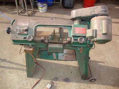

      Bought a Nutool bandsaw some weeks ago to save my little heart from any strain cause by hack sawing away for hours
      It was secondhand but fully working but in need of a good clean. I had to use my nail to clean off the nameplate. So there’s a good saw underneath but I need to clean off years worth of accumulated sawing dust.
      Ultimately I would like to give it a refurb and carry out some mods I read about in an old MEW I picked up so that will be a new lick of paint.
      But until then a good clean will have to do. What can I use to clean off the metal dust ?

          Buy a litre of white spirit and a couple of small brushes and if you are going to strip it down place the parts in the white spirit to soak for a few minutes. This will soften all the detritus and it can be brushed off.
          To get rid of the white spirit, dip the parts in a bucket of hot water with a little washing up liquid in it and then rinse in hot water.
          You can then use a hot air gun to dry the wet parts, beware of getting too close with the hot air gun.
          If there are large parts to clean then use one of these high pressure water jet machines that are available.
          This is our standard measure that we use for cleaning up parts in our Instrument repair shop as some of the instruments come on covered in unmentionable muck.

            I’d get a couple of litres of kerosene/paraffin and give it a good scrub with a stiff brush, hose it off, then leave her out in the sun for a few days. Thats the Australian way, if you’re somewhere else, a local may offer better advice.

                Take off all electrical bits. Get some cleaning fluid, sold in car spares type shops, Gunk or similar. Brush well in with old stiff brush, leave for a few minutes, pressure wash. If no washer just brush with plenty of water. Inspect and repeat if needed. This will clean like new.
                #71784
                John Coates
                  @johncoates48577
                  Ah well I have the white spirit, gunk and a pressure washer (100 or 120 bar) so the job is on. It is a floor standing horizontal/vertical jobbie not a bench top one.
                  I’ve tried searching for a manual as once I’d cleaned the label up it gave me the band size and the three speed ratings. The bloke I bought it off said these related to the material to be cut and that adjustment was done by a longitudinal screw along the axis of the machine but I’ve got no idea how to adjust it. I also need to know the lubrication points.
                  IIRC I think it says it is model type 159 (?)

                  John Coates
                    @johncoates48577
                    Here it is

                      Dave, here in the UK Kerosene and Paraffin are as expensive as veh. fuel if you can find it.!
                      There is a white oil that is sold in garden centers for greenhouse heaters but it is also expensive.
                      We settled on the white spirit because it is the cheapest and we can filter it for re-use.
                      Everything else of a volatile nature is too expensive for cleaning purposes.
                      The only thing about white spirit is it affects rubber based components and these we clean in detergent only.
                      The whit spirit dissolves hardened grease and even silicone grease so it is quite versatile.

                        Hi Folks
                        I use white spirit when I am not going to immediately continue to machine or work the parts in some way as white spirit contains oils that help prevent further corrosion. This is of importance to me for machinery during a strip down or cleaning prior to assembly. I have never had the need to remove the oily film other than in preparation for painting where I have always used the thinner/cleaner for the paint process being used.
                        Paraffin on the other hand is a fuel and is refined so that it contains little or no corrosion preventative free oil. If you store paraffin in a steel tin it soon rusts out the bottom even with the cap in place. The same remark applies to petrol as a cleaner but there is a real risk of explosion of the vapour in the confines of a workshop. I do not know how diesel performs as a cleaner as I hate the smell!
                        The likes of Jizz – Gunk and industrial detergents are good but require post treatment to keep rust away. There are numerous small parts washers at bargain prices if you have a lot of this sort of cleaning to do. They have the advantage of a pumped supply of fluid which is reused after filtering. I use mine as a lathe and mill coolant system and only fill with cleaning fluid when needed. Being a one man band I don’t need to do both at the same time.
                        Regards – Pat
                        PS John – you might consider the parts washer approach if you need to supply coolant to the saw during cutting of heavy sections.  Draper – Screwfix and other do cheap (£40 ish) parts cleanrers comprising a small tank and pump.

                          It is a standard Far Eastern 150mm x 100mm bandsaw as sold by Warco and others. The only lubrication point is the tensioning wheel inside the left hand end. Open saw safety cover to view. You can remove the lid of the gearbox, keep it as horizontal as possible, usually filled with thick oil. You can put a little light oil on the tilting “bearing” at the right hand end. Guide bearings are sealed. Not much else to do, do not over tension blade, just sufficient to stop the blade slipping, adjust the balancing spring to give a “reasonable” weight to the blade towards the job.
