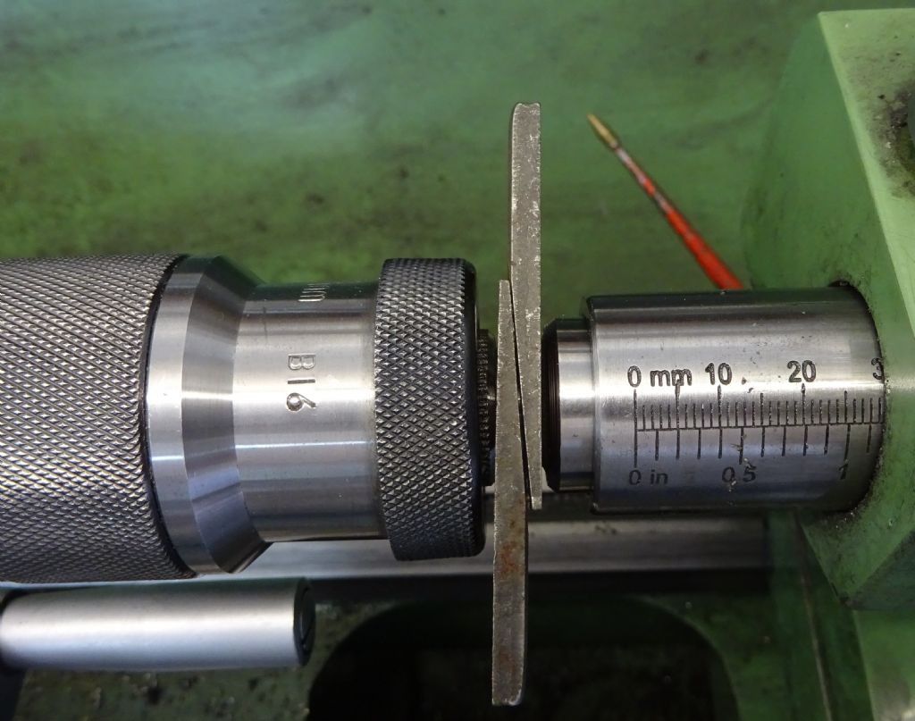

                            Not sure why the wedges should make the MT let go as they act against the back face of the chuck and the large end of the MT taper not the nose of the spindle?

                                            When separating chuck from arbor the forces are between chuck and the B or JT taper, the Morse has nothing to do with it, Will post a pic a bit later to show how the wedges act in use.

                                                    #300790
                                                      Drill chuck wedges in action
                                                      The wedges fit between the back of the chuck and the large end of the MT taper.
                                                      As you can see they apply no force against the MT taper and its socket so when in use the B or JT taper will separate, infact they should be used with the MT removed from the tool unless it is a drill press with integral B ot JT male end to teh spindle.
                                                      Posted as Micheal was also posting
                                                      Edited By JasonB on 02/06/2017 08:14:01
