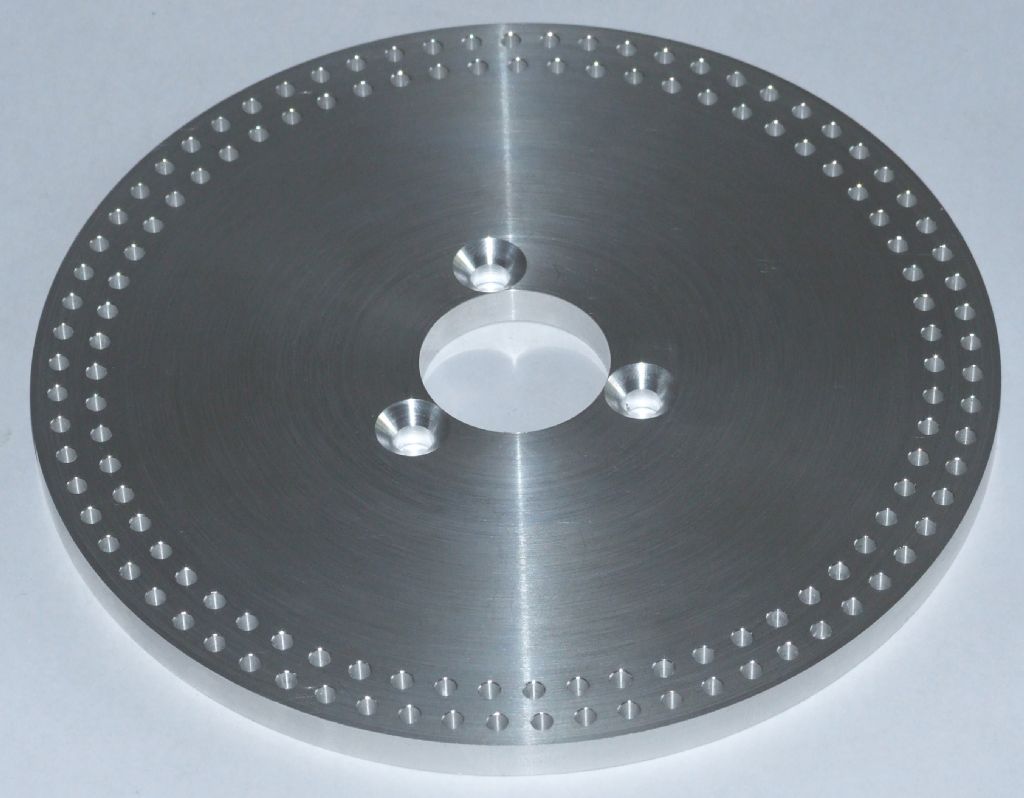

                                    I might be inclined to ‘chain drill’ away the excess material.
                                    Basically do as John S says with a hole though the middle and bolted down – but still able to rotate. Then drill a series of holes around the circle/arcs and other shapes, as close together as you dare, but without overlapping. It should look like a row of holes from a dividing plate, but more closely spaced if possible . See here: http://www.model-engineer.co.uk/wp-content/uploads/sites/4/images/member_albums/70420/dividing%20plate.jpg
                                    This removes the bulk of the metal quickly and allows you to use a coping saw to whizz around the profiles to get the waste out of the way.
                                    With some forethought you could cut off the waste from the outside and return the part to the machine to clean it up by milling.
