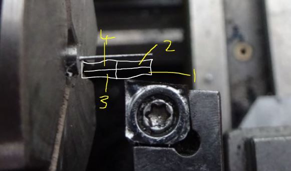

            #361340
              Dave, don't try and do it all in one length, get the end down to dia and then another two cuts to bring the rest down the same
              #361343
              Hopper
                @hopper
                SOD, the tool bit in your photo has "blunt" geometry. IE, even when it's sharp, it's not sharp. The side rake on the top surface is not very great, maybe 5 or 10 degrees. It would cut better if that top surface were angled at closer to 20 or 25 degrees to make a really sharp knife tool profile. A bit of back rake on the top surface would help cutting action too.

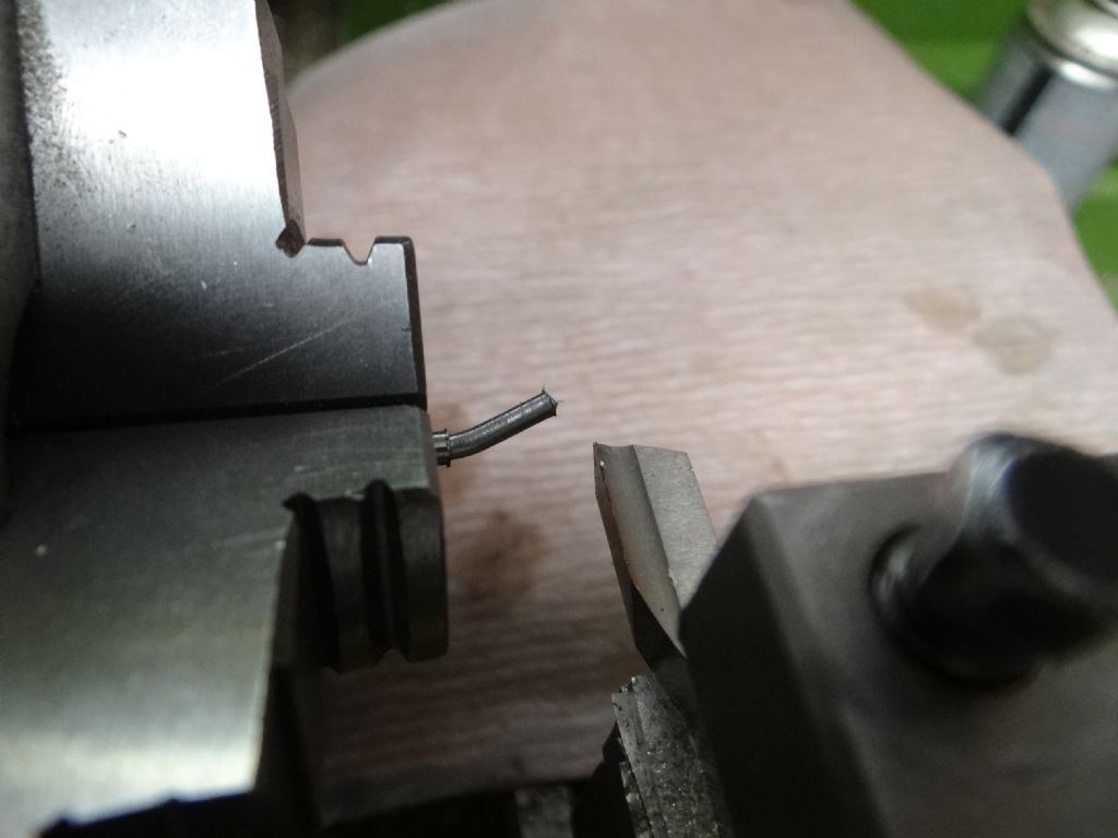

                  #361365
                    Well I'm improving. Too hot to grind a better tool but with care I got down to 0.5mm x 10mm in Silver Steel. Some of my trouble was due to the rod being slightly bent, the rest was poor technique. The finish is dreadful, but I hope sharper HSS will fix that.
                    However, I'm still not happy. As Duncan says, swarf breaks the rod – it's very delicate. Be interesting to see if heat treating makes the steel stronger. As it is I'm not impressed by slim silver steel because it's nowhere near as strong as a needle. Not sure it will stand up to drilling.
                    Too hot to do anything. I may collapse with a book and cider in the shady part of my garden and have a nap.

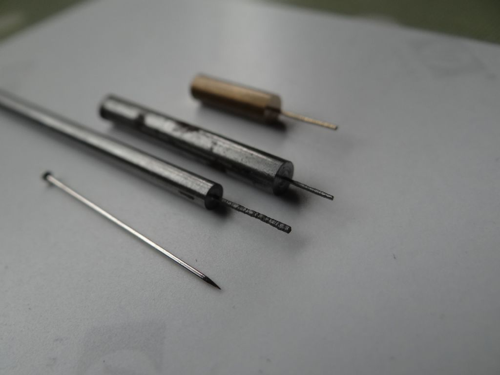

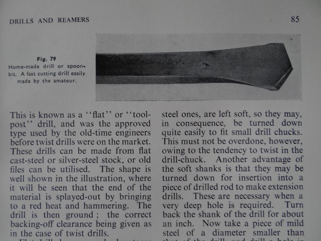

                          #361817
                            Despite assistance I think I'm out of my depth on this one!
                            Made progress cutting thin rods, my technique has improved. The material matters. Not difficult in brass, tricky in mild-steel, awkward in silver-steel. I can turn down to 0.5mm without too much bother, less than that and the rod becomes fragile and breaks easily. Photo has dressmaking pin for scale.
                            I haven't tried a specially sharpened HSS tool yet and hope that will fix the poor finish.
                            So far so good except I now need to drill deep holes through brass with one of those spindly rods. The plan was to make a spade or spoon bit drill as per Sparey:
                            Seems simple enough, and Sparey says "easily made by the amateur". With help from Michael Gilligan (thanks) I was able to make a crude drill on this pattern from 3/32" (2.4mm) steel, and to drill a hole in brass with it. Hard work, about 10% as efficient as a twist drill. No doubt the cutting rate could be improved by more careful grinding but this type of drill needs more force than a twist drill, doesn't clear swarf at all, and I despair of drilling a hole 0.3mm diameter hole 10mm deep with one.
                            More bad news, I struggled to produce a decent drill tip at 2.4mm diameter. My fat fingers and poor eye-sight made heavy weather of the job. Now I've tried it, I've no idea how to scale the process down to 0.3mm. I have to heat the rod without melting it, flatten the end, and then grind a pair of relieved cutting edges without breaking a delicate sliver of metal. I am intimidated!
                            Final blow, I dropped the prototype drill and it's joined my missing Biros in another dimension. Woe is me.
                            Making fine drills in a home workshop must be possible, any ideas?

                                          So far so good except I now need to drill deepThe plan was to make a spade or spoon bit drill as per Sparey:
                                          It's perhaps worth noting that the Bergeon-style drills look like this:
                                          Image adapted from the catalogue of H S Walsh: **LINK**
                                          https://www.hswalsh.com/product/bergeon-1712-pivot-drills-010-015mm-hd11a
                                          Sparey's design is, I think, better suited to larger sizes.

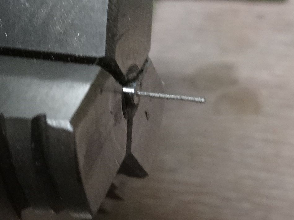

                                                #362031
                                                  Ho hum, commercial twist drills arrived today with mixed results.
                                                  With a gentle touch and many withdrawals to clear swarf I was able to drill a 0.5mm hole 10mm deep with my screw-type tailstock without too much trouble.
                                                  Not managed to drill a deep 0.3mm hole though. Drill started OK then seemed to hit a hard spot in the brass rod. I can't feel if the drill is making progress or not and the first warning of trouble is the drill whipping.
                                                  The drills are tiny and they bend and break easily:
                                                  My lathe has a top speed of about 2500 rpm. Seems this is a little on the slow side – one website recommends 40,000rpm for 0.3mm HSS and 'if available' more than 100,000 rpm for carbide.
                                                  All my home made drills are now broken. Thank goodness I didn't give up my day job!

                                                    I did that one I posted earlier without even shifting to the fast belt so about 1100rpm
                                                    Try holding as much of the drill as possible in your chuck to help prevent whipping, even if it means cutting down the shank and having some of the flutes in the jaws.
