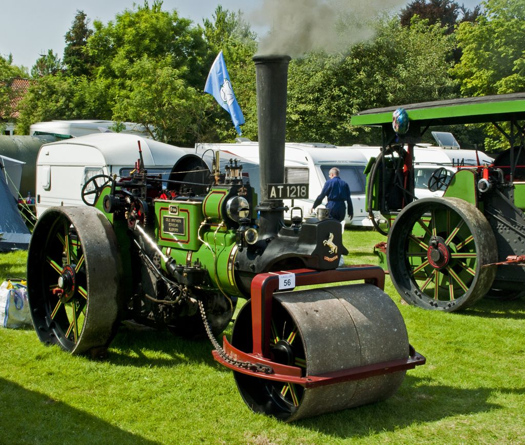

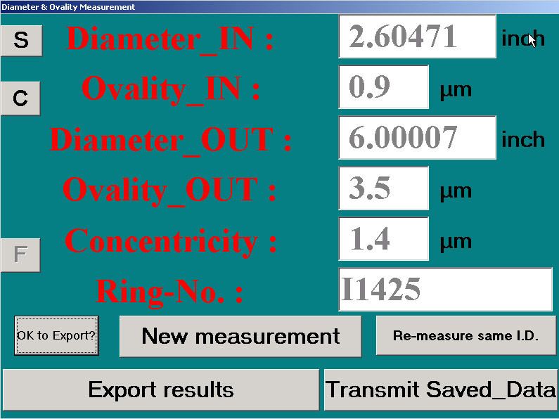

                Posted by Chris Gunn on 06/06/2016 21:16:31:
                I think the key to success is knowing when precision is needed and when it isn't.
                Chris Gunn
                Quite so Chris, The following two pics illustrate this well. The screen shot is of a non contact measuring machine that I used in a Beverage can Toolroom on a daily basis. Note the mix of Imperial and Metric. The other one is of the main interest in my life since I have retired! Horses for courses…
