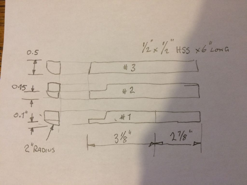

                                          Stephen, before you buy a hole cutter, how will the swarf get past the teeth. With stone and concrete etc, it is a fine dust and slips past the teeth, but in your application, the swarf will be too bulky to get past the gullet of the teeth. You will have to keep backing off the cutter to clear the scarf. Aluminium has a nasty habit of cold welding to the cutting edges, you will need plenty of coolant whilst cutting.
                                          Faced with your problem, I would grind up some special boring bars. I will do a another post with some ideas, perhaps Andrew or Jason would comment as to wether they would work.
                                          BobH

                                            Speedy Builder5
                                              @speedybuilder5
                                              Further to my last post, I would use a series of boring bars, cutting a depth of 1/2" at each stage and then only cutting 3" into the bar from each end – a bit like the channel tunnel !! Thats 36 tool changes for a 6" length and still quite a lot of swarf, but not as much as boring out the whole lot. Again, you will need to use coolant. See attached photo. The cutting edge of the tool needs to be ground back along its long axis by 1/2" and you would trepan a cut 1/2" deep with tool number 1, followed by tool 2 and 3. Then repeat for another 1/2" with tools 1,2 and 3. When you reach the half way mark, turn the bar around and bore from the other end. Note that tool number 1 is the narrowest tool being only 0.1" wide which can be made stronger by having a radius on the inside face of it and should well within the capabilities of your lathe.
