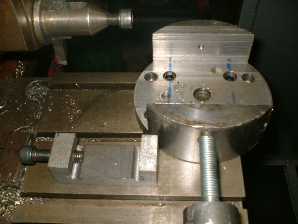

      Oh and only one blade needed, this time it survived no problem
      Eclipse hacksaw blades are fab-u-lous
      The job took 9 days again, about 4 hours a day with minimal intervention on my part
      Edited By Ady1 on 15/07/2015 14:07:24
      #196825
      Ady1
        @ady1
        btw The original hogging out job has been done, now got a 2nd big vice and made a little brother for mounting into the big vice for teeny bits
        Shaping this steel with 5% cobalt was a doddle
        No chance of facing it with 5% cobalt on the lathe though, not even close

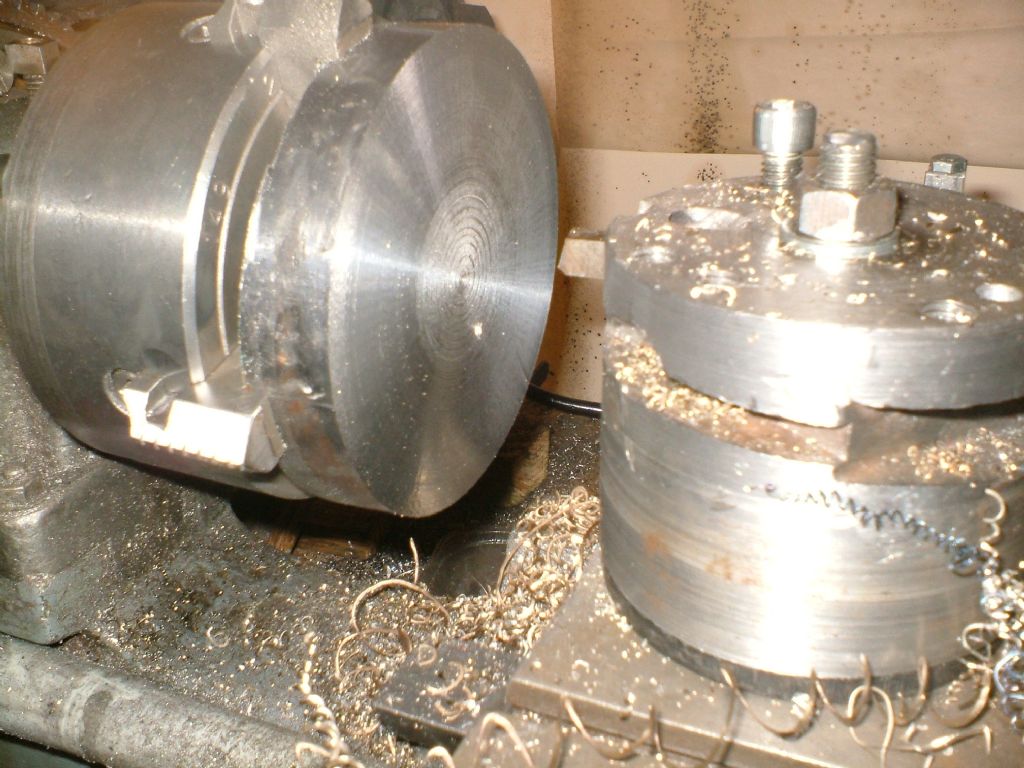

          Cracked it!
          And here we have WKE45 hss cruising through this stuff down to the finishing skim phase, not a piece of carbide in sight and only one pre-job tool sharpening required
          ooh I'm a happy bunny
          Anyone care to guess how I did it? smiley
          Edited By Ady1 on 17/07/2015 16:35:47
          #197183
          mark costello 1
            @markcostello1
            Fed straight into the chuck.
            #292647
            Ady1
              @ady1
              I must have put the answer into another thread, twit
              I put it on the backgear and the tuff HSS did a great job at slow speed, much better than high speed and no chipping issues that you can get with carbide
