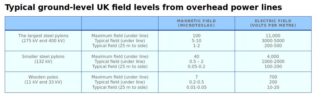

      On Sunday’s I go clay shooting on a local Skeet range that I am a member of, we have a problem that perhaps someone will be able to help us with. The high tower on one range is in close proximity to high voltage overhead cables, approx 20 feet, I am unsure whether they are 11,000 volts or 33,000 volts, not really important as to the value as according to UK Powers charts, found online, detailing their sphere of interference they are both nearly identical in their field strengths. Since we replaced the launcher in the high tower with a new unit which is actuated by a radio remote control from our shooting bases we have suffered problems where it will intermittently not fire on command, the same remote fires the launcher in the low house without problems, the low house is situated on the far side of the range well away from high voltage cables. Prior to replacing the launchers the old units were controlled by a control unit connected physically by a long cable to the launchers, no problems encountered then but it was a real pain having to drag the cable across the range every time we changed shooting positions, the old system was replaced because of mechanical problems with the launchers. The perceived problem we have is that the field (electrical that is) that surrounds these high voltage cables is causing intermittent interruption of the remote signal to the high tower, the one in close proximity to the cables. Is there any way that we can either shield or mitigate the influence of these cables, unfortunately reverting to a physical cable connection instead of the radio remote is not possible. Would placing a metal shield between the aerial wire and the high voltage cables help, I realise the field generated from the cables is all encompassing and according to the charts on the internet can still have a measurable value at up to 40 metres from the cables.

        Robert Atkinson 2
          @robertatkinson2
          Hi,
          The field the chart you refer to is that generated by the 50Hz power. This is not what is causing the interference to the remote control which will operate on a much higher frequency. The interference will be caused either by arcing / corona on the line due to faulty insulation or, less likely, radio signal being transmitted on the lines.
          The answer is to move the antenna (or receiver and antenna) closer further from the lines and closer to the transmitter. How yuo do this deends on the type of antenna. If it plugs into a coaxial connector you just need a coaxial extension cable with male and female connectors to match. If it's just a bit of wire it may be more difficult.
          Moving the antenna 20 ft from he line will reduce the intereference by a factor of four.
          Another option would be to use a directional antenna. A reflector plate behid the existing antenna mightt work but it depends on the frequency and the type of existing antenna. Do you have any information on or psctures of the receiver / antenna?

                Not sure it's a good idea for a tower to be so close to a HV line in the first place, but hey!
                Robert's suggestion that the interference is due to a faulty insulator on the line is a good one. Try listening to an AM radio tuned between stations when standing near the power line. If the AM radio picks up loud nasty hash, there's a good chance it's due to a faulty insulator. You may be able to identify it by walking the line until the radio detects maximum racket. Anyway, if you detect interference from the line on another radio report it to whoever manages the line. As faulty insulators are bad news, they may be pleased to hear about it, especially if you know which one it is!
                Another possibility is that the HV electrostatic field is directly overwhelming your electronics. (I'm told there are enough volts floating about under an HV line to strike a fluorescent tube held in your hand!) In that case the cure is to shield the electronics with an earthed box. It may also be necessary to shield any cabling and the antenna, the last being tricky.

                #374868
                Anonymous
                  There won't be much of an electric field that close to the power lines. Any wire carrying a time varying current radiates an electromagnetic wave. In the far field the ratio of the electric field (V/m) and magnetic field (A/m) is in the ratio of the impedance of free space, 377 ohms. In the near field the relationship is far more complex and very close to the radiator the magnetic field is likely to dominate.
                  The transition between near and far fields is fuzzy but around a third to half a wavelength, which for 50Hz is 6000km. So any interference issues are likely to be magnetic. Adding any ordinary metal plate will be about as useful as a chocolate teapot and less tasty. You'd need a high permeability material like mu-metal, which has it's own issues.
                  As has been suggested try swapping the units. Is there a coil in receiver? It may be picking up enough low frequency radiation to overload the front end amplifier even though the frequency is far removed from that of receiver.
                  I'm assuming you don't want to start delving into the electronics. The suggestion to mount the box at the bottom is a good one. Whatcontrol cables need to run to the top of the tower?

                              Posted by Andrew Johnston on 06/10/2018 20:39:43:
                              There won't be much of an electric field that close to the power lines…
                              Andrew
                              Not so sure of that, here's some numbers:
                              Assuming it's an 11 or 33kV line, the electric field at ground level could be as high as 700V per metre. 200V/m is 'typical', and the field strength is still 10-20V/m 25 metres to one side. The field will be even stronger if the box is only 20 feet away from the wire.
                              I agree about the magnetic component being difficult to shield. Might be easier to move the power line!
