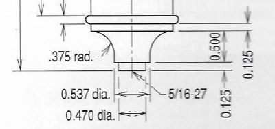

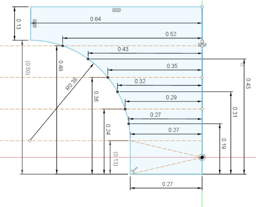

      I need to machine a .375" concave arc in aluminium.
      I consider the radius too large for a form tool because there is not a lot of metal to hold in the chuck, although the small end will be supported by a centre.
      So, I would like to create a table in Excel to give me the cross slide and longitudinal infeeds. The tool width will be 3/32" and the curve will be smoothed afterwards with a file and emery cloth.
      Searching Google, I can only find info on drawing freeform arcs. Can anyone explain how to make the required table, or point me to an online instruction. I don't have any CAD programmes.

              You can work out the X-Y coordinates of the surface from the formula for a circle (X^2 + Y^2 = R^2) where the origin is the centre of the arc.
              It's easiest to work with a round tool (e.g. a pattern following tool or a carbide button).
              Translating the surface coordinates of a concave surface to the centre point of a tool of radius r then boils down to scaling the X & Y coordinates by R/(R+r).
              You can then choose a known reference position and offset the coordinates wrt this to get your cross slide and feed readings. The devil is in the detail in getting the sign conventions correct!

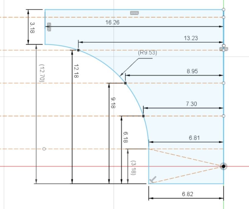

                  Here is a starting point in mm
                  Emgee

                            Dave, same drawing in imperial but to only 2 decimal places, also added 3 more stations to cut to, hope it helps.
                            Emgee

                              Unfortunately, while it's pretty simple trigonometry to work out the coordinates of the curve, those aren't quite the coordinates that you need to machine said curve! Possibly not even good enough (given that this curve swings through near 90deg) for this cosmetic-not-bearing-surface curve. The reason is that in order to position the tool, assuming that you are using a circular button tool, you need the coords of the centre point of the tool. The actual contact point – where the cutting takes place – is a bit more difficult to calculate than just the curve itself as there is an offset of tool position from the curve that depends on the curvature of that curve at a given point. At the largest end of the curve you are using the side of the tool so need to offset along the lathe axis while at the small end this offset is near zero but the infeed offset is now maximum – and these change all the way along.
                              It's unfortunate that the OP is not a CAD user. I reckon the easiest way to get the required list of coordinates is to draw the profile in CAD and use its CAM module to calculate the path. I guess you could do this by generating the lathe tool path needed although not having any experience of doing that, I would pretend that the profile is going to be machined on a mill, specify a tool of the diameter of my lathe tool button, and generate the gcode accordingly. It's then easy enough to edit out the XY coordinates from the gcode and put that into a spreadsheet – or just print as text. I'm sure I could do the work needed to come up with a formula for the correct tool path manually but it's very much a case of letting the software and the PC take the strain, and a whole lot less error-prone!
                              For doubters, I (and plenty of others) have taken this path to get "manual numerical control" coordinates before; I use the technique to machine loco wheel flanges because I'm a whole lot better with CAD/CAM than I am grinding a form tool… A DRO on the lathe helps a lot as well.

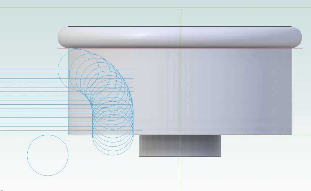

                                Posted by Nealeb on 21/03/2022 16:58:58:
                                With a circular arc and a circular tool, the XY coordinates of the tool centre point wrt the arc centre point are honestly just the XY coordinates of the arc multiplied or divided* by [arc radius] / ([Tool radius] + [arc radius])
                                The proof / derivation is via similar triangles. These coordinates (relative to the arc centre) then need to be translated into X,Y (or X,Z) tool movements relative to a datum position.

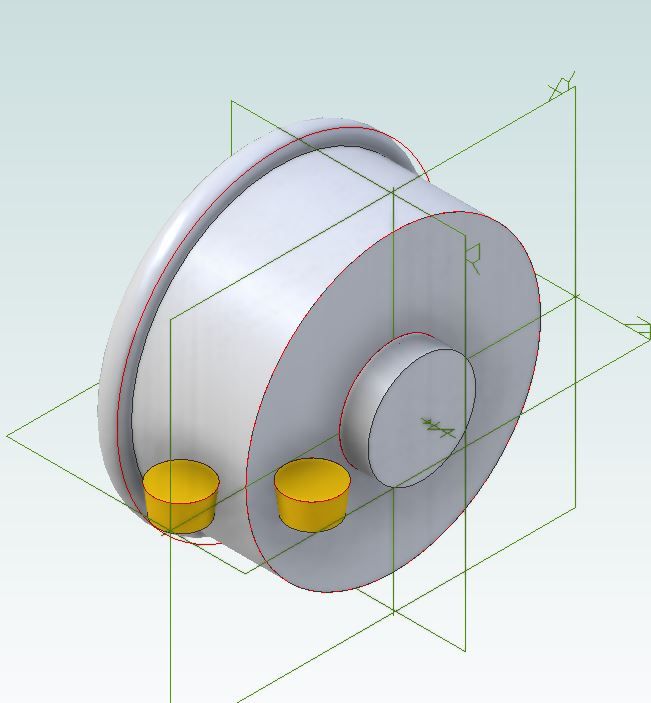

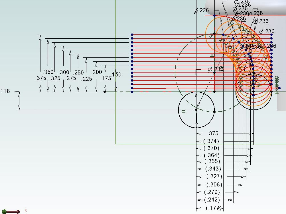

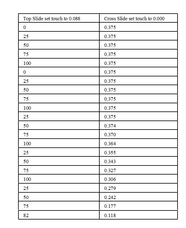

                                      In practical use on a manual machine it's often easier to use the side of the tool as the ref that way you simply touch the tool and set your handwheel or DRO.
                                      So for Dave'd job he needs to generate the curved surface with a series of cuts from his button tool. I do hope it's a RCMT06 or RCGT06 as that's what I have worked it out for.
                                      First turn your stock so it looks like this and then mount up your button tool. With topslide set parallel to lathe axis touch against the diameter and set your cross slide handwheel or DRO to zero. Then touch the side of the tool against the face and set handwheel to 0.088. EDIT 0.082
                                      Then wind in the topslide to 0.000 and feed tool in 0.375. Topslide to 0.025 and feed in to 0.375. etc After a while the cross slide feed in will start to reduce but just keep winding in the topslide in 25thou increments as per table. The last cut will be with the dial reading 0.082
                                      This is what it takes to get the dims in the table, did someone mention cluttered drawingswink
                                      Edited By JasonB on 22/03/2022 07:11:20

                                            Dave, as no one spotted it I've just altered an error in my post
                                            Topslide should be set to 0.082 not 0.088

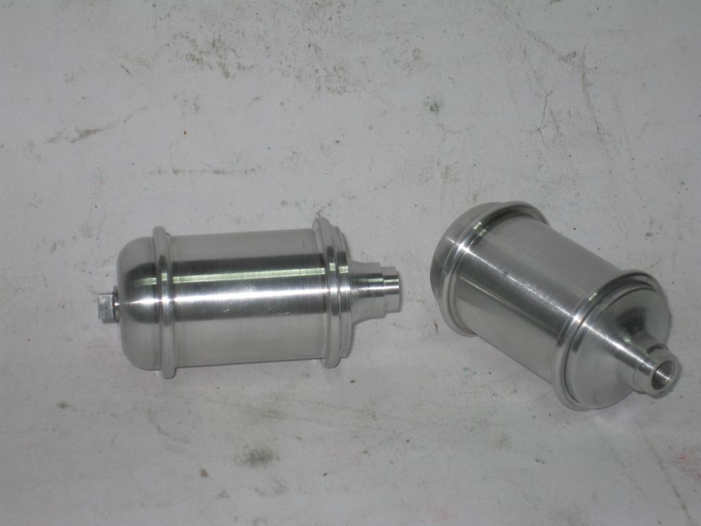

                                              At long last, I have machined the .375" concave radius in the parts that I was making.
                                              Thanks to all the suggestions and help offered.
