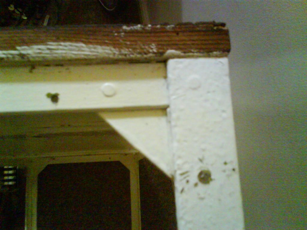

      Having just received my ML7 and got it upstairs (nothing ruptured) the next problem is how to get its custom made stand up an angled Victorian staircase.
      I thought it would be be simple, but nooooo, it wont fit and is extremely well made and very rigid.

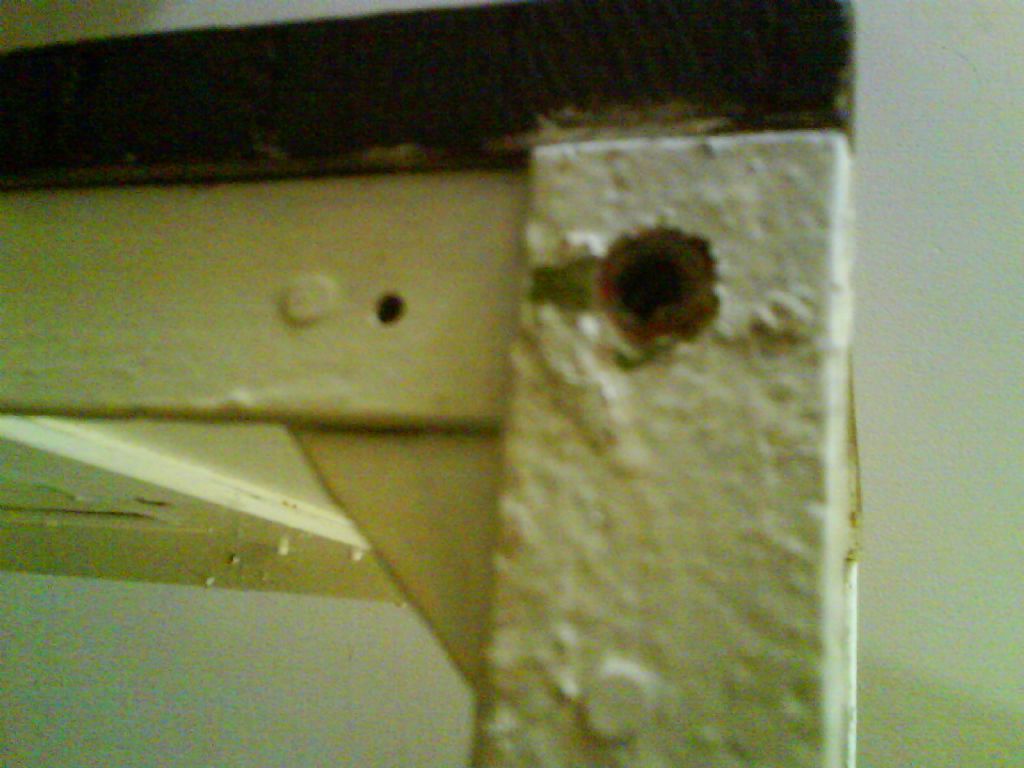

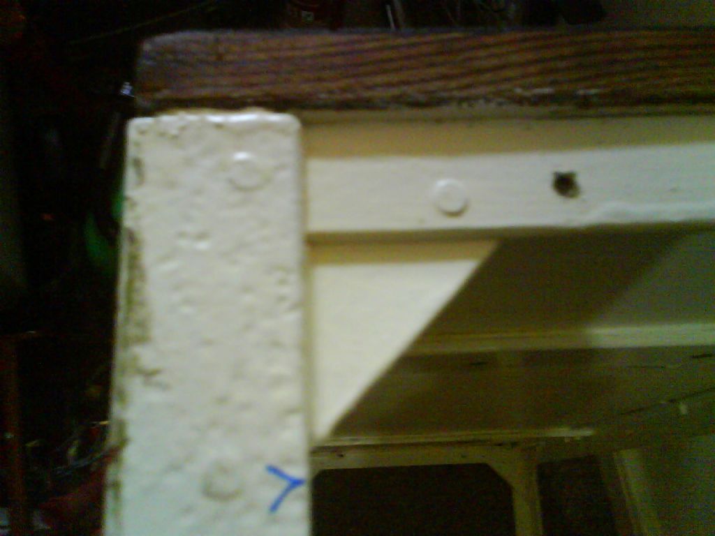

      Having removed the bolts to remove the top I found what looks like solid rivets under all the paint.
      Rivet join
      Another shot
      Bolt hole
      I reckon if I can get the top off I get get it 'around' the stairs and then re-attach upstairs.
      I don't want to ruin it, so what should I do? Feebly attempt to knock them out? Drill?

          Grind off the heads and remove with a punch of the right size.

              Bob thats what I was thinking, If theres sash windows, its a matter of miniutes to take the window out, I'v done that myself in the past when my brother in law could'nt ge a large bit of funiture into his house. If thats not possible, I'd knock out the rivits, and on reassembly use tight fitting bolts (then you'll be able to disassemble it to get it back down stairs). Ian S C

                      Not possesing a 5mm punch I have one on order, just in case I go that route. I will post victory pics when done. Or just move house (planning that anyway) to somewhere with a proper workshop away from noisy roads.

                        I used to live in a similar house. I would only remove enough of the rivets to let you fold the legs under the base. it will then go up easily.

                          looking at your pic angle grind the 2 rivets either side legs then should then fold up no need to go to the hastle of windows. but before doing this take outside strip all of the old sloshed on paint and redo with a hamerite type paint you will not regret it as will look good. I am sure that you will want fellow engineers plus SWMBO to have a look at your workshop. use bolts when item is upstairs to re-assemble. whatever way good luck and enjoy. I have for over 50 yrs.
