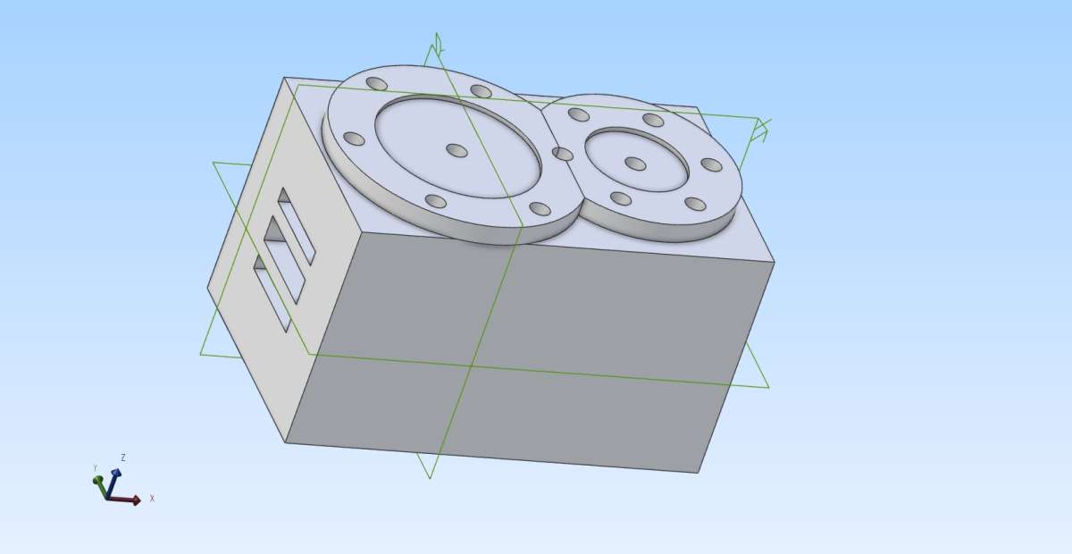

                Nigel Graham 2
                  @nigelgraham2
                  Thank you Chaps.

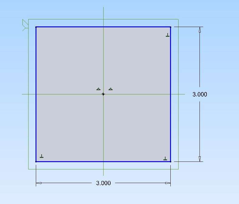

                  Not sure if this will work, but I’ll try putting the image below….. Oh! It did!

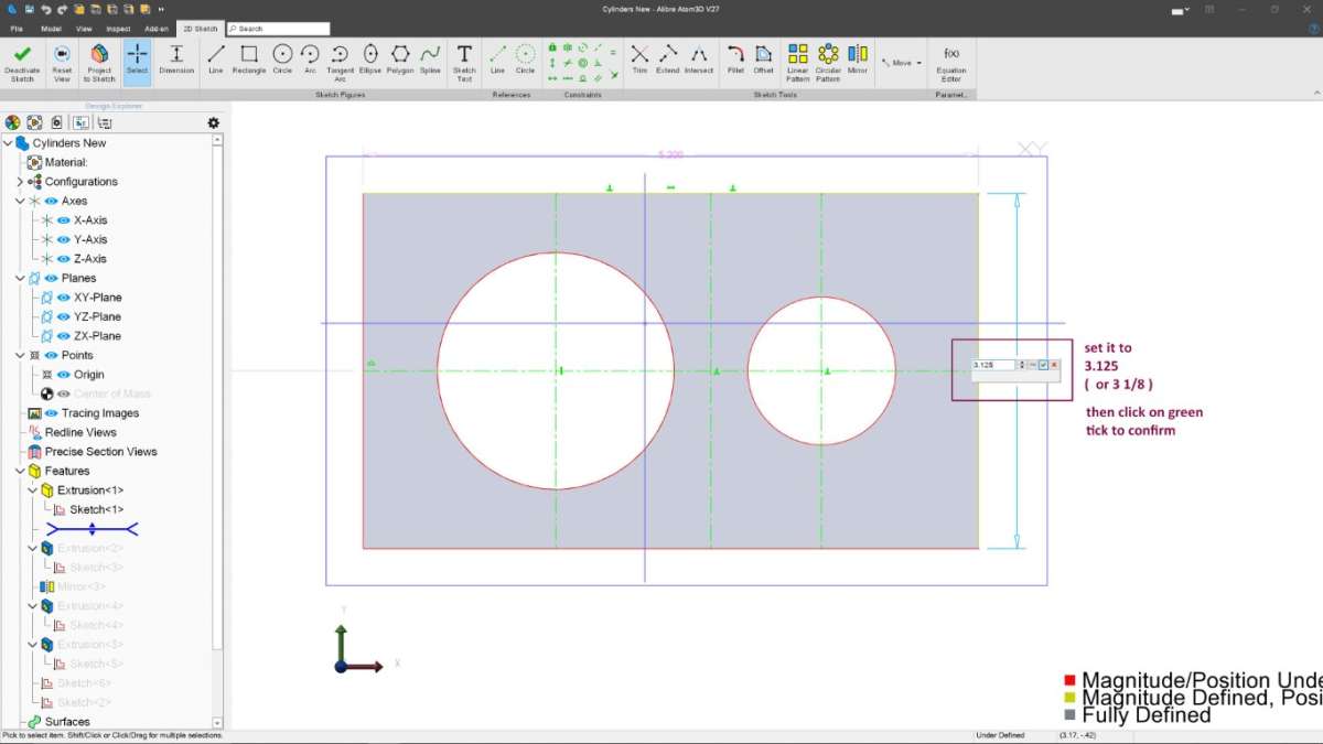

                  I “made” this cylinder block 3 inches square in section but when I designed the covers (using TurboCAD in 2D mode for the geometrical construction) realised they need be a bit over 3″ dia for the geometry to work, and to avoid the nuts overhanging the rims.
                  So I need increase the block’s width; only by 1/8″.
                  I modelled the block from a rectangle and circles, so the dimension to be changed is the width of the originating rectangle before extruding it.
                  Cyl Assy
                  #686066

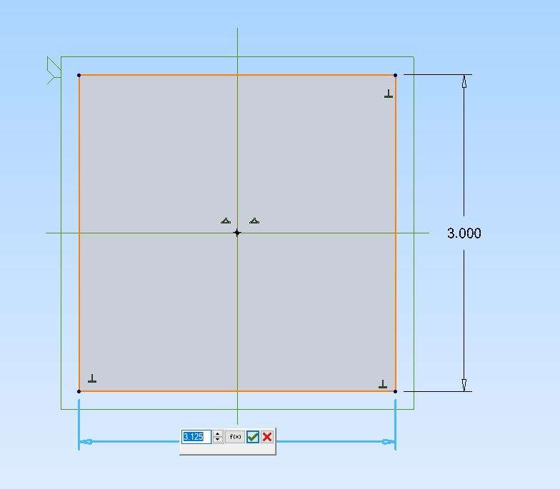

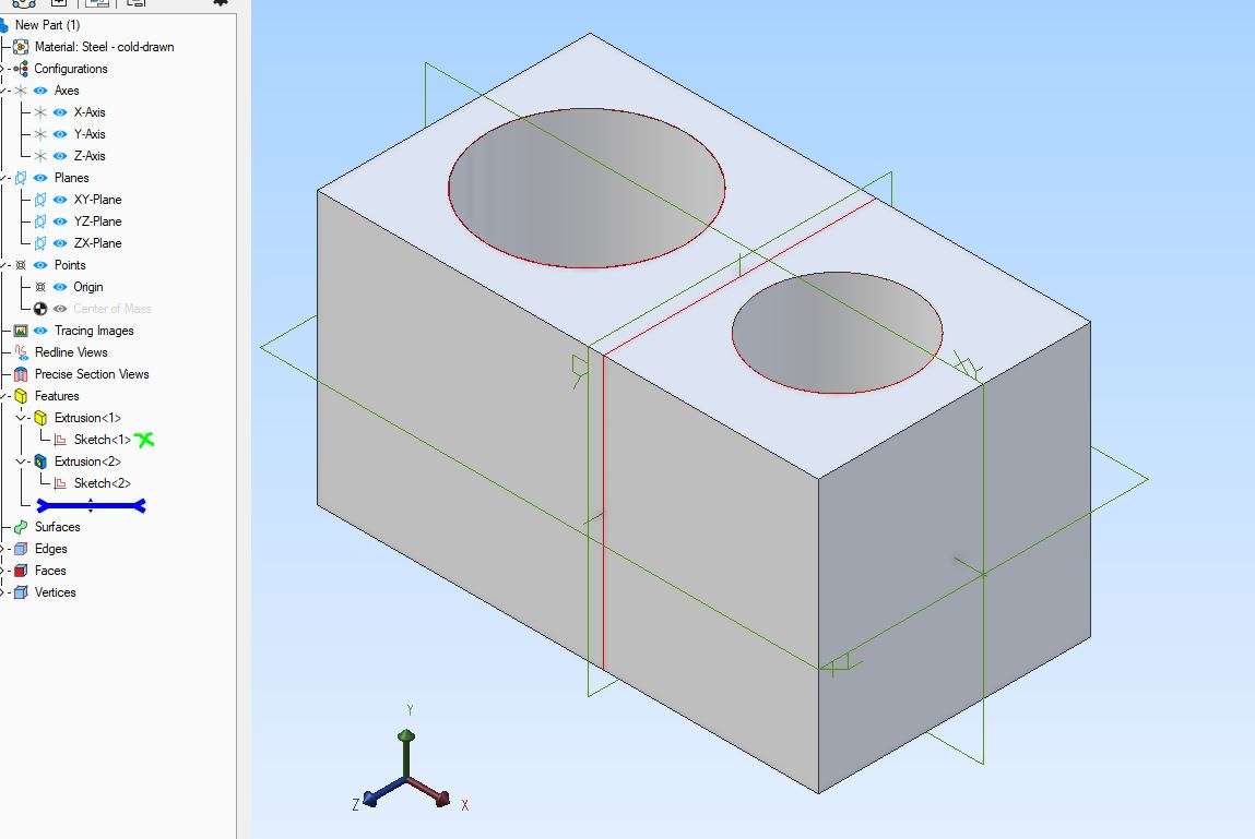

                    First off I would suggest you click the icon to make sketches show as faint red lines which will make it easier for you and anyone helping to see how you have gone about modeling the part. Atom should have something similar to the one I have ringed in Pro, Probably towards top right.
                    Ref display

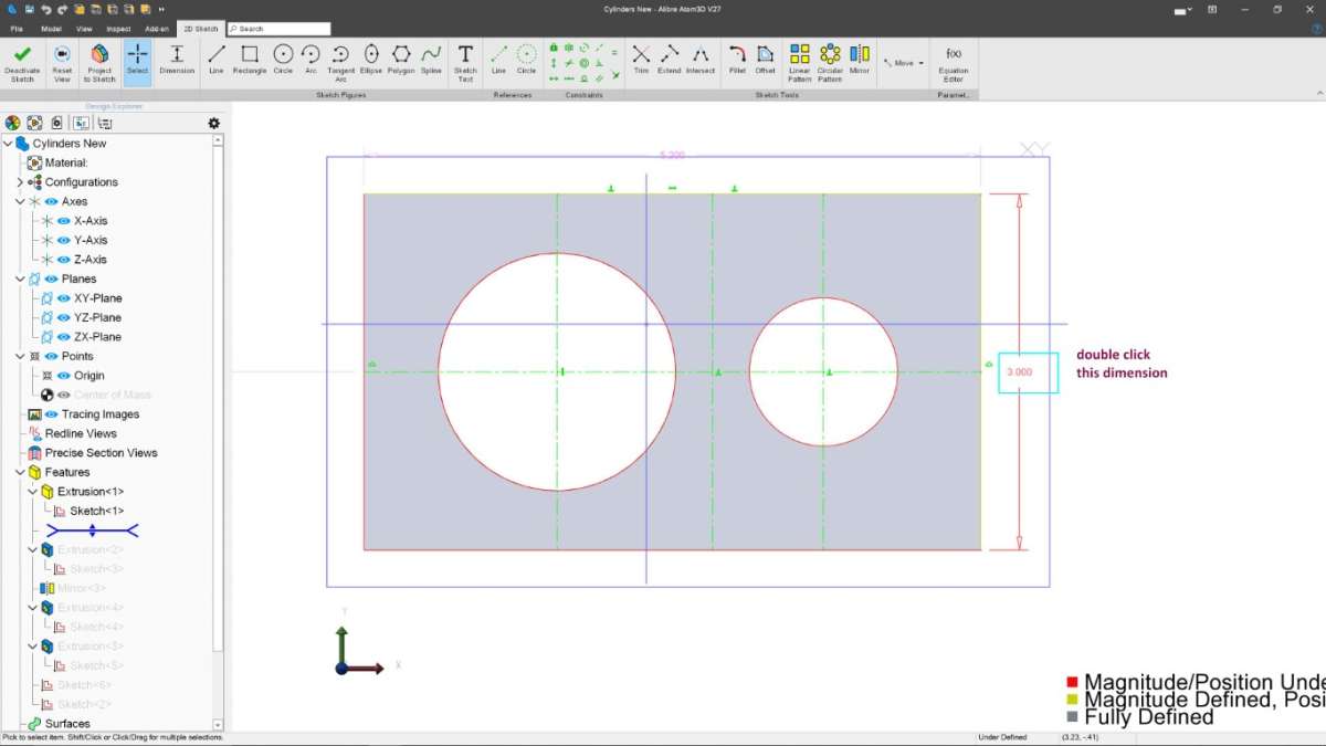

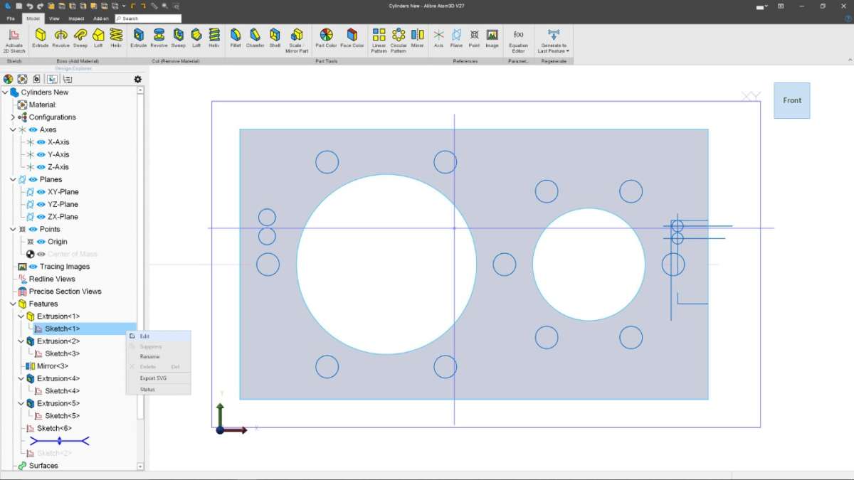

                    You could then simply right click on the red rectangle that was used to create the 3″ square and select edit. However if you look down the tree on the left of the page you will find one of the early sketches will be the one you used, again right click and select edit
                    n1
                    This will bring up the sketch with all the dimensions you entered when constructing it
                    n2
                    double click the lower 3″ and then simply type 3.125 into the now highlighted box and hit return or click the green tick
                    N3

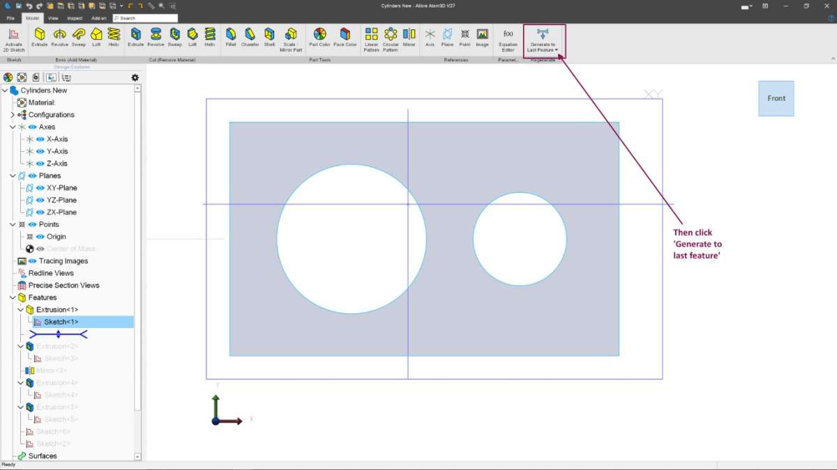

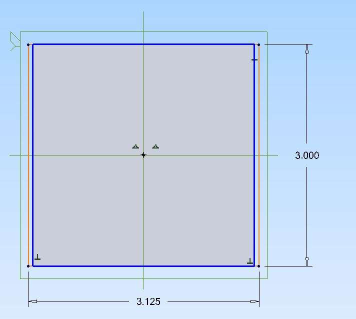

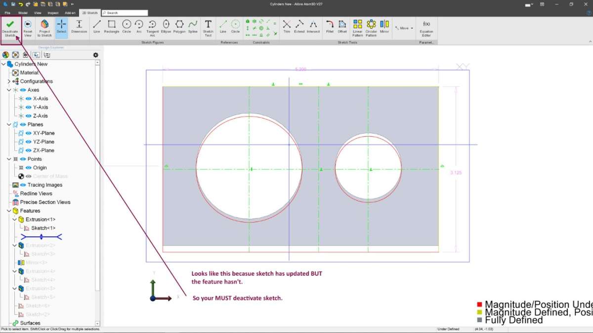

                    You will then see the line of the sketch has become wider than the grey original part.
                    n4
                    Click deactivate sketch top left and then Generate to last top right and you will now have a wider cylinder block.
                    If you did not originally make the 3″ square symmetrical about the mid plane you can do that just after entering the 3.125″ by either using the symmetrical constraint or adding a dimension from the ctr line to one edge of 3.125/2

                      Did you look at the part of the video that I suggested?  It explains exactly how to modify sketch dimensions and extrusion depths.
                      If you really just have to alter the width of the rectangular profile sketch, just edit the relevant dimension that control the width of the sketch.

                        Yes, I did study the video, thank you, but I could not make it work properly.
                        It seemed to keep the cylinders on the centre-line of the expanded block (only 1/8″ wider) but leave the pattern of stud-holes where they were. I don’t know if it similarly put the ports off-centre. I didn’t look.
                        I could test the centre-line to edge distance by dimensioning but I don’t know how to dimension the locations of small circles like those, in a sketch.
                        Daft thing is that it’s only the two low-pressure covers that are affected. I’d taken hours to construct their geometry, finding they need be a bit over 3″ dia. then forgot that when I drew the block. I cannot predict what the overhangs will do at the crank end where the block is screwed to the enclosed vertical engine’s case. On top, as in this image, they don’t matter mechanically but look horrible.
                        I closed the drawing without saving its editing.
                        If the worst comes to the worst I’ll have to redraw it from new, but that takes hours, I think it took at least two for the ports alone. I’d have to add internal details like the passages, manually, on a print, anyway.

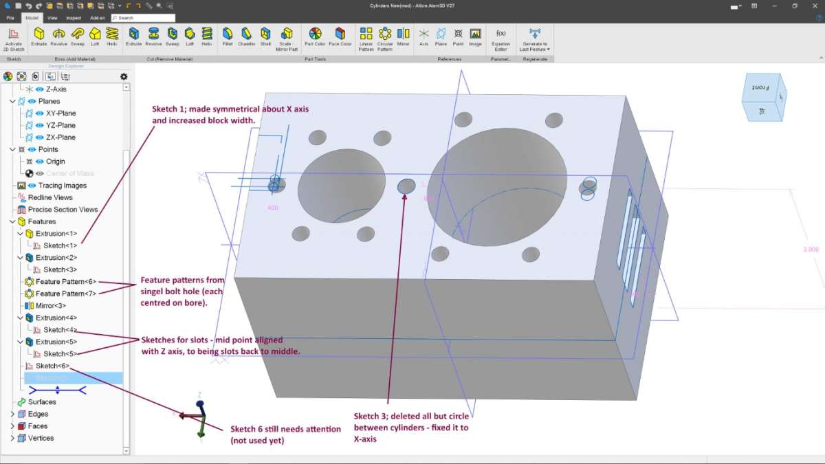

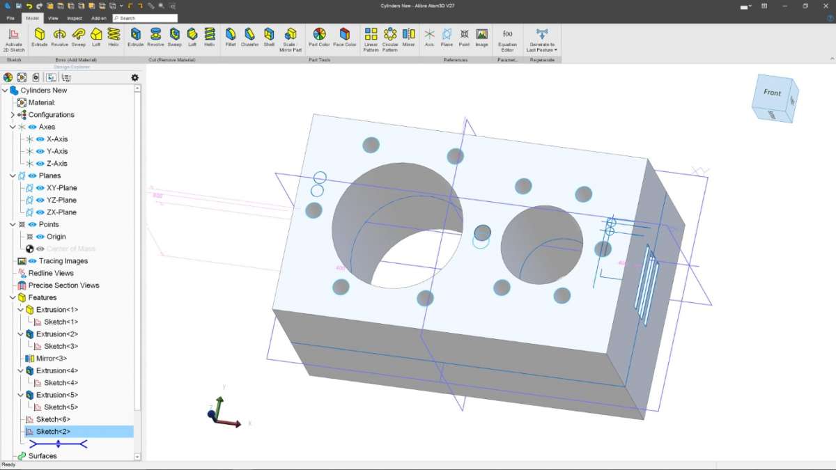

                                        I suspect Nigel panicked when seeing the initial effect of editing the 3″ dimension – so didn’t proceed any further.  If he had done so all would have been well.
                                        Remember that as long as you don’t save the file, you haven’t destroyed what was there before editing.  The images herewith show the process and result.

                                          It may be the viewing angle, but it looks as if the cover stud holes are no longer concentric to the bores and so may also need some further investigation.
                                          #686420
                                          David Jupp
                                            @davidjupp51506
                                            Nick – looking more closely you are correct.  The circles for the bolt holes were not fixed in any way at all,  they may have been projected form the cover (which I don’t have).  The PCD size isn’t any obvious fractional inch value.  EDIT ,  ah no, just patterned from the mid line bolt hole.
                                            #686424
                                            David Jupp
                                              @davidjupp51506
                                              I fixed things and did some simplification (to my mind) in the process.
                                              Re-size Extra (Medium)
                                              I’ll send the file to Nigel.
