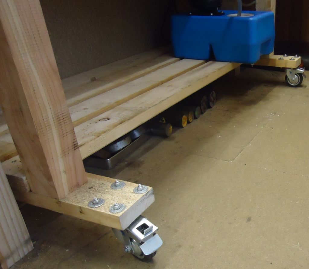

        I am 6ft tall and find that the most comfortable height for all my benches (including the lathe bench) is 36". This puts the lathe spindle centre (Warco WM 250 VF) 48" high approx. from ground level. Like some of you I also have spinal issues but at these heights I do not have to stoop when working – blessed relief!
        Also, the lathe bench is now mobile so I can move it and the lathe away from the wall. Top heavy? Well a little maybe but with care and a little more stability thanks to the front castors in the "outrider" mode it has already paid of as the rear fuse had to be replaced recently.
        I did wonder if those sticky out front castors might cause trip problems but I quickly got used to them protruding and so far have not found them to be a hazard.
        Rik
