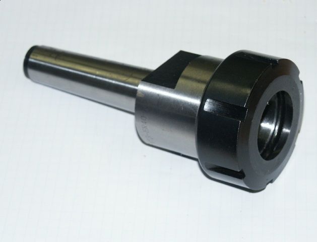

        I have made myself a collet chuck to fit the spindle on my Flexispeed lathe, but it has more run-out than I had anticipated: I am not sure whether I am expecting too much or whether my figures are typical. Measuring the shaft of a slot drill held in the collet, I get a 4 thou total run out.
        I made the tool by threading a piece of brass and cutting a register to fit the spindle. I then span this piece onto the spindle and bored it out to fit the collet chuck. I then pressed the collet chuck into the bored-out hole. I have used the very end piece of one of these er40-mt3.jpg,
        cutting it off just below the widest part to minimise overhang.
        As a precaution, I checked the runout on the register on the spindle and it is a near to zero as makes no difference, the needle just flickering as I rotated the spindle.
        So I suppose the question is: am I expecting too much or does the accuracy of my work need to improve? I suspect the latter.
        I would appreciate any suggestions.

          Hi James,
          I have an ER-32 chuck very similar the the one in your photo, when I put it in the MT3 spindle in my Compact 8 lathe and a ground tool in a collet I get a TIR of around 0.01mm close to the chuck. Since the MT3 based collet chuck will not accept long work pieces I made an ER-32 collet chuck, on this homemade chuck the TIR was twice of what I got on the purchased chuck. (Too many thumbs I guess)
          Thor

            Thank you, Thor. I looked at the specifications for the collet chuck that I bought, but it did not give the runout. However, I doubt that it differs much from your example.
            I have wondered whether some of the runout has been cuased by me pressing the chuck into the piece of brass, resulting in it being slightly squint. I am tempted to try making another version, this time in aluminium. That way, I can make the hole for the collet chuck slightly smaller than it needs to be. I can then but heat it gently to expand the aluminium. As it cools, I hope that it will grip the collet squarely.
            Failing that, I shall try something like the example that you have made, although not having turned a known taper before, I can envisage even more inaccuracies at the end of the exercise.

              James if you have pressed the main body of the chuck into your block then that is quite unlikely to be concentric to the ER taper as there is no need for it to be when the chuck is held by its oroginal taper.
              #241533
                One idea might be to skim the body using a carbide tool while it's mounted by its taper to get a concentric surface.
                #241534

                  That is a good point that I had not considered. The collet chuck that I used actually had a straight shaft, not a tapered one, but your point remains valid. Oh, well, start again, this time with a fresh collet chuck and using a short length of the main shaft, not the top end.
                  Regards,

                    After cleaning out some swarf that had made its way into the threads and by tightening the collet closer more fully, I have managed to reduce the runout to 1.7 thou (0.045mm), but it is still excessive.
                    #241577
                      James, if you do start agian then check the chuck runout before you take a saw to it, at least you will know if it's you or the chuck that is to blame if it comes out worse.

                        James,
                        Have you checked the mouth of the chuck for runout with no collet in, before resorting to making another.
                        Did you check the OD of the chuck to be concentric to the taper bore, before making your carrier body?
                        Also check the nut for radial play on the threads of the body.
                        I've read elsewhere that others have gained better accuracy, by tapping the nut after tightening the collet onto whatever is gripped, similar to tapping true a chuck on an undersized register.
                        Bernard.

                          I can't help wondering why you would want to use a milling chuck on a Lathe when ER32 Lathe chucks are available. Unlike a milling chuck stock can be passed through the headstock.
                          **LINK**

                            If you want to get good runout you need to machine the taper after fitting the chuck to the spindle nose. It's not that difficult. I made one for my Atlas lathe over ten years ago and the runout is less that 1/2 thou. It was much easier than chopping up a milling chuck and trying to get it to run true.
                            Have a look on Harold Hall's site: **LINK**

                              Thank you for all of the replies. In response to a few questions raised:
                              Yes: it is the same as with a collet installed.
                              No: I asumed that it would be accurate (possibly a mistake to do so).
                              The threads are tight.
                              To be honest, I had not heard of these. However, those that I can find so far are all too large for my lathe to take comfortably.
                              A good idea that I shall try.
                              This is what I shall try next: truing the taper to suit the machine.
                              Thank you for the link to the Harrold Hall site as well. I am tempted to try making a body from scratch, but I shall need to think about the closer thread. My lathe does not do screw-cutting and I am not sure whether a die-cut thread would be accurate enough.
                              Regards,
                              James.

                                I have finally been able to get back out onto the lathe to have another play with this piece. I have used a small Dremel style grind stone in the cross-slide to try and true the inside taper. I have now managed to get the runout down to 0.01" when measured on the inside of the taper. Measuring the outside of a mill, held in the collet, there is a 0.03" runout.
                                I shall carry on trying to true it further, but I think that I am unlikely to get it much truer.

                                  Well, I have given up on this plan. I have managed to get the taper inside of the chuck to run true to within about .005" / 0.0127mm, but the runout on the shank of a slot drill is still excessively large.
                                  I have looked into lathe collet chucks, as suggested by VIc, and propose to buy one of these from ArcEuro.
                                  Am I right in thinking that I "just" need to turn up a back plate with a suitably sized register and then bolt the two together?
