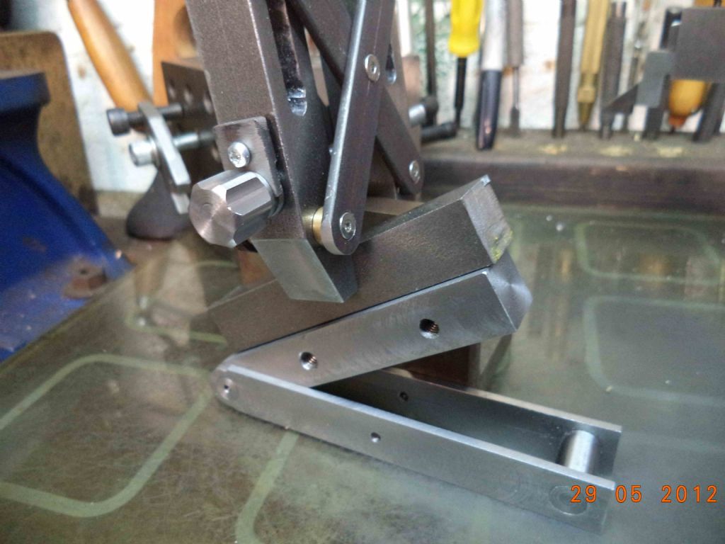

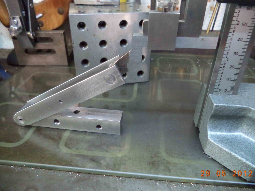

                        I made a 2 inch sine bar a while ago and it was published in the No 280 MEW magazine with drawings etc. I use it for setting the top slide of my lathe, against an angle plate for plates with an angle and in the vice for round and square pieces. A sine table I have made in the past but when at work on huge machines the last one was about a meter square and about half a meter tall. You need a large machine to use a sine table.

                          Yes I made a 100mm one this makes the calculation easy my version is different in that it has a swivel base, this also makes it easy to set up. I submitted an article to ME workshop but as yet its not been published if any one would like a set of drawings just PM me.
