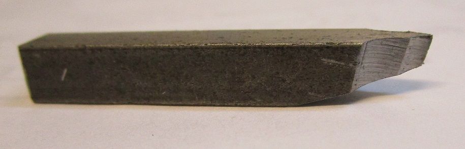

                              I made the little cutter in the foreground about a year ago from 8mm silver steel, to cut a recess for a breeching-rope ring in the cascabel of the carronade.
                              I heated it up with an ordinary butane blowlamp, carrot-red as near as I can describe it, quenched in plain water, stoned the face bright and then heated the stem until the face began to go straw-coloured – again as near as I could get it – then let it cool in air.
                              It cut some nice mild steel like it was cheese. Looking at the picture now, I think I should've cut closer to the step in the cascabel so as to blend the ring in better. Maybe during the current house-arrest I'll find some time to do that.

                                Posted by Mick B1 on 22/03/2020 14:10:14:
                                Having just looked up what cascabel and carronade mean I can say it looks fine to me.
