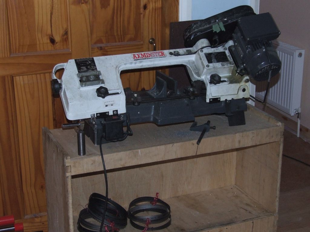

                  Following a trek up the A14 this morning I am now the proud owner of a new (to me) 6×4 bandsaw, plus a number of spare blades:
                  Naturally I've tried it out, on 1¼" diameter EN3B. Went through with a nice clean cut more than an order of magnitude faster than the old donkey saw. I'm beginning to think the donkey saw was more of an ass. So far I'm a happy bunny.

                  #305237
                  Mark Rand
                    @markrand96270
                    Conversely I (at the other end of Andrew's trip) have now got some floor that I haven't seen for several years. Eat your heart out Sir John Stevensonsmiley.
                    I hope the bandsaw serves you as well as it did me.
                    As for the A14/M6/M1 junction. It works perfectly for the A14/M6 bit, but they seriously cheaped out connecting the M6 to the M1 Northbound and the M1 Southbound to the M6. Maybe in another 30 years there'll be another amendment and they'll get it right.

                      Anonymous
                        Thanks Mark, I'm very pleased with the bandsaw. On the showing so far it's way better than my old Taiwanese donkey saw.
